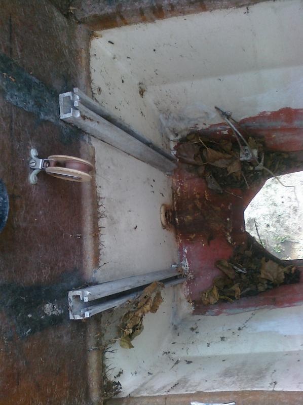

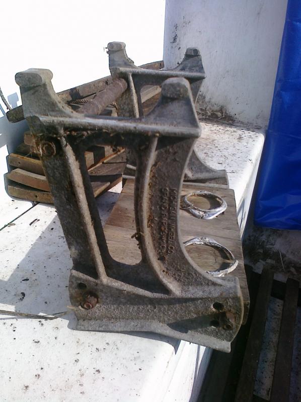

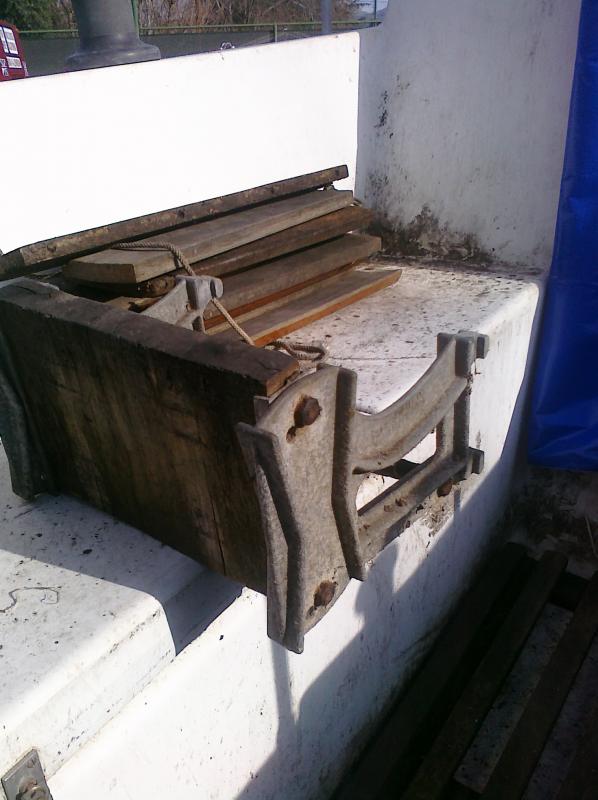

My boat is outboard powered and the engine lives in a well full time
Takes a wrench and about 30 minutes to get it out, so it stays in the water always. Used to take two people, but I built a harness and can now hoist it using the main sheet, by myself. But still---
