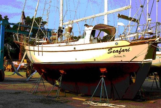

Yes, it's a Westsail (first post) and no- no shore power. Diesel heaters. She said she appreciates the ideas
