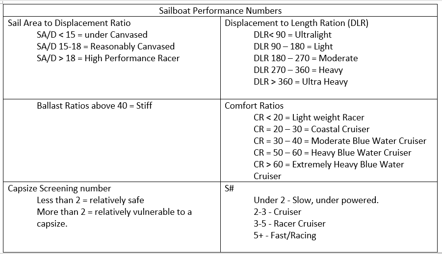

So I've been spending my quarantined time diving down various rabbit holes and today's obsession is sailboat performance numbers. A while back I created this cheat sheet for my own use...Most of these numbers I got from the "definitions" link on Sailboatdata.com
I am not sure how useful the S# is. On many of the cruising boats I've looked over, the S# is below 2... but many of the cruising boats have very respectable Sail Area/Displacement numbers. Also, very few boats have an S# much above 2.
Is this rating system biased towards racing and I should rethink how to interpret the S#? Do you have to be a serious racer to even worry about S#'s

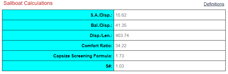

For example, here is the cape dory 33
The S.A./Disp says it it is reasonably canvased but the S# would have me believing this thing is a turtle.

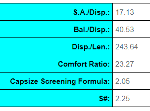

Here is the Ericson 33
By sailboatdata.com's rankings we are now getting into the "cruising" class boat which are (in my mind) on the slower side of respectable performance. If you keep digging you see that S.A./Disp and S# do not always track ... for example...

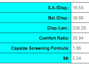

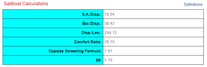

Here is Endeavor 33
Here is Hunter 33 with almost the same S# but 0.62 lower S.A./Disp.

This has the potential to be a good thread. Unfortunately, I'm not familiar with the S# (But I'll read up on it). But your reading of the Cape Doggie is correct. The SA/displacement of only 15.62 is low. And that whopping displace to length ratio of 403 denotes obesity. So under canvassed, wide and heavy - not fast. It's a great cruising boat however. Water tanks, fuel tanks, stowage galore.

SA/D is pretty good but you are off with your classifications. Really, anything under 16 is under canvassed. 16-20 is reasonable. Race boats are way higher than 20. For example, my C&C 110, which no one would call a true race boat, has an SA/D of 23.

Your definition of SA/D > 18 being a high performance racer is a little optimistic. I'd push that to 21 or maybe even higher. Even the Island Packet 40 has an SA/D of 18 - The Viper SA/D is 44 :yikes:

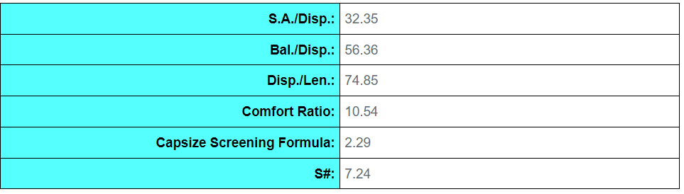

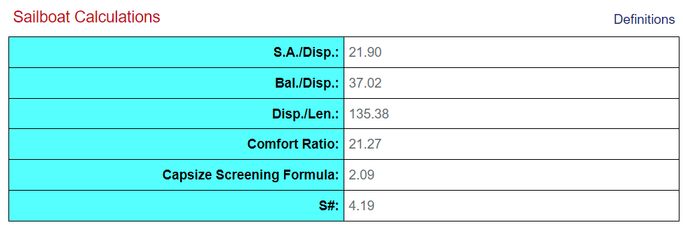

You can get high S#'s in production cruisers. C425 has S# = 4.19
I have raced on a J90 which is full-on racer listed with a S# = 7.24 and SA/Disp = 32.35 but it was highly modified incluiding a new 5' taller rig so the SA/Disp ware really about 46. :kick:Lots of fun!
