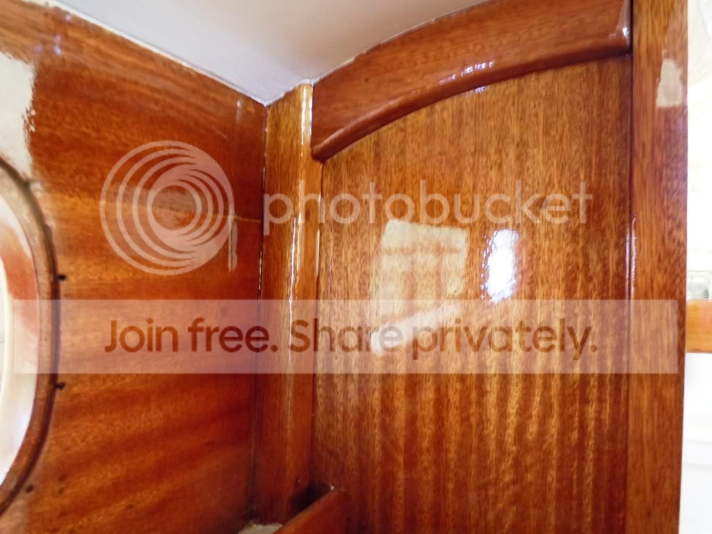

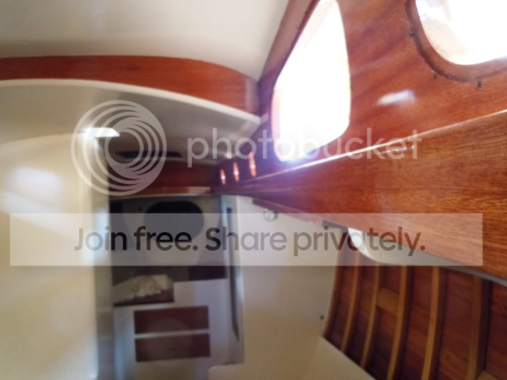

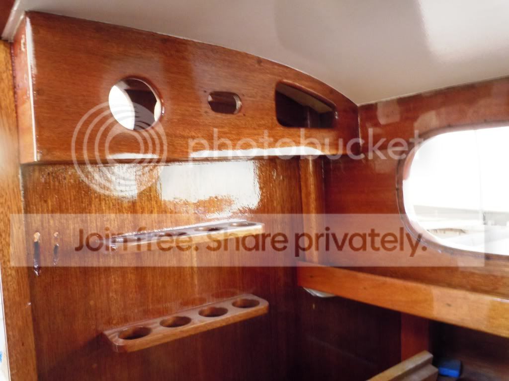

Here's a long delayed follow-up on Lady J. The interior paint is done but we have some assembly of various parts and the cabin sole to finish.
Here are some interior shots:
Starboard forward
Port forward
Starboard aft
Port aft
V-Berth
Head

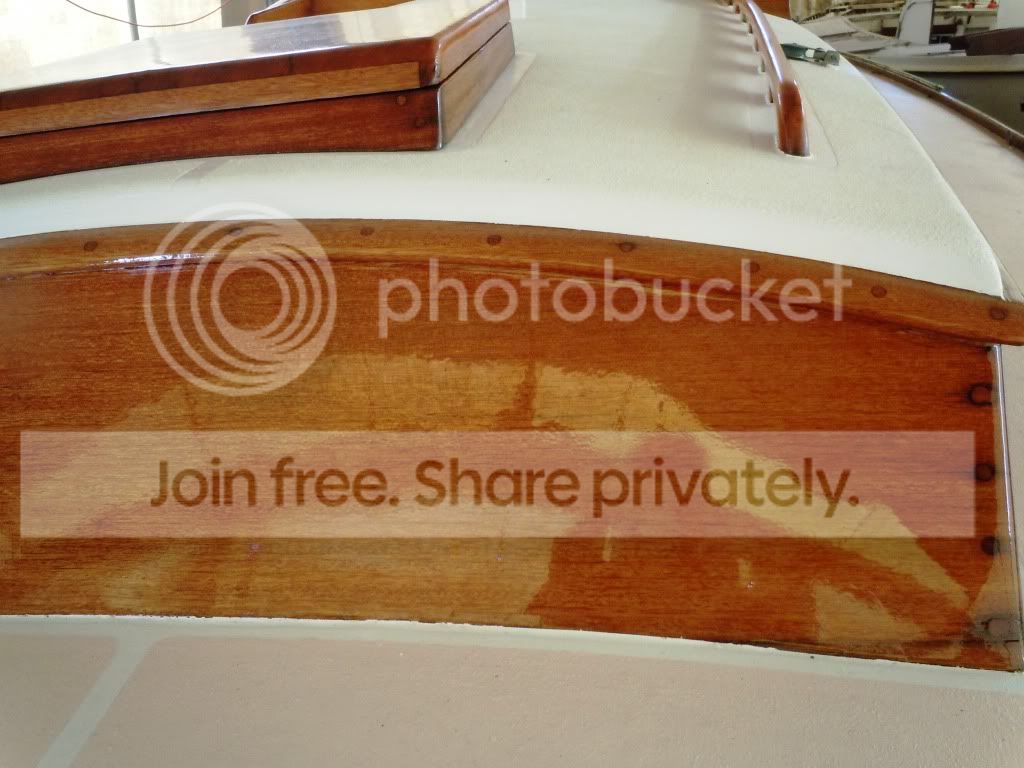

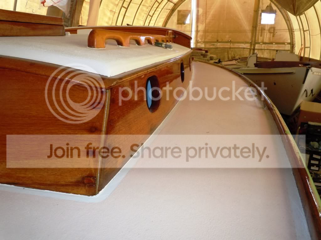

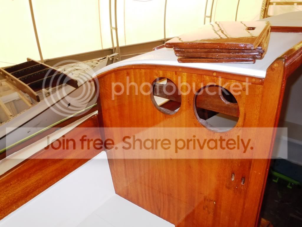

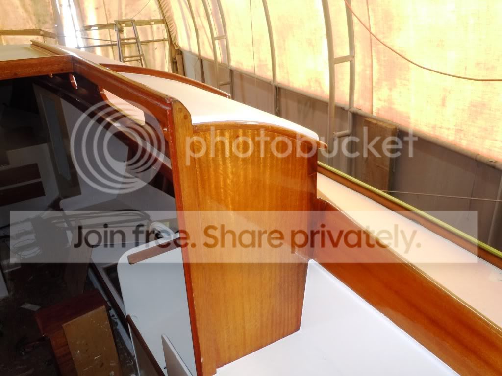

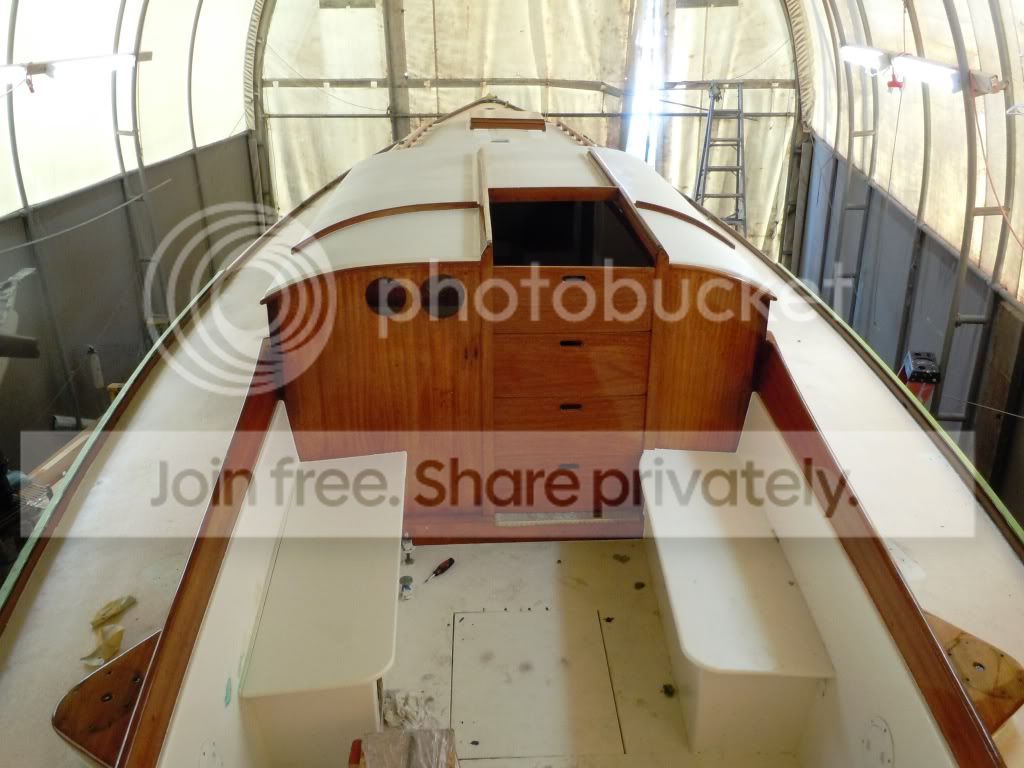

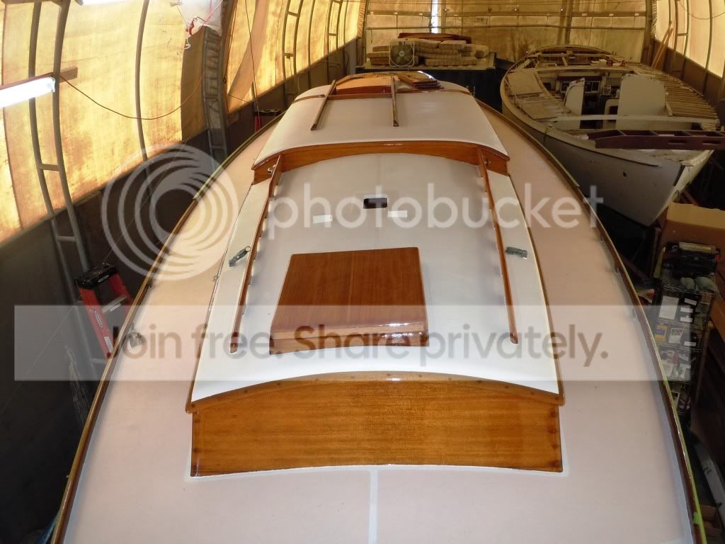

Of course, we've been busy topside as well. The boat is filthy at the moment.
Looking forward
Looking aft to Port
Cabin trunk face
Fore hatch
Looking aft
Cockpit coaming
Aft cabin port
Aft cabin starboard
Cockpit forward

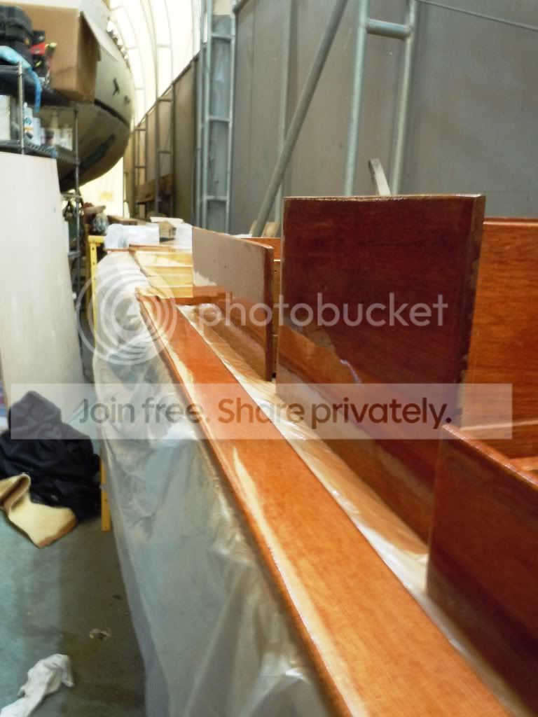

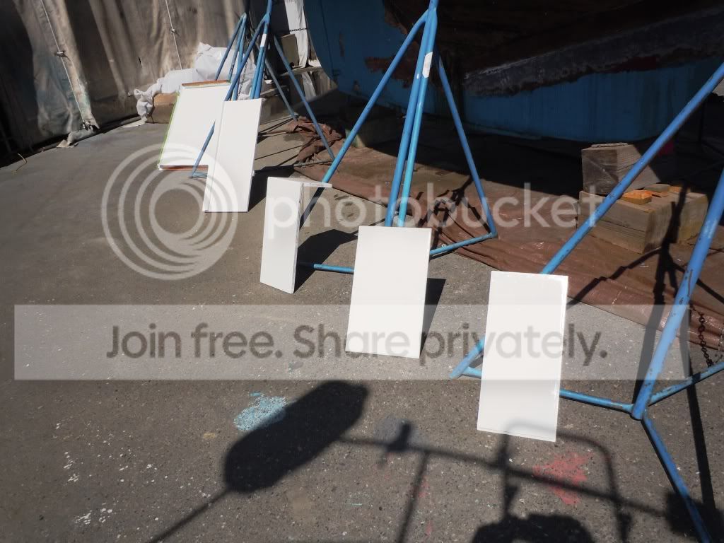

More parts awaiting installation.
and

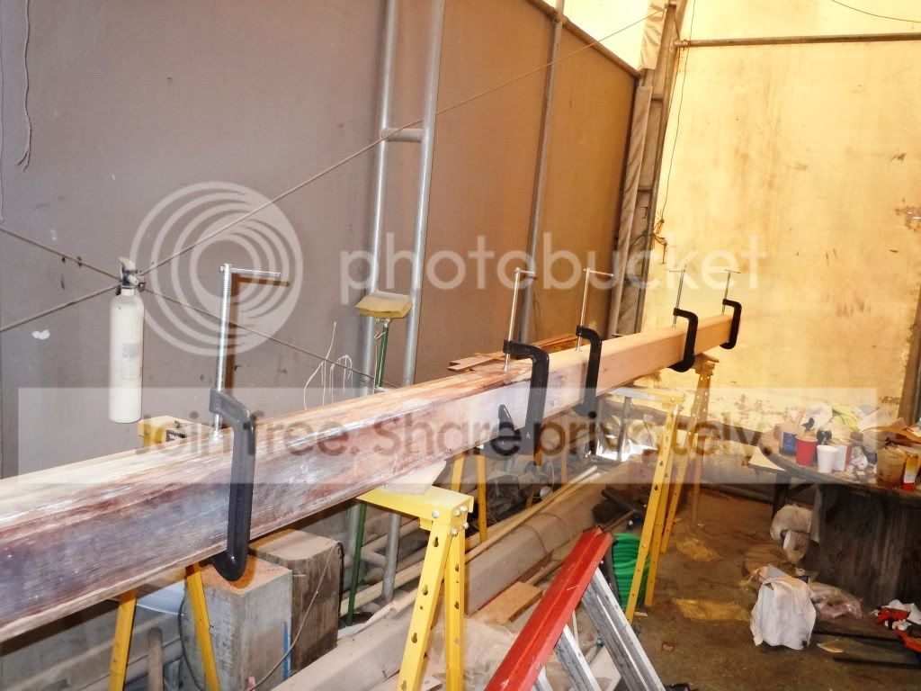

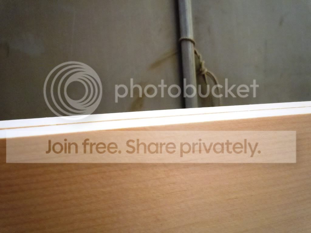

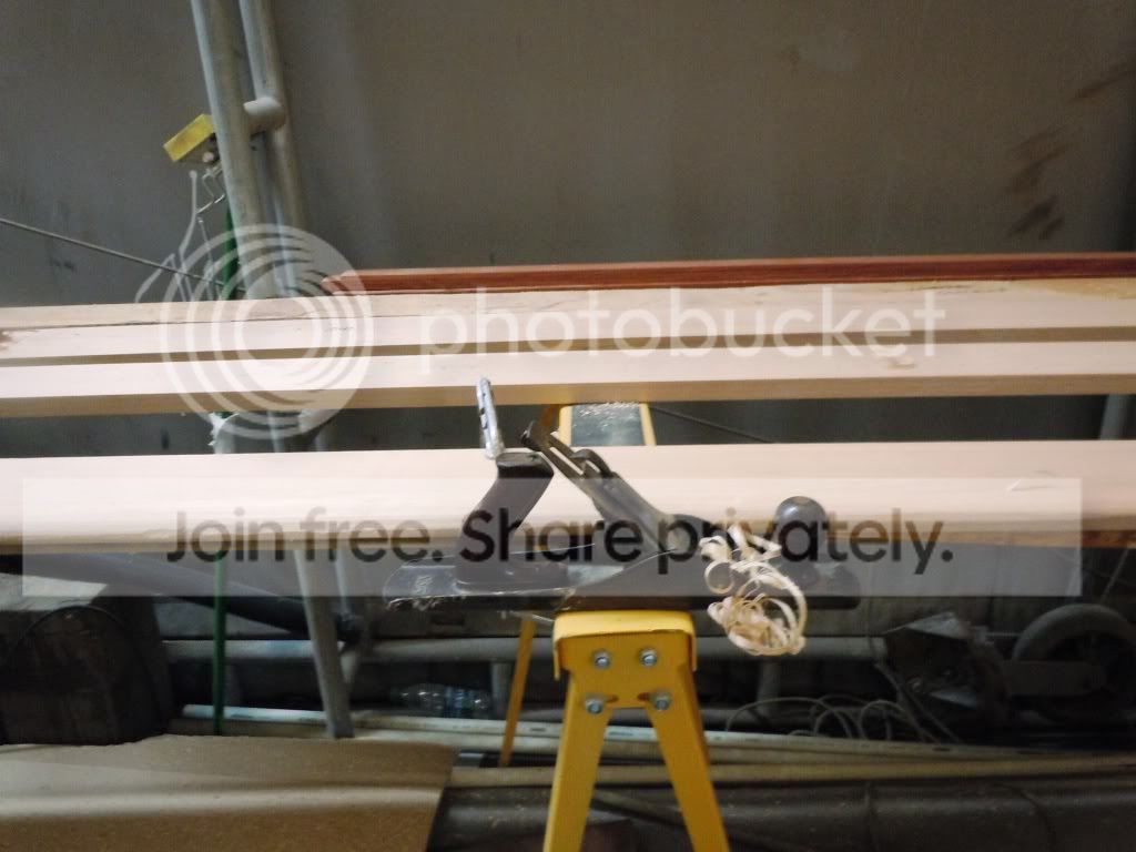

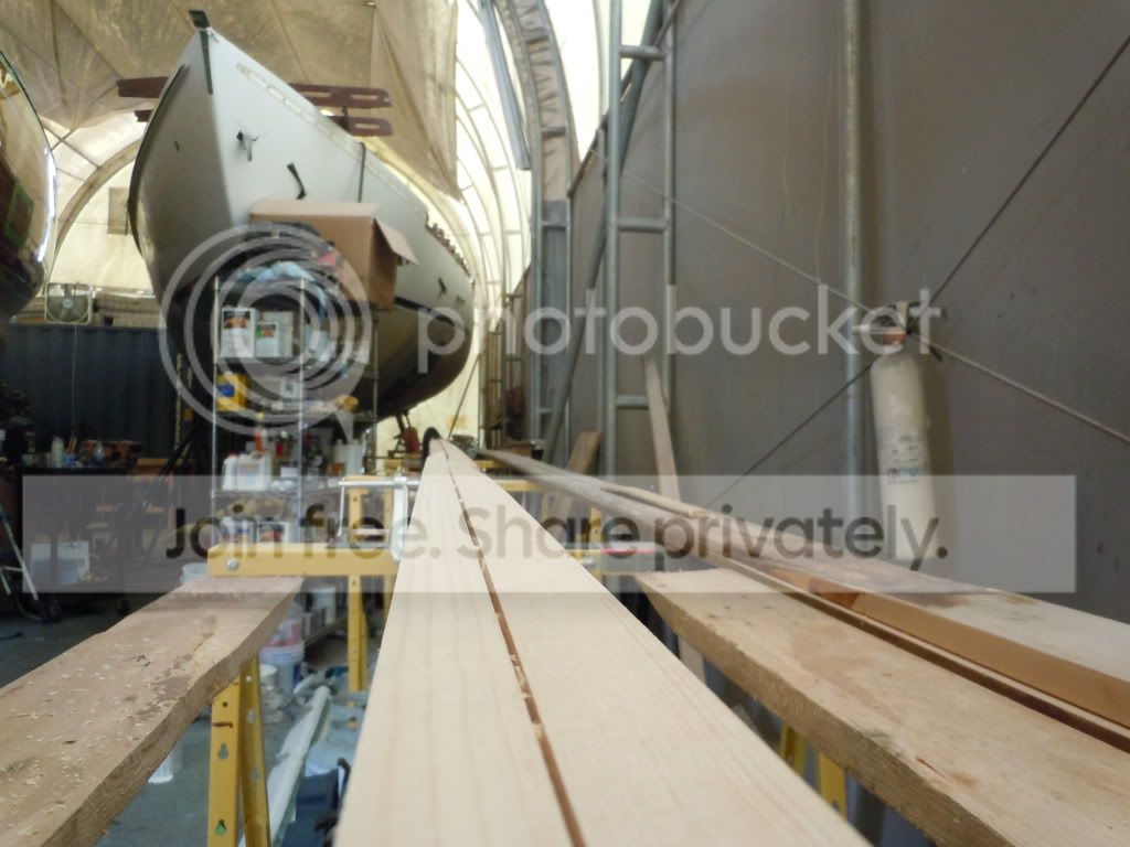

Then there was the mast work. I finished the cuts, scarphing (16:1) and glue up of the various parts. Then came time to plane, trim and shape the radius. all by hand with antique planes I bought last year.
These side panels curve and change demensions along their length. Perfect match...
and
These fore and aft pieces are radiused along their length. Fun job with an 80 year old plane.

I don't know, Charlie. In the photo of the forward cabin, is that a run on the third starboard rib, down near the bunk, on the aft side? Maybe not, with the quality of work you're showing. I'm trying to varnish a kayak and could use some pointers. We know what it's supposed to look like from the pictures. Now we need you to tell us how you do it!

Paul, nah, the hull sides were already varnished. i do need to put a coat on as it's a bit dingy when compared with the rest. Four Points, we use Petit Flagship. All U Get, we've had more than our fair share of moisture this year. It's about time ya'll got some...

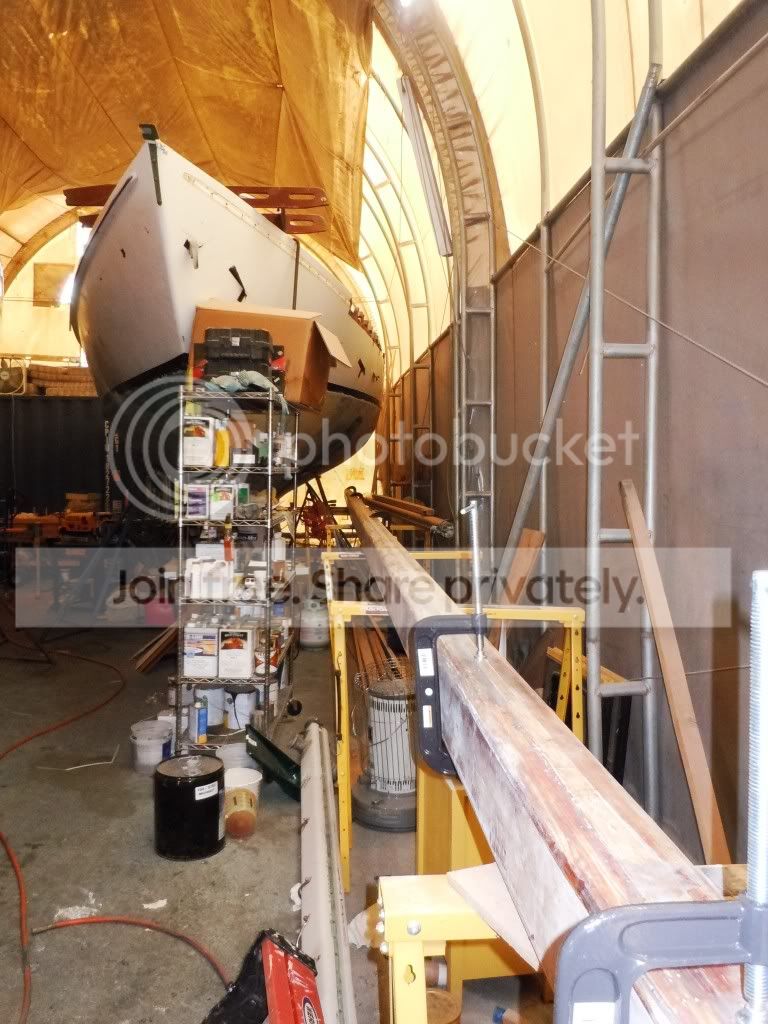

While the boys were working away on the other K-40, I took the time to mock up the mast for Lady J to check fitment. Needless to say, I am pleased. Next I'll set the glue stop blocks and glue the thing up. Here's a couple of photos. It's starting to look like a mast again.
and
