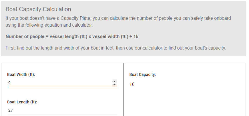

Pleasure craft under 20 feet have to have a max capacity stated on a plate; over 20 feet the calculation is (from Boaterexam.com; beam taken from Yamaha website):
Number of people = vessel length (ft.) x vessel width (ft.) ÷ 15
And has been pointed out above the boat is "Yacht Rated", so the above calculation applies. So it appears they were UNDER capacity for the boat. It certainly seems like a lot of people on a boat that size, but not in excess of design if I read the capacity calculation right. Someone correct me if this is jacked up.

Yes it does seem like a lot.
I did notice the regulations also have an engine weight factor that alters the basic calculation and lowers capacity. The Yamaha 27 has dual inboards.
Obviously the operator should alter load for the conditions.
Unless there was a failure, the load doesn't appear to have matched the them.

Years ago in this forum, we used to go round and round about boat capacity and this calculation every time a capsize event occurred. I think the general consensus was that this calculation makes absolutely no sense and if I'm not mistaken, it was eventually eliminated from the boat safety courses? In any case, if you have ever been on the Hudson River in the vicinity of New York and New York Harbor, the waves from all the traffic can be insane. There is absolutely no way this boat could have been safe with this number of people on it. I imagine these were even The article also states that the boat "owner" wasn't even on the boat ... he was on a jetski following behind the boat.

Haven't done a poll across boater safety courses, but a quick Google search shows the calculation is still on Boaterexam.com - Boat Capacity, Rules & Weight Calculation | BOATERexam.com® .
I also ran across an alternate calculation for boats over 26 feet, which divides by 18, which would have made max capacity 13. As "worthless" as these calculations may seem to some, let's be realistic here that there's just no way the average pleasure boater is going to do a weight and balance calculation like pilots do before taking off on a flight. And its not taught in boater safety courses.

The boat model "AR240" can be clearly seen in the video clips. On the MFG website the passenger capacity is stated. It varies based on year
http://specs.bvimedia.ca/en/specifications/yamaha/sport_boat/ar240/2019/
For those that aren't bothered to click
Year, Passenger capacity.
2011 10
2012 11
2013 11
2014 11
2015 12
2018 12
2019 12
Someone might be able to discern the year by comparing images but that won't be me....today anyway..
