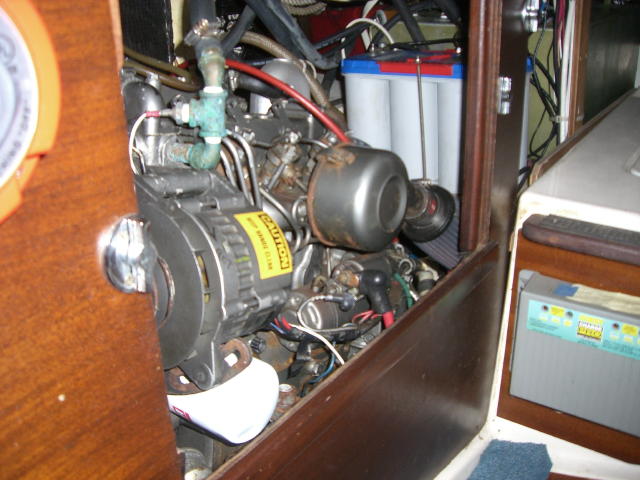

That sponge Yanmar uses is a piece of crap. There's lots of ground up fiberglass floting around any boat. A diesel engine is a great vacuum cleaner. I put a large clamp-on K&N cleanable filter on the snorkle of the original air cleaner sponge housing. Works great and will last forever. Cost is not relevant because the K&N's last so long and can be washed. I have some that are 30 years old. No problem.

Neither. They are oiled, corrugated fiber supported between screen grids. Washable. Available in an enormous variety of configurations. Were developed as lower restriction filtration for performance engines (motorcycles) and as forever replacements for original equipment filters. In the picture my K & N can be seen on the snorkle sticking off the air inlet bowl.
