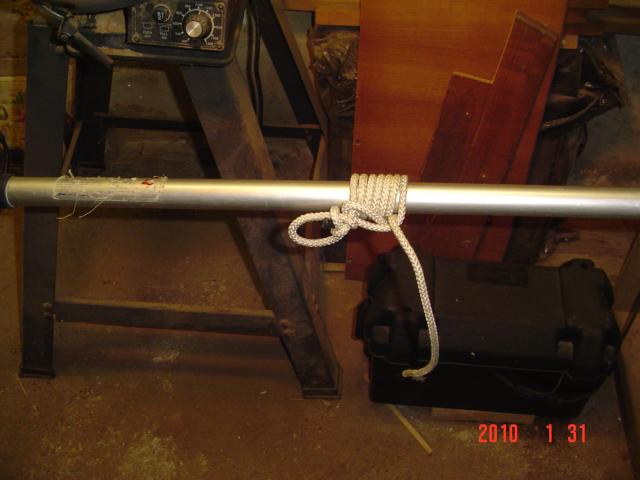

hold it in place. My friend Wayne made up a rig
such as this and it works great. I had designs
on making one similar to his, and then it hit me.
Why not use a length of rope around the mast in
the form of a "Rolling Hitch"? One rope could do
it, but two ropes would be better. The "Rolling
hitch" that I'm going to show you is very
different than the ones that are shown on the
knot sites and most knot books, yet most power
company lineman can tie this hitch and use it
every day on the job. This hitch can be tied to
wire, rope, Jib sheets, spars, and even a mast
and it's ultra simple to tie. Take a length
rope about 3.5 or 4' long and tie a Bowline at
one end. You really don't need the bowline, but
this is what I intend to use as an anchor point
on my mast that will hold my baby stays, and it's

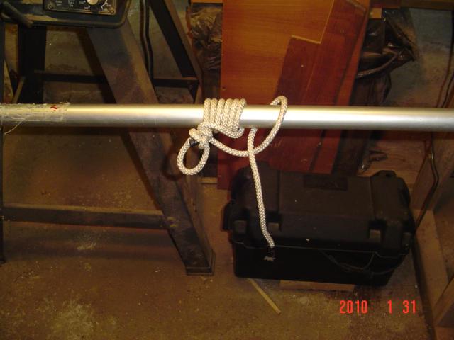

easier to describe how to tie the hitch. Start
by taking 5 or 6 clockwise wraps around the mast
and while holding the turns in place, bring the
rope down and under the bowline and back up over
the wraps and tie two half hitches around the
mast. That's it! You can grab that hitch and
slide it up or down with your hands and put it
anywhere you like but if you add tension to that
bowline, that hitch won't move. In fact, that
hitch would hold your weight without slipping.
So with this anchor point on my mast I needed
something to attach the baby stays to and I've
decided to use a short piece of rope in the form
of a noose that will go around the mast and
connect to the bowline at the bottom of the
"Rolling Hitch." I took some small pieces of
clear hose and threaded it into the noose, along
with two welded stainless steel rings which will
be used to connect my baby stays from the two
pivot bridles. Once I get the noose set up
around my mast with the rings in between the
hoses where I want them, I'll probably seize the
rings to the noose. Any of you people who own
O'Day 25s or 26s that have triangular plates on
their stays for the boom bridle attachment, can
probably add more stability for their masts by
making up an extra set of bridles or baby stays
and attaching them to the plates and the mast. I
must admit to you that I haven't really tried
this yet on my mast but I know that it will work.
This is what I intend to use. One other
important thing bares mentioning here. When you
attach the rope from the noose to the bowline of
the "Rolling Hitch", you should use a "Round
Turn" and two "Half Hitches" so that you can
untie it easier. Also, the "Rolling Hitch" can
be slid down under load. So that's it! Please
feel free to improve on it if you like and let us
all know what you came up with. Also, if anyone has any questions, please feel free to ask.
