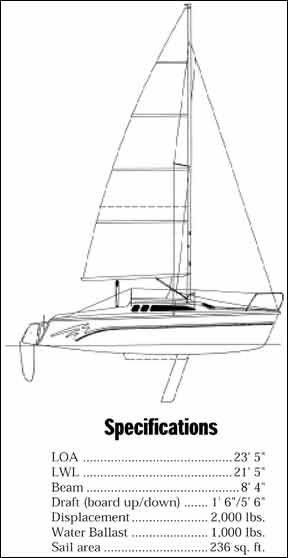

I am going to look at a 1993 Hunter 23.5 this weekend. It is currently docked at a lake here in NC. Any advice on some of the important things to look for when evaluating this boat would be a big help. I have experiencing with power boats but never sailboats. The price with the trailer is 8900.00. Is that in the ballpark? Here are the posted features of the boat:
Details:
- Swing Keel with water ballast - draft 5.5 ft. with keel down, keel up 1.5 ft.
- C. Sherman Johnson quick release lever for quick and easy mast step up
- Main sail cover, head sail cover bag
- Bimini
- 4” solar Marinco vent
- Updated spreaders with wraparound bracket and reinforcement sleeve
- Davis windex
- LED running lights
- Pop-top cabin enclosure
- Tohatsu 8 HP 2-stroke Electric Start with build in alternator
- Marine deep cycle battery
- V-Berth forward, double size berth aft, sleeps 4-5
- Table inside/outside
- Single burner alcohol stove
- Integrated ice box/cooler
- Portable Head
- Rail mount stainless steel marine Magma propane grill with cover
- Shore Power
- Tiller extension
- Davis Tiller-Tamer
- 2 Anchors (fluke and bruce), ore
- Fenders
- Swim ladder
- Life jackets
- Companionway mounted portable 110v 5000BTU A/C unit
*Trailer:
-Bunk trailer, galvanized extendable tongue, new axle, hubs, drums, electric brakes (less than 180 miles)
Thank you in advance for any advice!
