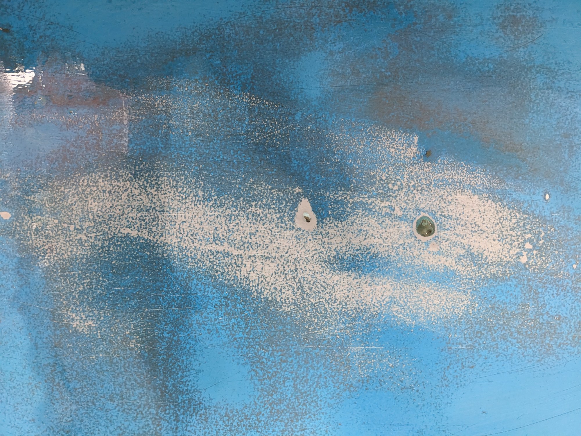

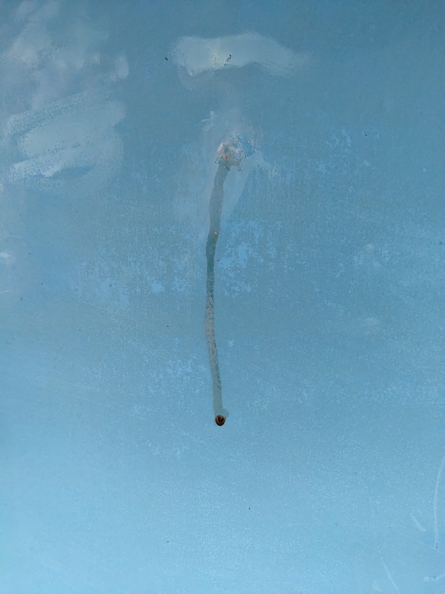

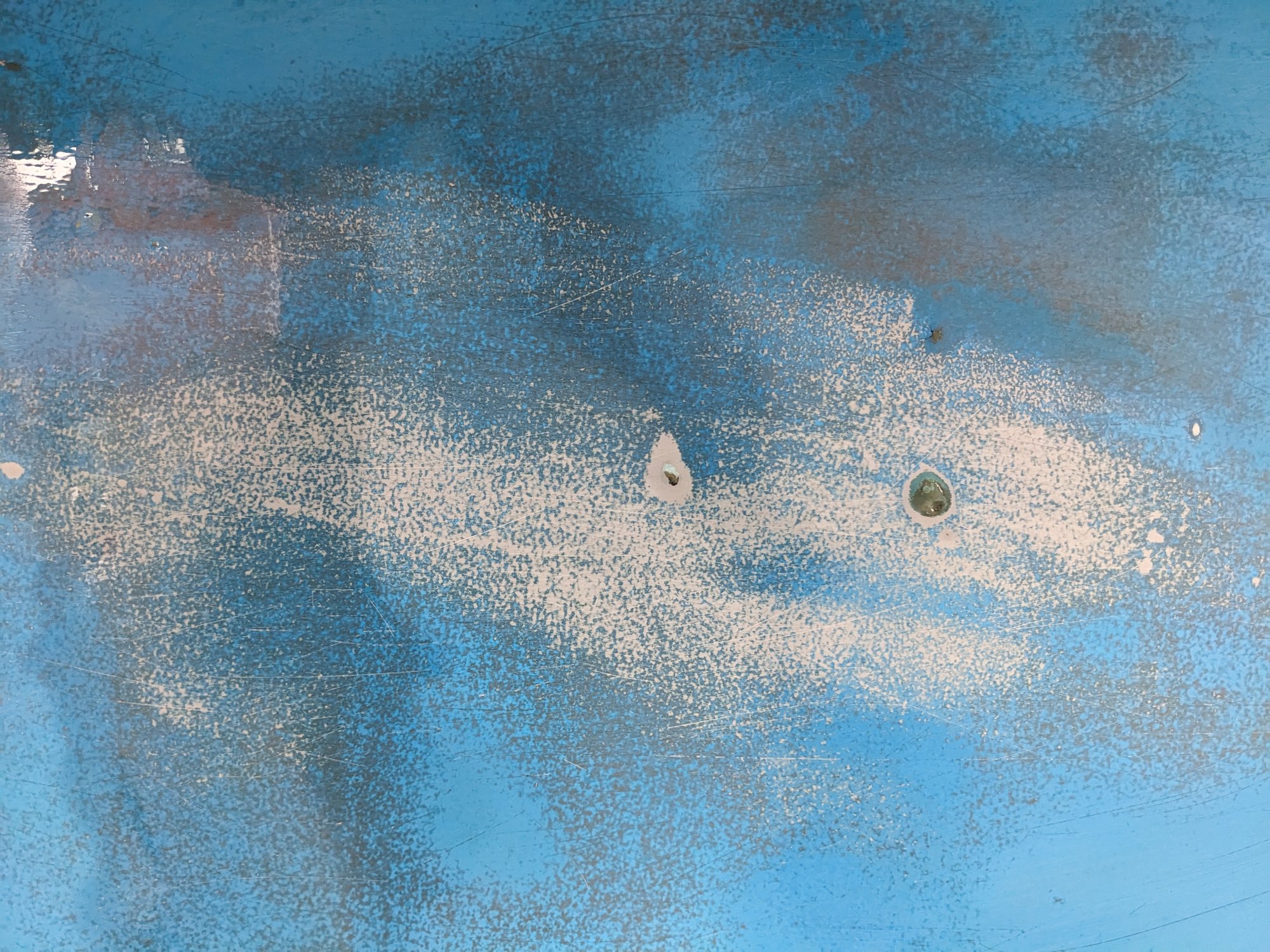

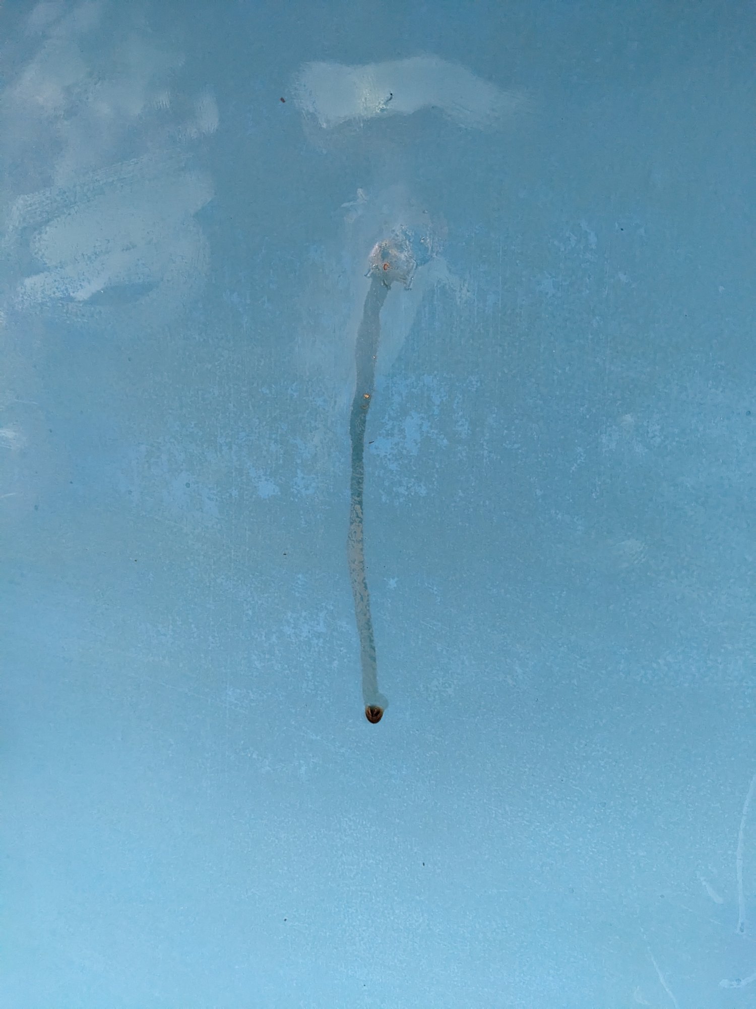

I just payed a lot of $$$$ to have 38 yrs of antifouling paint removed by dustless blast.
Haven't seen it yet but the contractor said the bottom looked very very good no major issues just a few small wounds needing putty.
So, has anyone here applied antifoul directly over gel coat? How'd it work out? Got some Petit hard ablative and was planning to use their tie coat primer but can't locate any locally. Not using Interprotect because of time needed to dry hull before application.

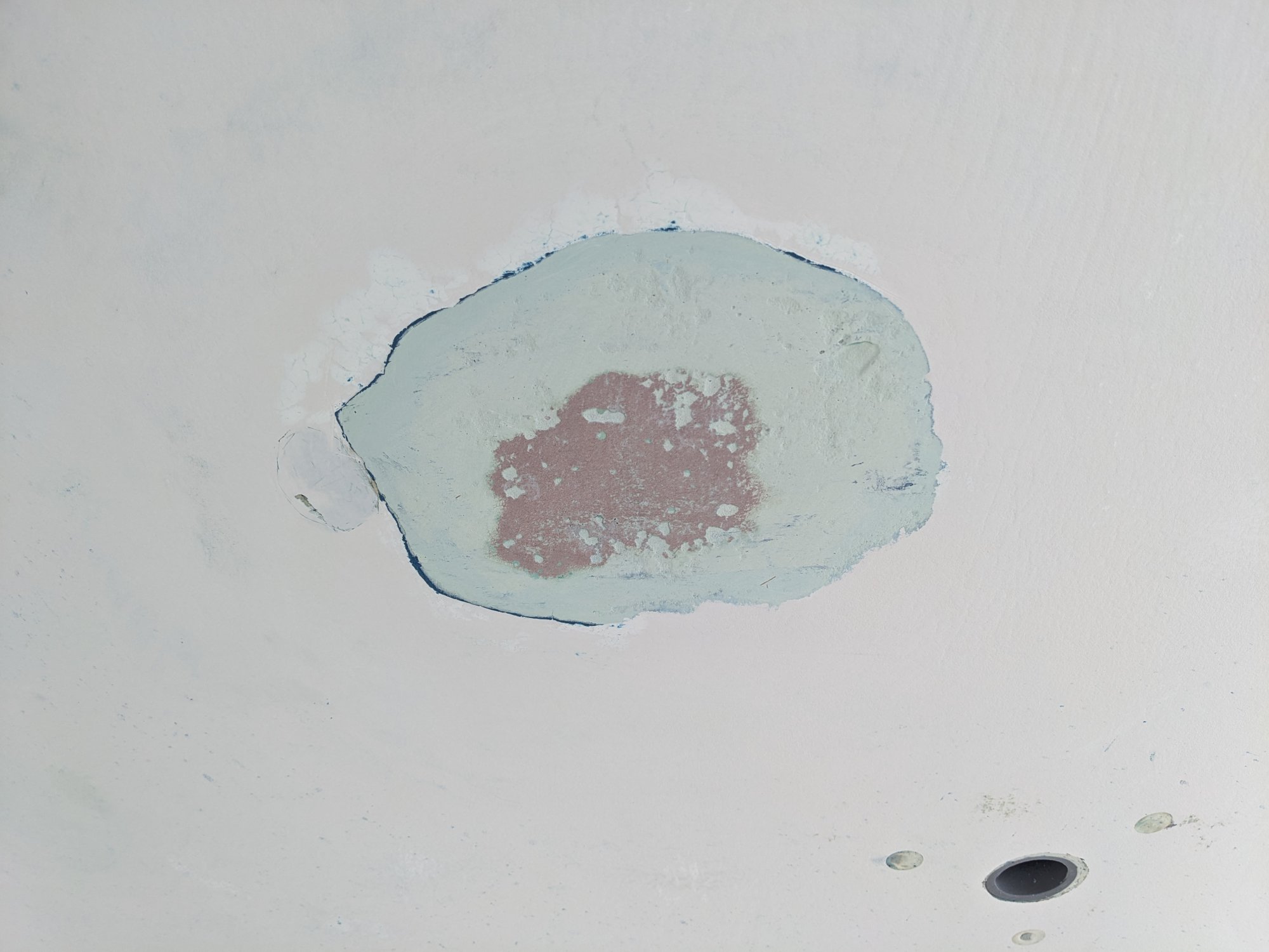

Putty? Please tell us not really.
I hope not. There was a blister that bled red when squeezed.
When exposed looked reddish w/maybe some epoxy neat painted over it.
The one on the right. When Dremeled out turned grey. 5200? Can't be lead too soft and beside above keel joint.
Guesses?
