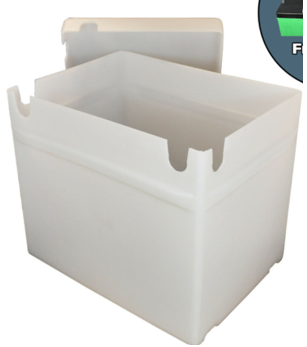

Consider a vent at the top corners as show in the photo below for this commercially-available four (4) 6v golf cart battery box. The lid sits on top of the box with a 1 inch "lip" and has a vents.
If you are considering the wire access cutouts as vents, then I don't have anything to worry about. From the overall square inches that these are compared to the size of the box (including the 1" overhang), I will have plenty of ventilation under the lids I have designed. Thanks.

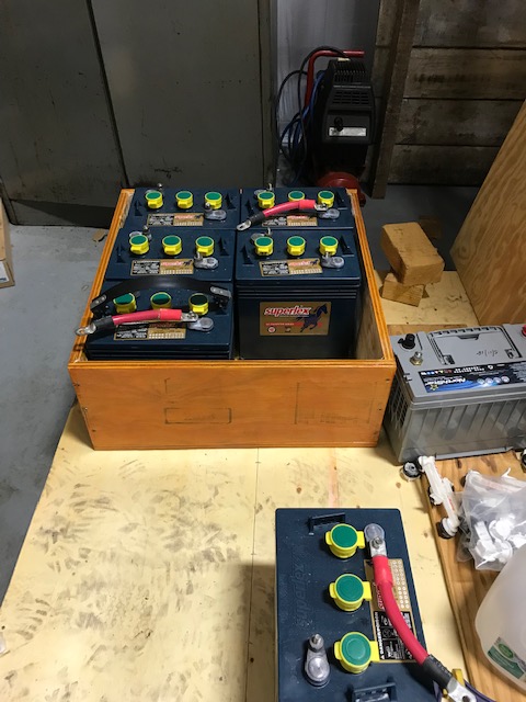

I built my own battery box for six GC batteries. Just be sure to epoxy the inside of the box so it can contain any acid spills. I fiberglassed the inside for strength and epoxied the inside and outside to seal the wood from moisture. Then I brought it to a truck shop to have it Rhino Lined per Maine Sail's advise. I made my cover with four 2" x 6" cutouts for wire access and venting on each end.
