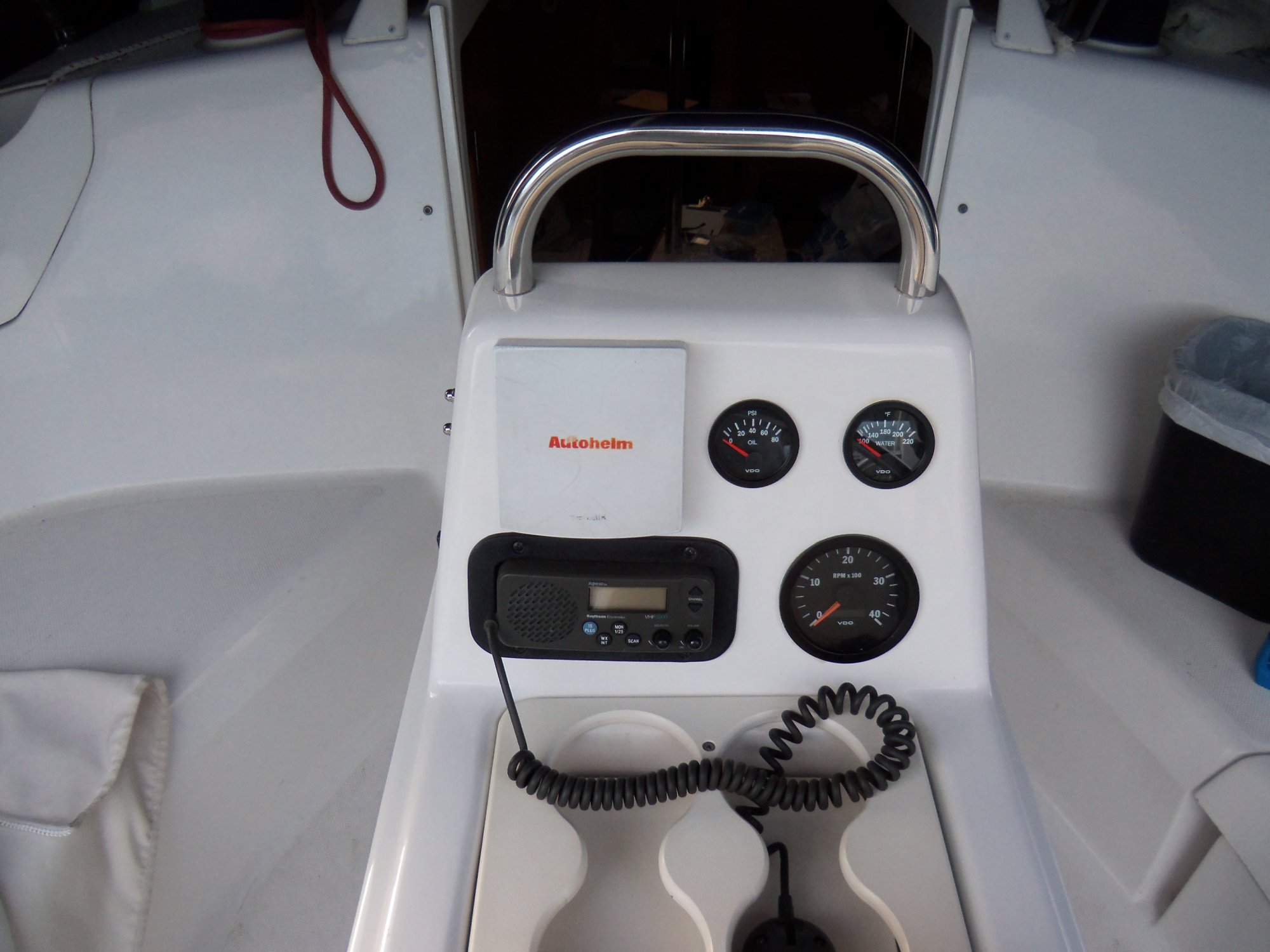

Installing gauges is a useful endeavour if you like to feel you're on top of everything.
A couple of years ago my temp gauge was slowly coming up from cruising at 172 deg. to 180 deg. which tipped me off that my heat exchanger was coming due for a cleaning in the next winter off season. Now back to 172 deg. and everybody's happy.
Be sure to mount your gauges in a visible location and not between your knees which MAY get people wondering about you :laugh:.
