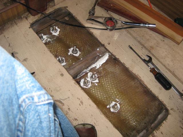

Dave, about your keel bolts-- the PO of my boat had replaced the original 5200 with Boat Life caulk and had all the inevitable nightmares this led to, which led to his selling the boat to me. I loosened the keel bolt nuts and using the hardstands jacked the boat up about 7/8", removing all residue between the lead and the hull with a Dremel, chisels, acetone, and whatever it took. I had a support under the forward edge of the keel to keep it from teetering over forwards (which either didn't work well or wasn't needed). Then I sanded and pumped TWO tubes of 5200 quick-cure into it. And we cranked all the hardstands back down and squashed (most of) the 5200 between the hull and the keel. About one tube's worth oozed out. Some of it I was able to 'fair' with a putty knife but its being quick-cure 5200 it still oozed over the next few days. It's a little ugly now but I will smooth and fair it before painting.
I did find some evidence of (minor) delamination of the hull near the keel attachment area. Outside, this was gouged out and dried and awaits fairing compound. Inside, I drilled 1/8" pilot holes into the laminations around the keel bolts (this after the keel was reset) and with a syringe pumped WEST epoxy into the laminations-- the same thing I did to the balsa core of the deck. In only one place did it take any substantial filling. You can see where the delamination damage is because when you pump into one hole it comes out another. The contiguous holes were only about 1/2" apart and are now well filled.
Almost immediately after that (within 10 minutes) I removed the nuts completely and installed the backing plates I made out of G-10 (epoxy-impregnated fiberglass; be prepared to ruin every tool you cut or drill this with, including my cousin Dave's $110 tablesaw blade). These were bedded down with 5200-- but first I wrapped tape around the bolt shafts so that they can be adjusted in future-- otherwise the 5200 would bond to the threads and it'd be dead where it lies. Then I torqued up the nuts with a plain adjustable wrench (not even a long one). You are always cautioned with tightening too tightly against 5200-- 'you don't want to squeeze it all out', or 'leave a gasket', they say. Here I did not need a gasket-- the 5200 was only to fill voids in the woven roving under the plates and to add laminar stiffness. Carefully, but steadily, I tightened them till the next muscle would move them maybe another 1/8" or less. This was 2-3 weeks ago; yesterday I put a little more torque on them. At this point it is compressing the cured 5200 between the lead and the hull, which is what I want.
I made the backup plates only for the forward foursome of bolts (2 bolts per plate, longitudinally to allow water to pass between) as they hold the most and for the forward single one. The forward one is most crucial as it's the first to be shocked in a keel strike (why did your boat have no nut on THIS one??). I made an extra-big plate for this, limited only by how much flat area I had to bond it to (about 8" long and 3" wide). This and the other bolts all got extra-big fender washers and locknuts. I had some rainwater come down the hatch during a recent blow but the 5200 is holding water out from under the plates and all is well.
I don't believe in torque numbers for rigging or for keel bolts. Prescribing them is an instant lawsuit for someone. Every boat is different. I do not know the condition of your hull or keel, or what has been done to it, or what tools you're using, or what idiot messed with it before you did, or anything. In my opinion anyone with a set set of numbers is asking for and offering trouble. (My brother and I, both guitar players, tune rigs harmonically. Really.) Listen to your fear-- tighten them till you're afraid to tighten any more. Then 3 days or 3 weeks later do it again. That's my rule for everything. (No keels falling off or masts coming down so far!)

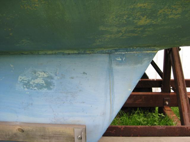

Thanks for the insight into the engine mounting and keel bolt question, John. I certainly understand the point about torque. I am simply trying to ensure that the keel bolts were evenly loaded. I did back off and come up on them evenly to about 30 foot pounds (which actually feels right). I enclosed a few pictures, including 2 of the keel area. I don't have the luxury of being able to raise the boat off the trailer presently. It appears as though the PO attempted to fill in the leading part of the parting surface with 5200 (see the rust stain?), but I don't think he knew the front nut was missing. Is it possible for me to clean out the residue 5200 and re-fillet that area with more 5200 for the season (June through end of September)?

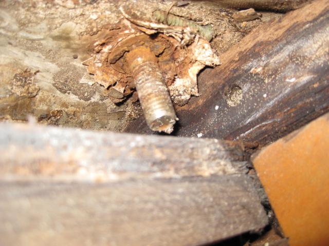

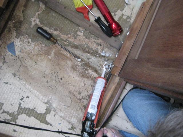

Just a few more pictures offered for comment. Yes, there are obvious signs of leakage into the hull from the forward keel bolt (that had no fastener on it:eek:), but I have temporarily addressed that. I think I can get away with sailing for the summer by sealing up the fillet area (outside) with 5200 just for the season, while my trailer gets modified so the whole shebang fits in my garage. (Then I can figure out a way to lift the boat and really reseal the keel). This boat sails on a freshwater lake. The inside hull skin sounds very good "tap-testing" with a quarter (no dead spots); I haven't tried it yet outside.
