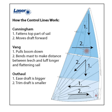

Using a simple single sail on a Laser, it helps to identify the ways the sail is altered to adjust the forces on the sail.

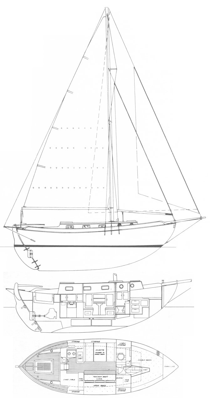

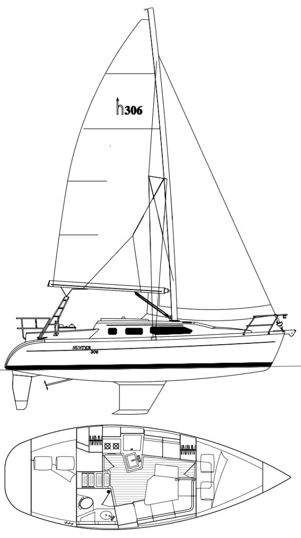

Look at two hull designs of similar length boats
  • one is quick to turn,
  • the other plows straight
  • One has a wide belly and carries it towards the stern
  • the other s more symmetrical in shape yet the beam width is within .25ft of each other.
The hull design provides a clue to the ease of turning, or sailing a straight line. Also the distance from the keel to the rudder influences the affect of water flow under the boat, reflected in the handling of the rudder.

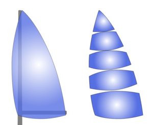

How Camber is Built into a Sail ​
First, the sailmaker cuts the luff and foot of the sail in a curve. This is shown in the left hand diagram. When the boom and mast are straight, the extra material leaves a pocket in the sail. These pockets can be flattened by bending the mast or the boom. ​
Next, the sailmaker curves the edges of the panels, as shown in the right-hand digram. The picture above is exaggerated to show these curves. When sewn together the extra material forms pockets along the seams. These pockets are less responsive to flattening. ​
The sail designer determines how much curvature is desired for the luff, foot and each of the seams to optimize the sail shape and its response to the sail controls. ​
