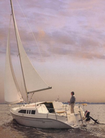

I can tell you that the H240 is easy to tow. I have a 2010 Mercury Mountaineer with a V6. It has the 3500 lb towing package and it will run the boat with trailer right up to 70 mpg with no effort. I pulled mine 600 miles from Jupiter Florida to North East Atlanta. The H260 with everything on board gear and motor is very heavy. I would have had to rent a truck with a large V8 if the deal I had in Panama City went through.
12,776
... The H260 with everything on board gear and motor is very heavy. I would have had to rent a truck with a large V8 if the deal I had in Panama City went through.
The Hunter 260 empty is 3000lbs. The Hunter 26 empty is 2,600lbs and the Hunter 240 empty is 2300lbs.
Although the H260 and H26 share the same hull mold, the empty displacement of the H26 is more similar to that of the H240. I'm guessing the H260 has a smaller ballast tank and more permanant ballast than does the H26.

specs for the26 &260 show both boats to be dry weight of 3000 and 2000 lbs. of water ballast. Tanks are the same as I was involved the design of both
12,776
@rgranger
I got those numbers here...
