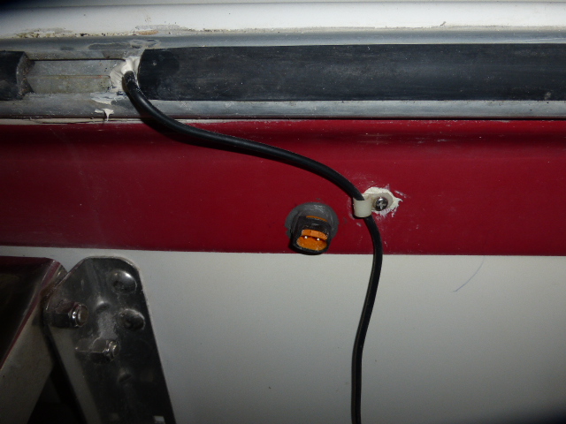

LETS JUST SAY: I have a solar system set up on my boat already with a plug on the transom where the solar panel plugs in. this is the waterproof plug just inside the red stripe
the solar controller is on this line in the battery compartment down in the cabin.
I'd like to have a plug on the transom to plug in my C-Tec charger when the boat is in my boat-port at home and the sun has set, so do I need to run another set of wires and mount another plug in the transom just for the C-Tec charger (bypassing the solar controller), or can I just unplug the solar panel and plug the C-Tec into the existing plug to charge my battery?
Thank you

I think I now understand. You want to disconnect the solar panel and then connect the C-Tec to the port that the solar panel was connected?
No. Because you stated that the solar controller was connected to this panel down in the battery compartment. That input to the controller is looking for a specific voltage from the panel (17vdc?) and if it does not see that, it stops the charging process. What is the cutoff voltage? You have to look up that information from the manufacture. Your C-Tec might only produce 13.x volts, maybe 14.x volts. Might not be enough for the solar controller to activate.
