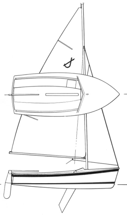

I use images to help determine what rigging and rudder were originally considered.
23,696
Rudder could be a single board gudgeons & pintles attachment to the transom, with a tiller for control.
