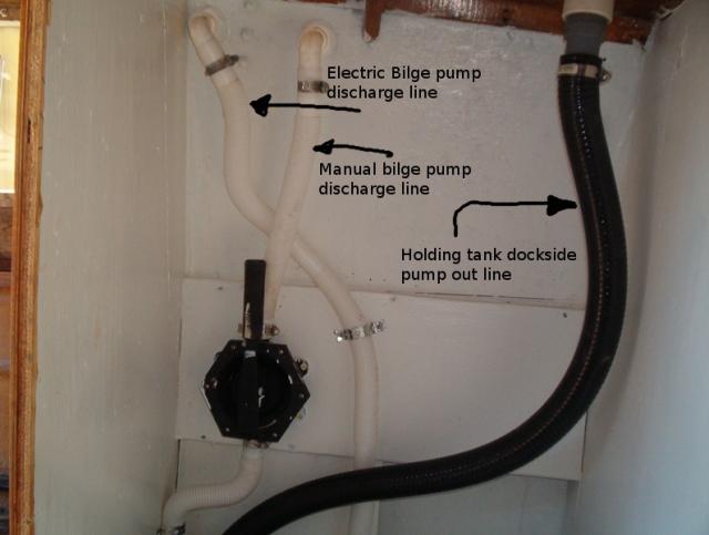

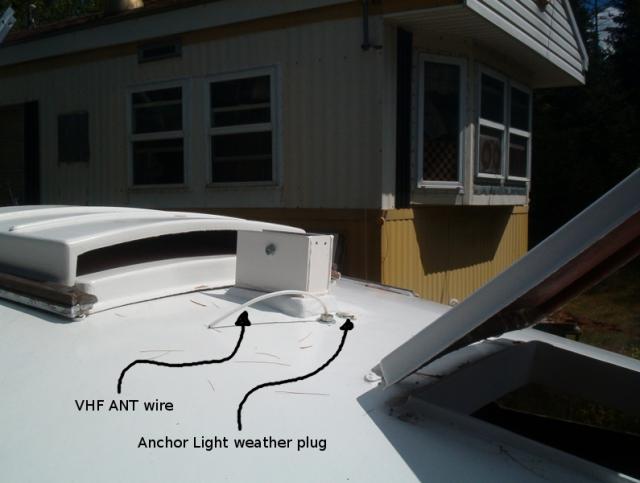

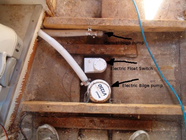

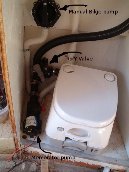

Just some new photos of the work I've done today. I've been down the last 3 weeks when I realized I would not get to sail her this year and haven't done anything till today. I still have to install the vent line from the msd as well as the discharge line and fittings for overboard discharge of the msd as well. Tomorrow I will finish off wiring the one remaining cabin light as well as the bilge pump and float swith and the mercerator pump. Then it will be time to wire up the panel.
