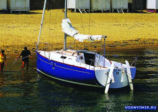

The Beneteau First 260 has a lifting keel and also lifting rudders. Each rudder is mounted in an aluminum cassette than has four positions, from all the way down to up to the waterline. Because the tiller is not attached to the rudders, only the cassettes, it does not change position if you raise the rudders.

Because there are two of them, even all the way down they draw less than the keel does when retracted.

The first 235 has a single rudder in the same cassette. Obviously it looses the advantage of twice the rudder surface per depth. The First 260 draw 6 feet with the keel down but only 2.80 with it up. Even all the way down the rudders are shorter than that but get tremendous bite, even when one is levered out of the water.
The 260 ruddy assy is about as complex (and costly) as a swiss watch... although a guy might be able to craft it up cheaper.

The Seaward is very much like the First 260, cassette and all. The 260 needs the dual rudders because the transom is so wide.
