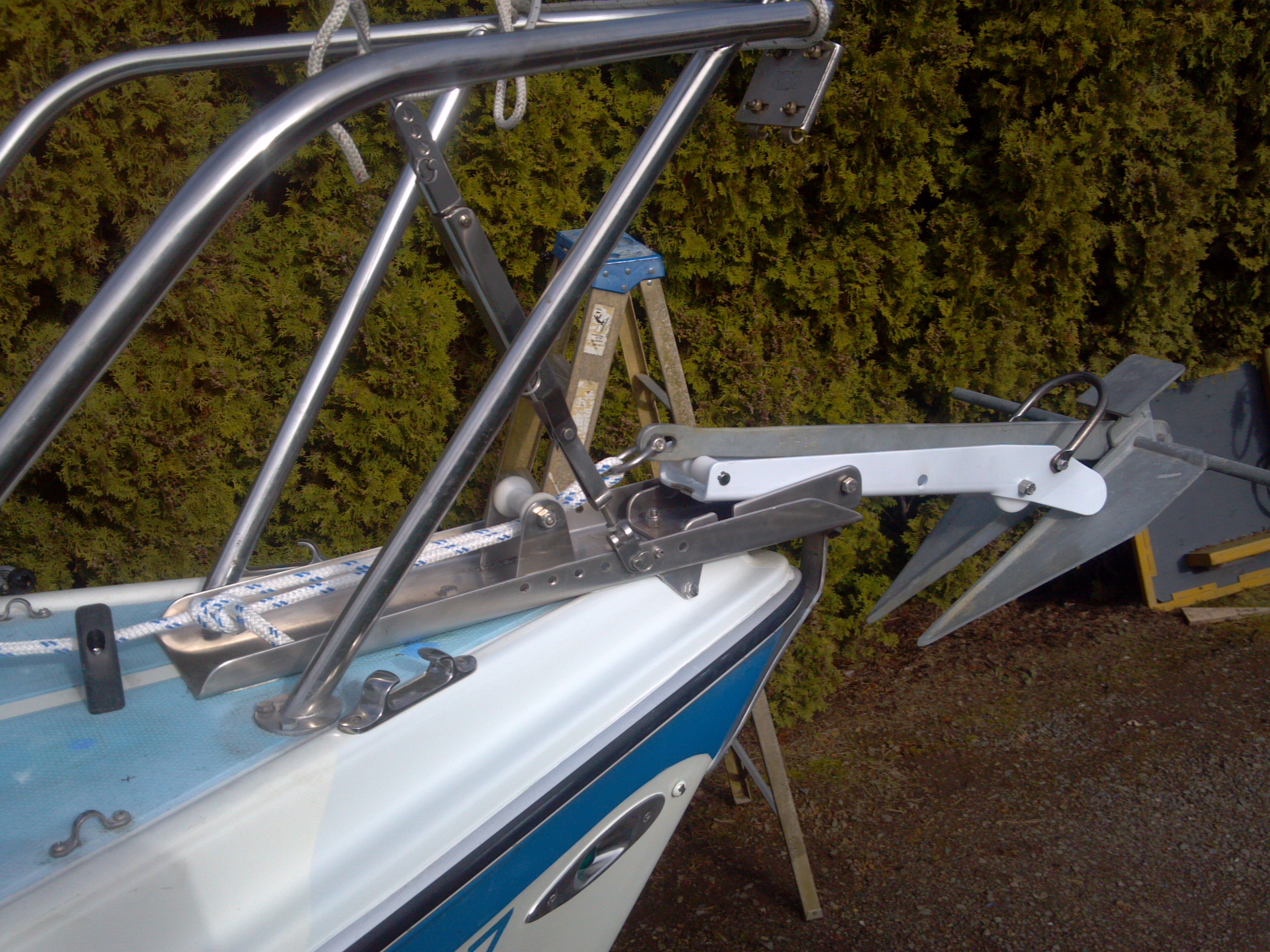

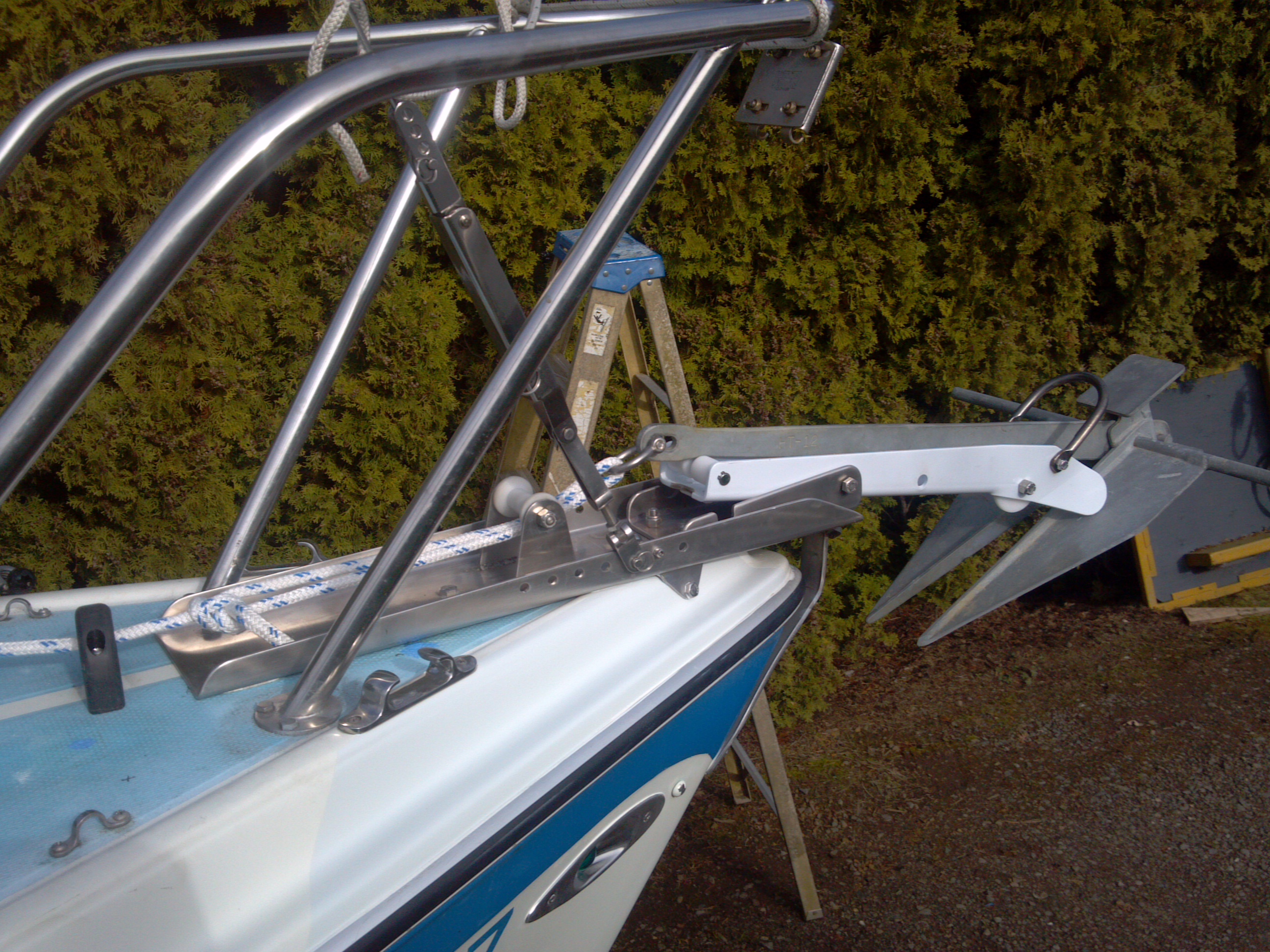

maybe something like this...
this is what I built for our 25... I purchased the white part, found the hinge bracket it sets in, and built the rest of it... the custom base unit that attaches to the boat is the also the stem head fitting. it is securely and strongly attached to the boat, so it will support the loading of the anchor from any direction, as well as the lifting load the headstay places on it.
you can see the headstay is attached in the photo.
all you would need to do is find a roller that is narrow enough that you could bolt in place of your existing roller, so it would extend where your anchor sits.....

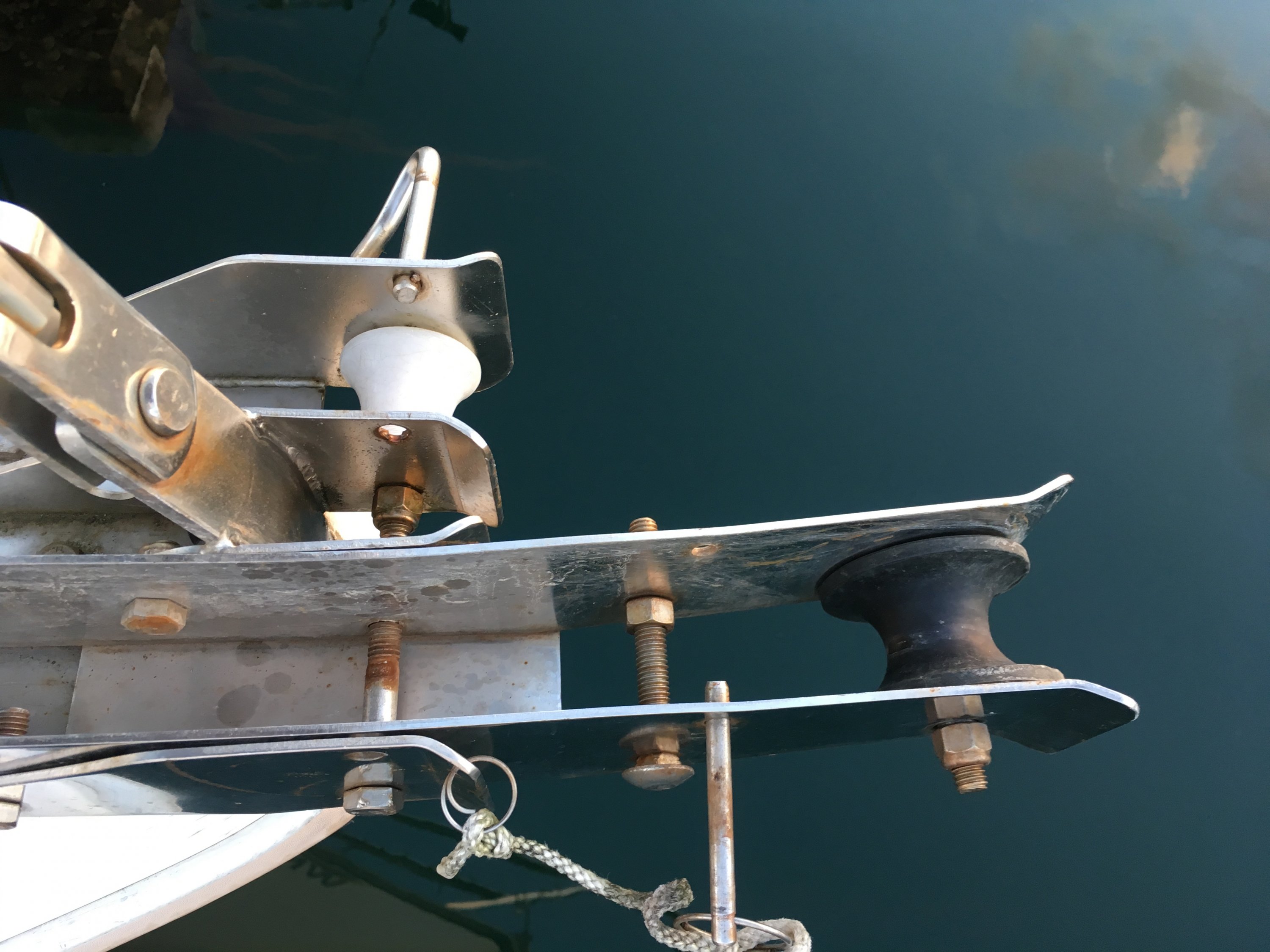

it would appear that someone has already attempted this on your boat. the base unit seems to be a short anchor roller with the roller removed, and an extension bolted in place....
have a longer extension made up to take the place of the one that is already there....
That looks great and looks like it works well too.
Mar 20, 2012
3,983
it works very well. it was designed so that it self deploys.. the anchor rode is handled from the cockpit.
the anchor can be pinned to lock it to the roller for trailering, or rough weather, but for general boating as long as the rode is cleated, the anchor stays on its roller.
