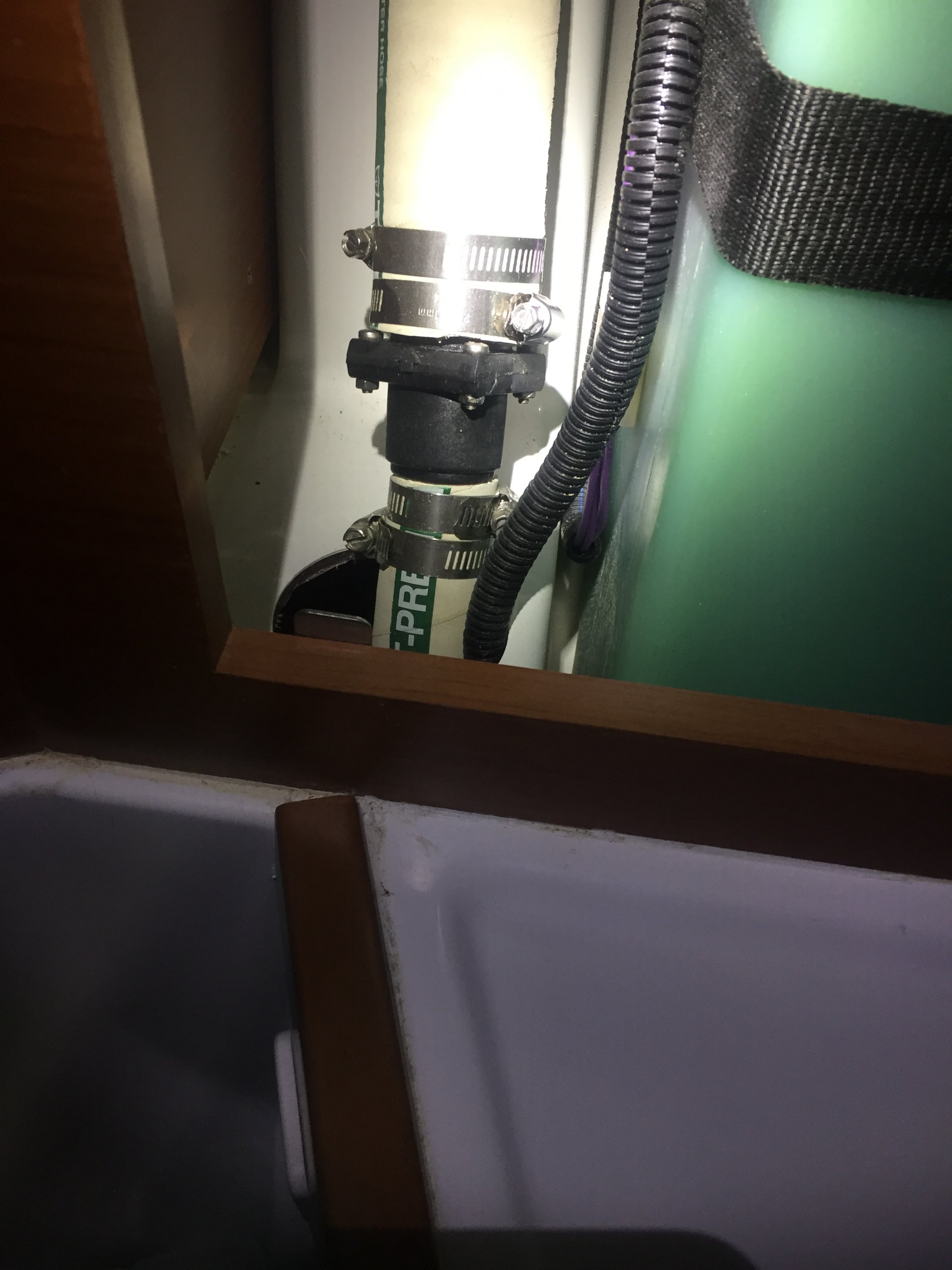

The Quiet Flush heads on my 2013 Beneteau 45 work without issues, no odors or vent hose clogs (2” vent hoses with corresponding Marelon through hulls.)
There appears to be a second joker valve, installed in the hose that goes from the macerator outlet at the toilet, to the top of the tank, just before the hose curves at the top to empty in to the holding tank. The holding tanks are above the toilet bowls, so the hose travels upward to the top of the tanks.
It looks like the 2nd joker valve is supposed to act almost as a check valve. Its time to replace the joker valves at each head. Are the 2nd joker valves proper plumbing or do I remove the 2nd joker valve and ensure the hose is properly cleared with a long push of the empty bowl button? As I said, the system has been working well for five seasons…

Not much can happen that I've never heard of before in the 30 years I've been involved in marine sanitation, but that is a new one! I suspect it's a PO's wacky effort to prevent a half-full tank from spilling into the toilet discharge hose when the boat is heeled and running back to the toilet. Remove it...it'll cause more problems than it solves. If that does turn out to be reason for it, there are better ways to solve the problem.

I am the original owner and a sister ship also has the same, so I believe the valve was installed by Beneteau. Picture attached. I’d be interested in your suggestions!

It wouldn't surprise me if Beneteau installed it...boat builders are the WORST sanitation system designers/plumbers on the planet!
If the purpose is to prevent tank contents from running back to the toilet when the boat heels, there are two ways to prevent it:
1. Put a loop--doesn't have to be vented, just a loop--in the toilet discharge line immediately after the toilet that's higher than the top of the tank. If you already have a discharge vented loop in that line, that's all you need.
2. Relocate the discharge and vent fittings on the tank. Most likely they're outboard (away from the boat's centerline) on the top or on a vertical surface...so when the boat heels to that side tank contents run downhill into 'em. Relocating 'em to the INboard side of the tank--end, side or top--which is actually pretty easy to do on most boats, thanks to a li'l gadget called the Uniseal UNISEAL puts them where tank contents either flow away from 'em when heeled to one side, or has those lines running uphill when the boat heels to the other side. (This would also be an excellent time to upgrade the vent to 1".) I suspect you're gonna have to scratch your head to figure out what I'm describing...and it may require some conversation to figure out how best to do this on a particular boat, but I'm glad to help you sort it out.

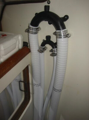

In that case, the simplest solution might be a loop--vented or not--in the discharge line as shown in the attached photo. (You should already have a VENTED loop in the intake if your toilet is a sea water toilet).
This will give you the added advantage of reducing the amount of flush water needed 'cuz you'll only need to flush long enough--and you can use the dry mode--to push the bowl contents over the top of the loop....gravity will do the rest. Use the wet mode only to rinse behind the flush.
