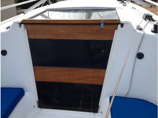

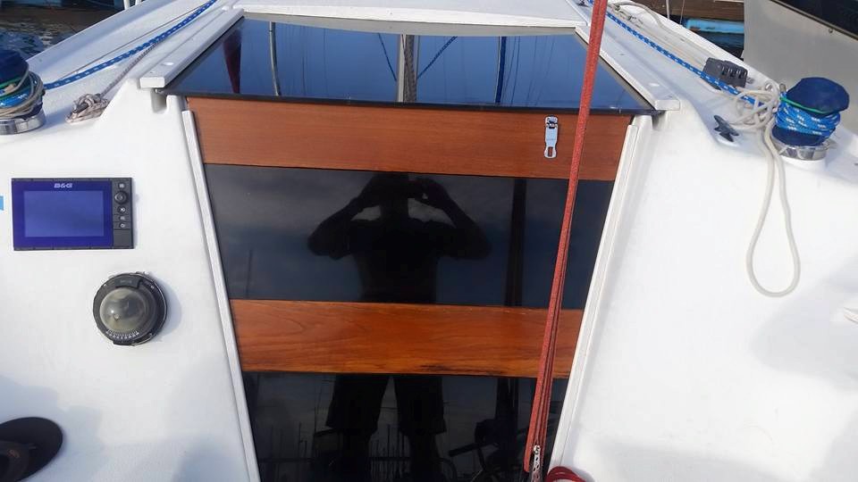

Starting with the companionway, sanded, refinished, wet sanded and polished, polished the lexan as well. Installed new B&G system with wind speed, wind direction, boat speed, depth and temp transducers. The compass has since been replaced as well.

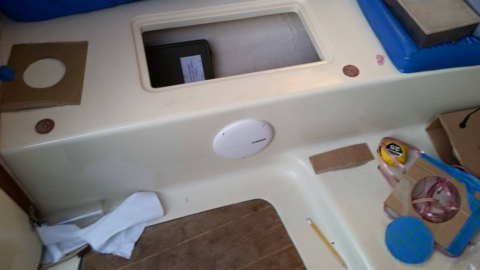

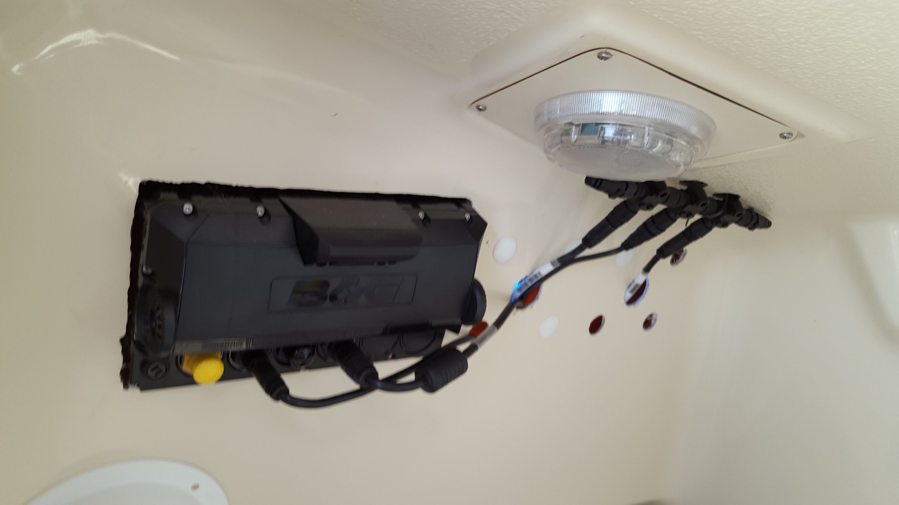

Nmea 2000 backbone for B&G system. Hole cutting was a little shaky on the B&G

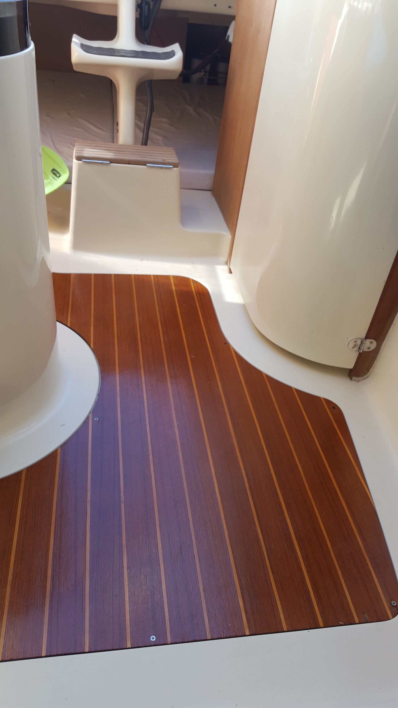

New interior sparker install, one on both port and starboard sides, the storage box acts as a speaker box giving pretty good sound. Notice the condition of deck insert.

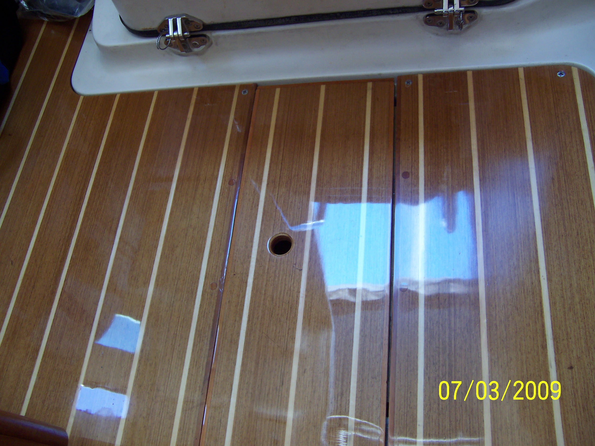

Deck insert refinished, still needs sealant around the edges. I was able to remove the entire piece and take home to refinish. I do believe that most boats this wont be possible due to heavy silicon used to seal insert in place. I have since also refinished the head wall and teak step.

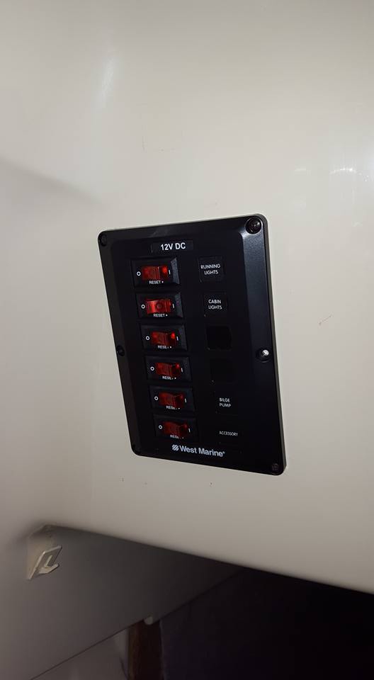

New power board installed, on the original power board there were 2 double pole double throw switches, one for manual bilge pumping and the other for mast/steaming lights. I separated the mast/steaming lights circuit into 2 separate circuits, I haven't labeled yet, I want to test at night and make sure the labeling is correct. The bilge pump that I installed is an auto pump, every 5 minutes it kicks on and checks for resistance in the motor which would be a sign of water, if resistance is detected it will continue to run until no resistance is felt, so the bilge switch here is purely a manual pump switch.

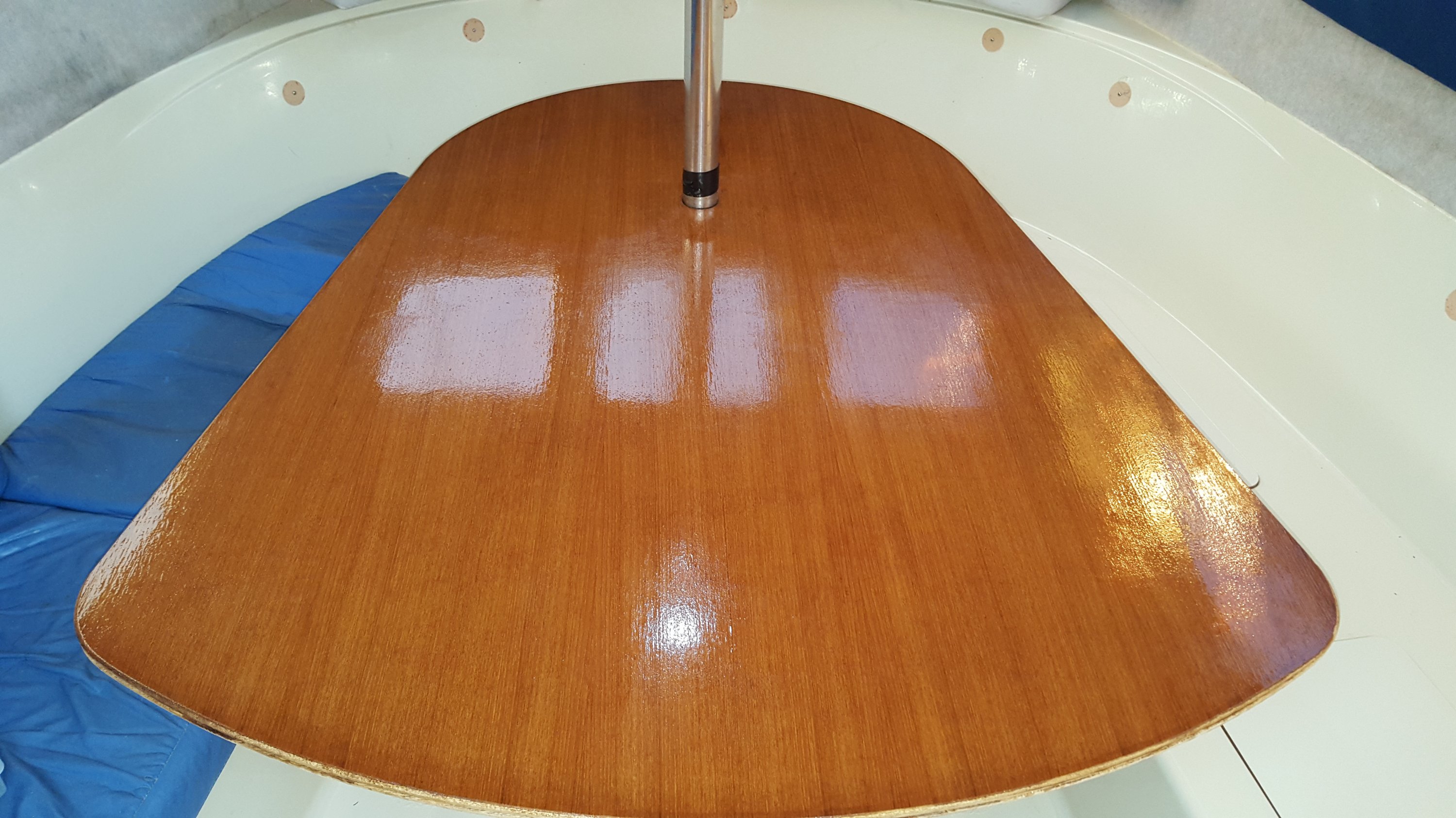

table refinished, the trim hasn't been installed still need to wet sand and polish final finish. all wood was done with cetol marine natural teak, 3 coats. notice the cushions are heavily soiled, I scrubbed like crazy with everything under the sun but the ticket was grill cleaner, took all the soil off in no time.

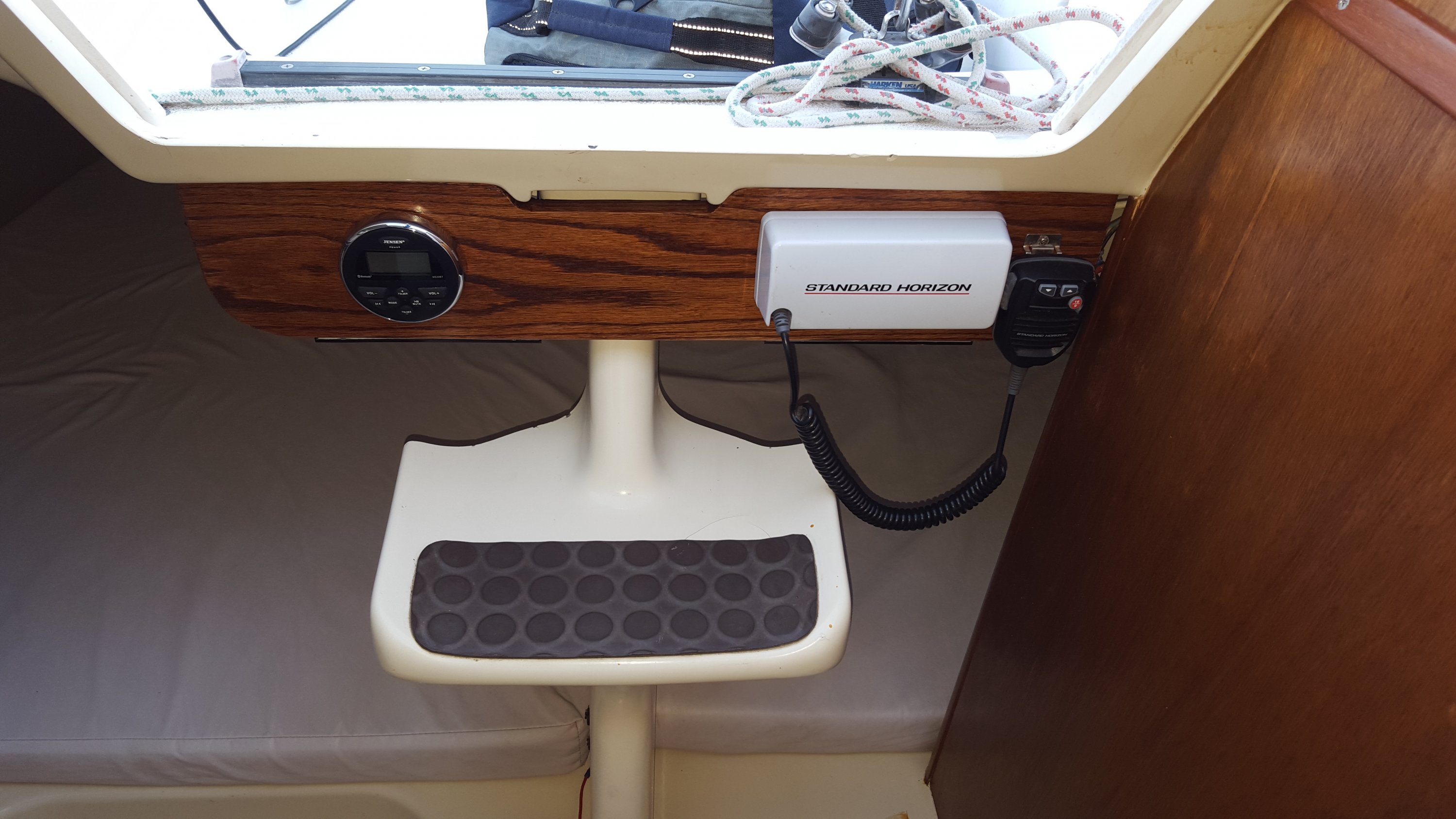

A custom console for VHF and stereo, I would have rather used a teak plank to fashion this from but my impatience got the best of me, I stained the wood best I could and the finished with cetol marine. I installed 2 led strips on the bottom on the plank with a switch on the side to light the stairs at night, the stereo is a marine stereo Bluetooth enabled. all wiring is hid up the stair post and on the back of the console for a clean look.

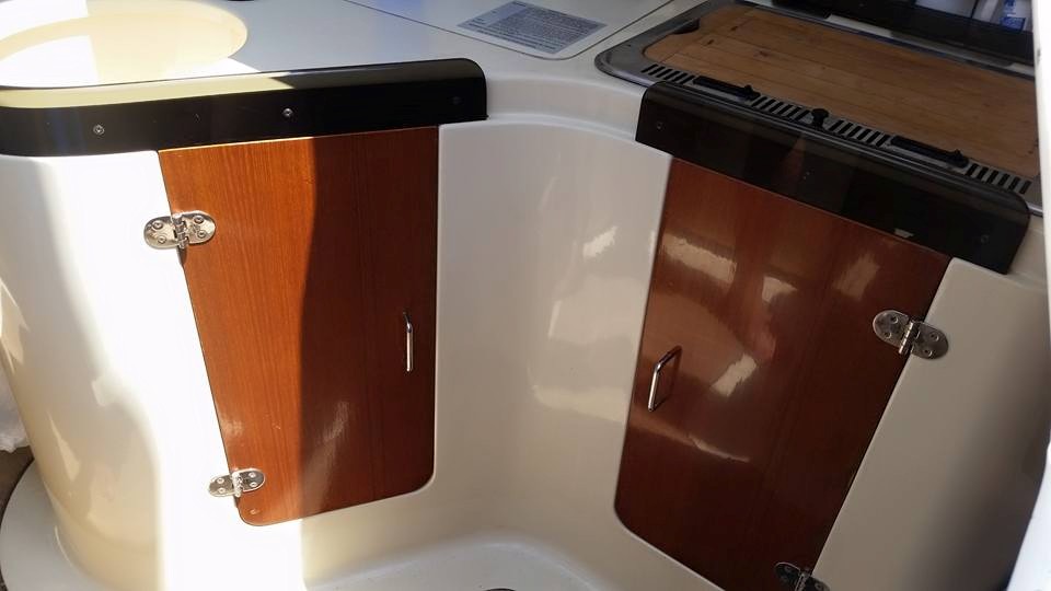

lastly, the cabinet doors, removed, sanded, 3 coats cetol, wet sanded and polished with high speed polisher. Turned out to be a lot of labor.
