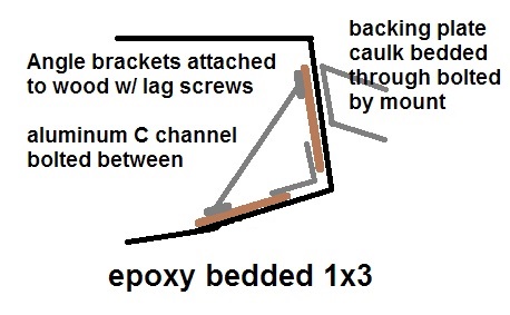

My 23 had a mercuy 2-stroke 9.9, it was overkill but it came with the boat. This is what I ended up doing before I was happy.
Afterwords, it was great while the boat's on the trailer. With the strong mount lowered all the way, it was my "Extra step" to climb onto the boat
