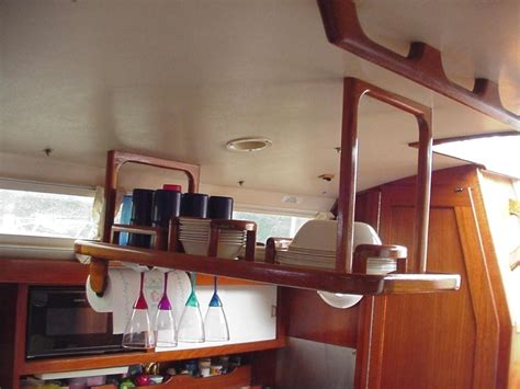

Hammock style hanging nets are an excellent way to utilize extra space. My boat has a hanging shelf similar to this.

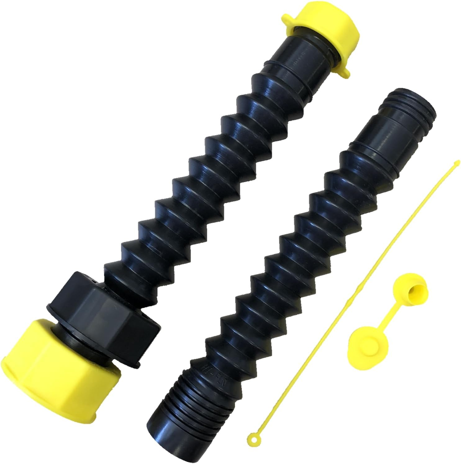

I found taller, narrower jerry cans take up less deck space and are easier to tie to life lines. I highly recommend flexible EZ-Pour spouts for your cans. It substantially reduces the chance of spills and makes it much easier to use. Using the long extension allows you to put the spout in the fuel filler hole before fuel starts to flow. They're $14 USD on amazon and well worth it.

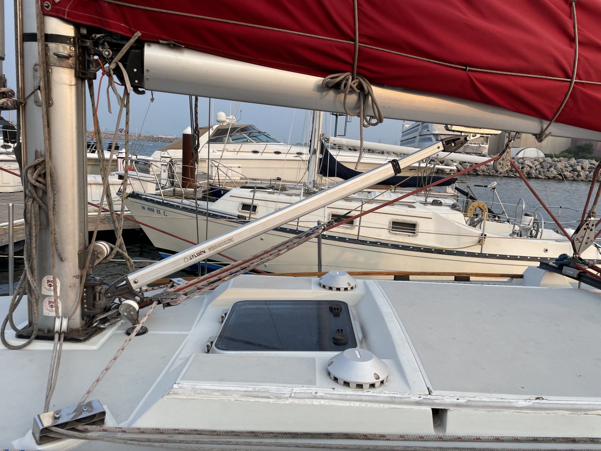

Boom Bang - I had a 6:1 rope vang and a topping lift. I found a used Seldon rigid vang (needed the spring mechanism replaced), and it is great. I no longer need a topping lift. Pricey, but worth it if you can find a used one.

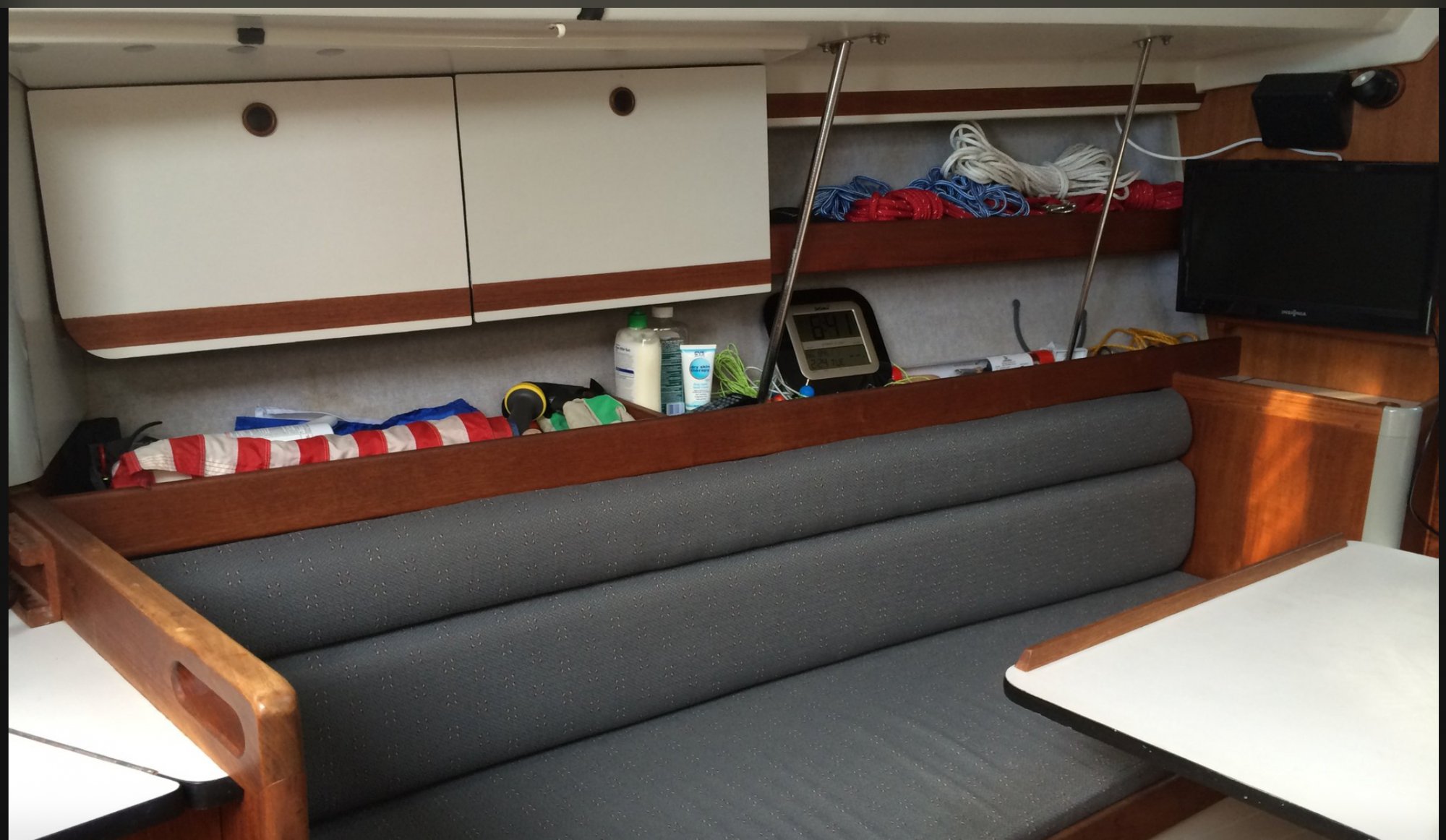

Storage - Tally Ho has some shelves along both sides of the salon that just collected lots if stuff. I bought small plastic baskets that fit along the shelf, and then I could organize the stuff into bins. Worked well.
IMG_4859.jpeg Before organizing…

If you mean why do we use a rigid vang, in my case, o wanted to do away with my topping lift when it interfered with my new mainsail (a bit fuller roach). A rigid vang supports the boom, so no topping lift is required.
