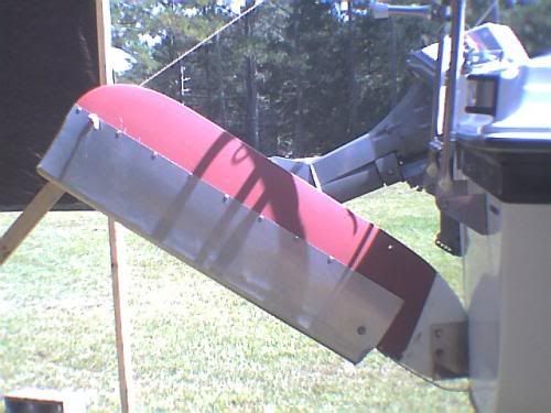

If you have this on your D then boxing will help the feel, You can just use a plate with screws also.

Thanks for the pic. Saves about 1,000 words right?
I was considering having a plate welded in just like this, but haven't seen pics of how long the plate can be without interfering with pulling the rudder up.
Is this one yours or somebody else's?
