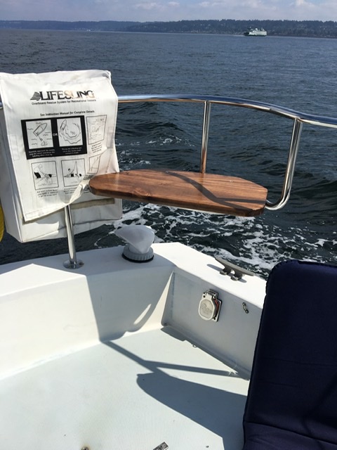

Hi Carmen. I found some step tread at Lowes. Cut it to size, stained the wood, then covered with epoxy, finally varnish to block the UV.
Turned out ok. Lasted about a year of exposure before I needed to sand and varnish again.
on the stern. Best seats on the boat.

Good question. My rails were made with 4 welded tabs. I drilled holes through the tabs and use 4 stainless screws. Up from the bottom.

Why would the holes need to be close together? They are not big holes. 4 widely spaced would likely not impact the rails strength.
My holes are through the tabs not the rail. If you no longer have tabs has the rail already been weakened?
My seats are nice but they are likely to be lost should a big wave hit the boat from the stern and lift the seat off the rail. If that is a concern then you can look at thru bolting the seats to the rails. In my sailing with this boat, so far, I have not had a big wave hit the stern and fill the cockpit. If that happens and the board is set adrift, I will just replace. The board and the varnish is less than $25.
