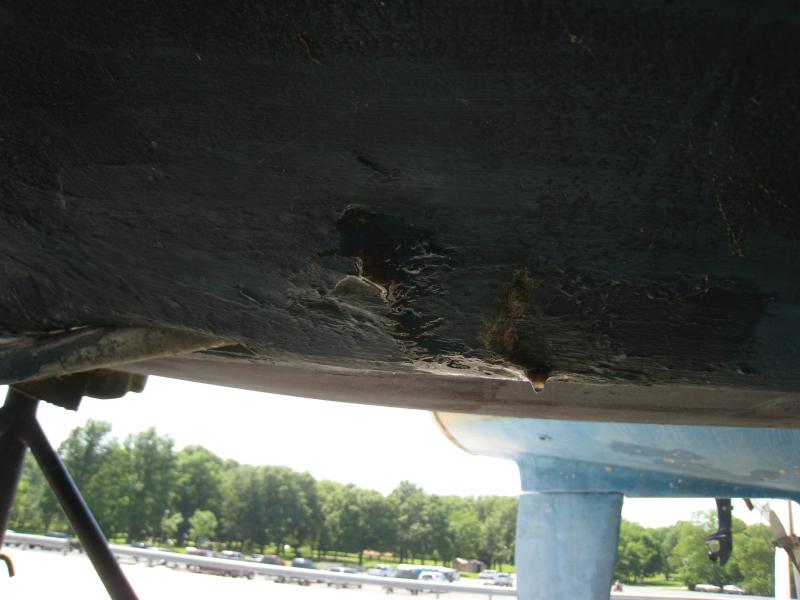

While inspecting the exterior I found what looked like a patch gone bad. Its location is about 6" in front of where the prop shaft exits the hull. I poked on it finding it soft and mushy. It was dripping water and a brown residue when I pushed on it. I called the broker’s attention to it and he pushed it enough to break it open. After breaking it open several tablespoons of liquid came out. He then started to rip the patch open more to expose a crack. This was apparently what the patch was covering and it turned out to be weak repair job.
Second, the prop shaft stabilizer arm had the same looking patchwork done where the brace meets the boat. There looked to be cracking in this location, too. My question – is this an area known for cracking? If these were cracks then the end result would be a leak inside?

That mushy spot should not be there, looks like trouble.
Water in the bilge can come from the mast, but if it is as deep as you say, looks like more trouble. Brown residue could be transmission fluid

If you have issues around the prop shaft and the hull is likely compromised, I'd pass on this boat. There are lots of Catalina 30's out there in pristine shape to choose from. You could easily be looking at 5k or more repairs on that boat on that one issue. Pass it up.

Pass on this one, you do not know what else is wrong here. Mine is an 88 as well, but was in very good condition when I bought her last year, even so I got her for less than book price.

The bilge water isn't a big deal... The cracked hull is a big deal... I would walk away from this one even if they lowered the price quite a bit...

Howeman- everything is fixable but at what price? The water in the bilge means you probably have deck/ mast leaks and need a new compression post block like me. The hull leaking probably would be a deal breaker for me unless it was dirt cheap. What book price are we talking NADA? BUC? There's a difference. For instance the BUC on my 1990 C30 was around 30k while the NADA was 24k- Guess which one the bank used?-NADA. For me though that was good because it got the price down to where I needed it to be. Other than the compression post block there are no other issues besides normal old boat stuff, new lines, leaky stanchions, etc

As a 1988 Mark II owner after what you describe, I would pass on this one........
That hull damage alone is enough for anyone to walk away.
Their are over 7,000 Catalina 30's out there so its not a rare boat! Keep searching for the right one and avoid broker pressures.

I agree walk. I think you need to look at many boats before you make a decision. Just looking at the rest of the hull in your picture would scare me.

Many here are discouraging you from going any further with this vessel and their advise is well founded. That damage is a costly repair in a tender area of the vessel and one particularly I would back off of. It may never be repaired right. As you learn about certain Catalina 30 issues going through the earliest to newer models this kind of damage is very rare indeed. In the 40 years I have owned sailboats I have never seen anything quite like this aside from a rudder and skeg being ripped off. If you like the Mark II you would be better off searching for the right one even if its not local to get the best boat for the money.

Run don't walk away from this one! there are well over 3000 catalina 30's out there. I owned 3170! :) and loved it. the hull damage is really bad. The amount of water in the bildge can come from many sources inclunding that the shower drain into the bildge. BUt the fact that fuel in in there also?!? Might have been a sloppt job of changing the filters? Theere are a lot of CAT 30's out there priced right and in good condition.
