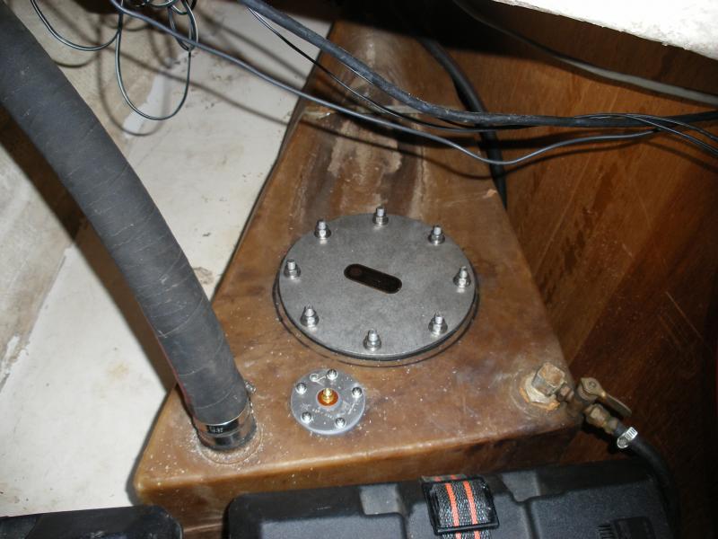

The safest way to put an access port into your fuel tank is to use a product made for that purpose. Other solutions may work but would give insurance, CG, and surveyors heart stoppage.
Once you have an opening, you can install a tank sender with its appropriate gaskets and be safe all around.
See pix on my H34 installation...

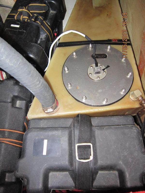

Wufibugs Iunderstand your points about "love to have the wallet required to follow that rule" & "have to look at alternatives that are both safe and affordable". In trying to achieve this however as Dan says you need to also look at what CG, and surveyors have to say and what it does to your insurance policy. I found that after evaluation the easiest and cheapest for me was to go with the Seabuilt unit. I did install the fuel sender in the middle of it. Good luck
