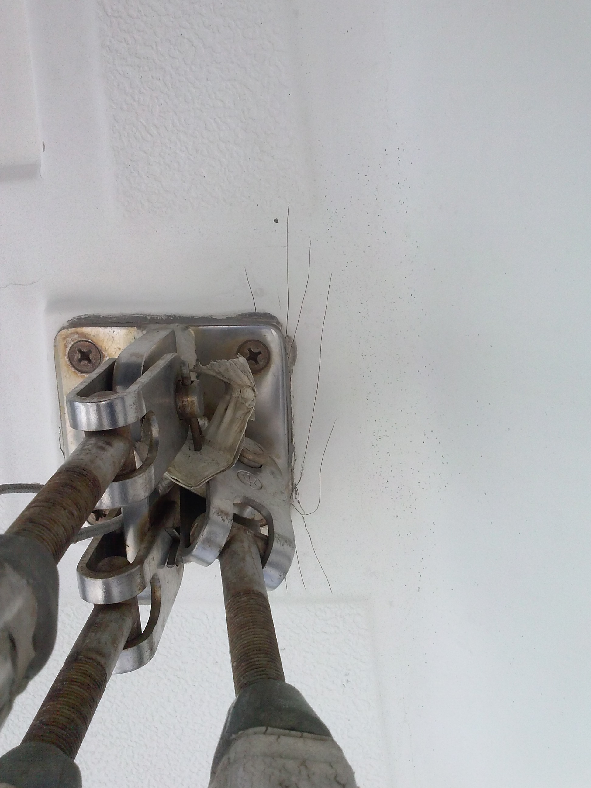

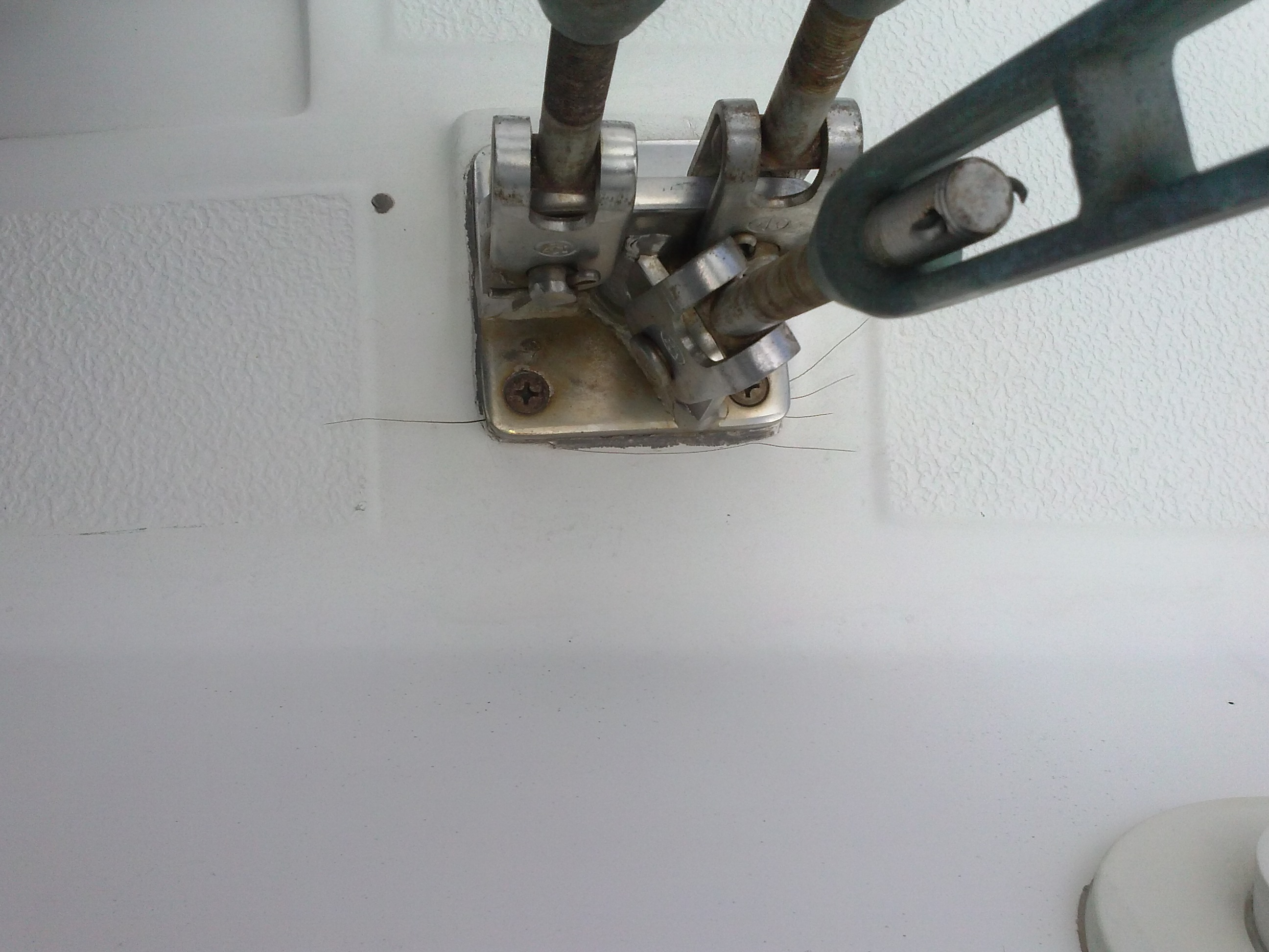

Attached are pics of the chainplate mounts that have small cracks on the glass surrounding the mounts.

- The cracks you show in the pics are called 'spider cracks' or 'crazing', this is where the gelcoat cracks when the fiberglass flexes under it. You'll find this most often in high stress areas. The fix is to grind out the crack with an engraving bit on a dremel tool, then fill the crack with color matched Spectrum Gel Paste (about $25 for a 2 oz jar, a little goes a long way).

Agree with Clouddiver... I had those spider cracks eventually show up on my Hunter and I used a V-shaped stone to my dremel tool to remove a fair amount of each crack and filled them in with new gelcoat filler, sanded smooth, primed, then painted the entire deck.

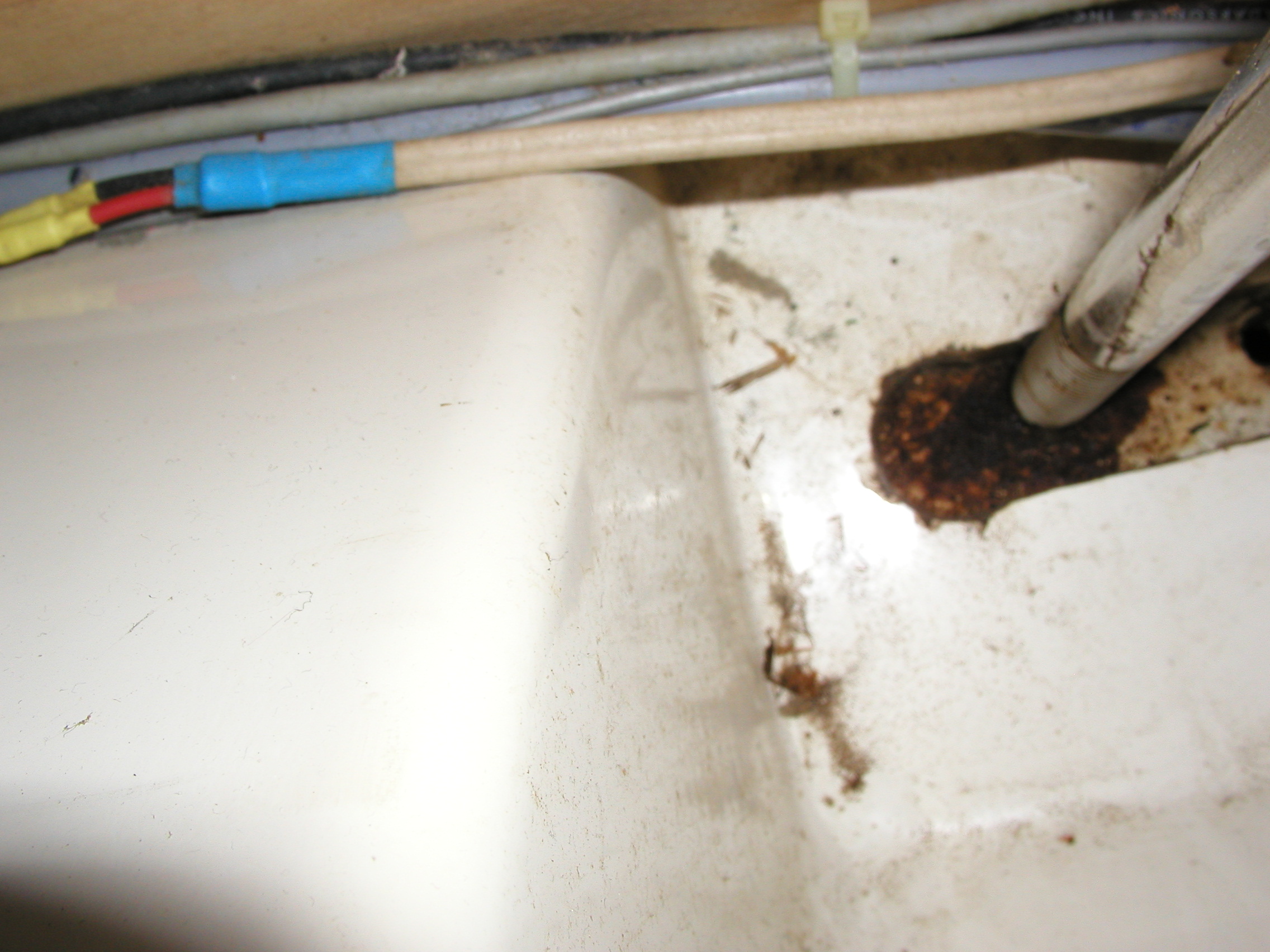

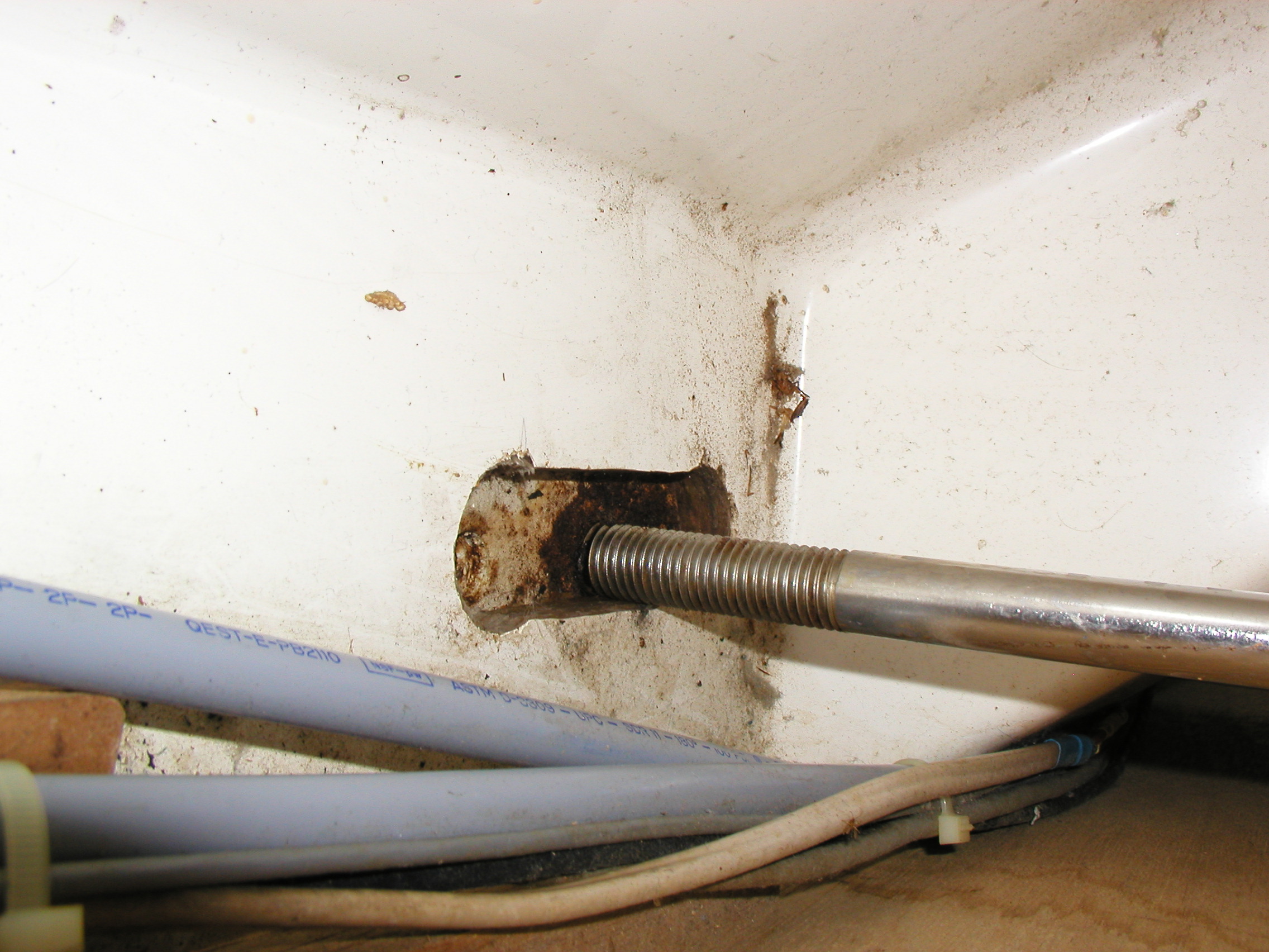

Those spider cracks don't look bad but be sure to carefully inspect the tie rods that connect the plate to the angle iron in the beams behind the settees.. P1220761.JPG P1220755.JPG
There may be a little rust on the carbon steel angle iron anchor that the rod screws into, but a lot of rust is not good.
