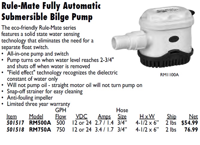

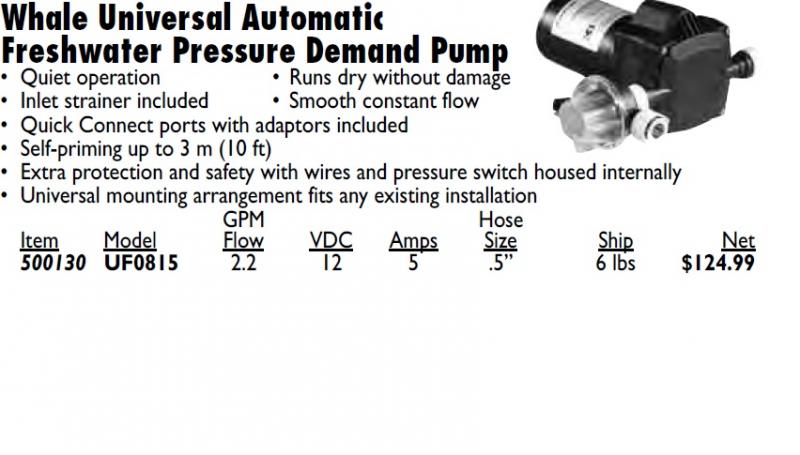

Chase, Might I suggest the Whale model #UF0815 freshwater pump ? ...from www.Defender.com page 100 of their catalog, see attached. It is self-priming up to 10 ft, draws only 5 amps, can run dry..no problem, and is moderately priced.
And a Rule 'auto' pump, ...from www.Defender.com page 99 of their catalog...see attached also.
