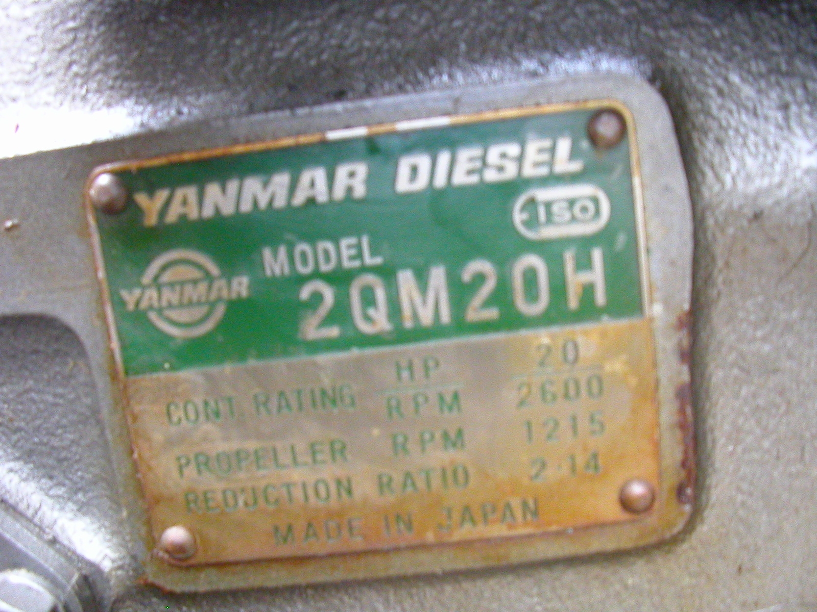

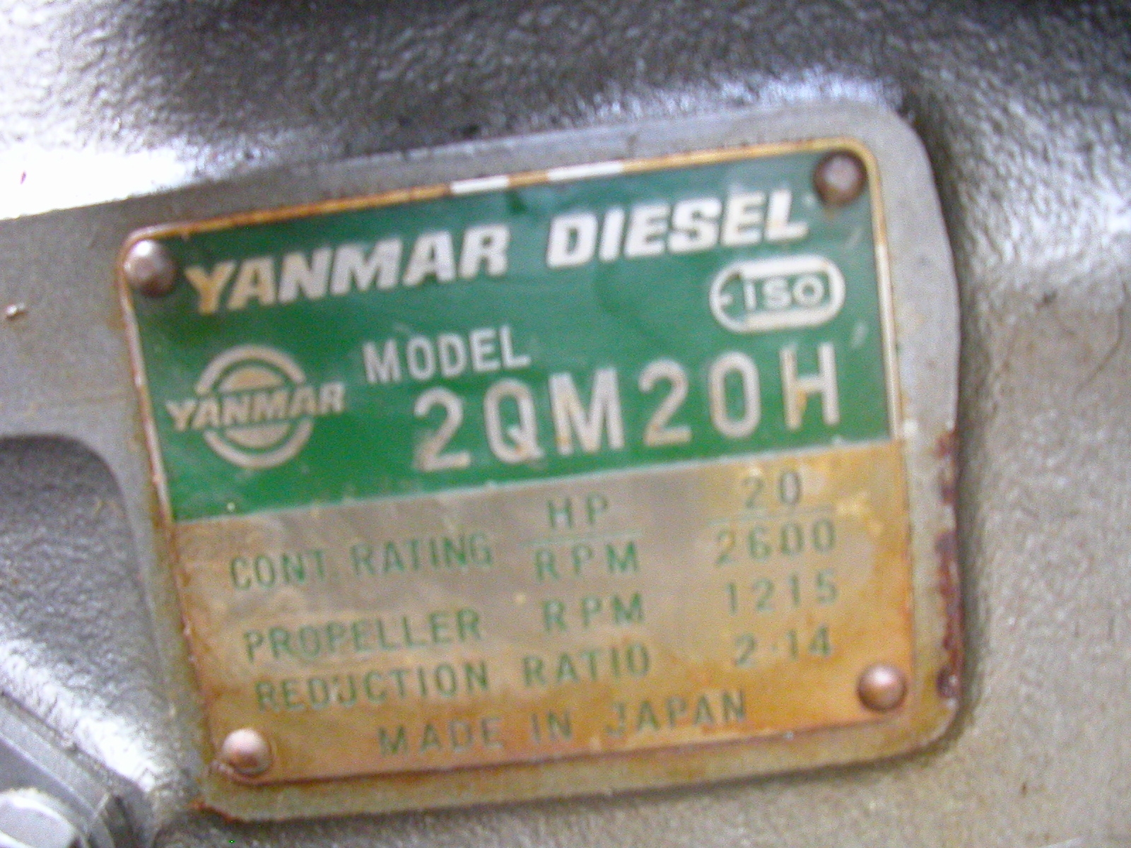

I had not experienced this until this last weekend when I pushed my engine to about 2500 rpm for 20-30 mins. Typically I have run at about 2000 rpm when cruising with no alarm. Our 2QM20 models are rated at 2600 rpm. See nameplate photo attached. My understanding is that continuous running of about 80% of max is ideal.

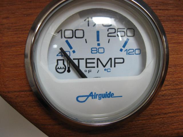

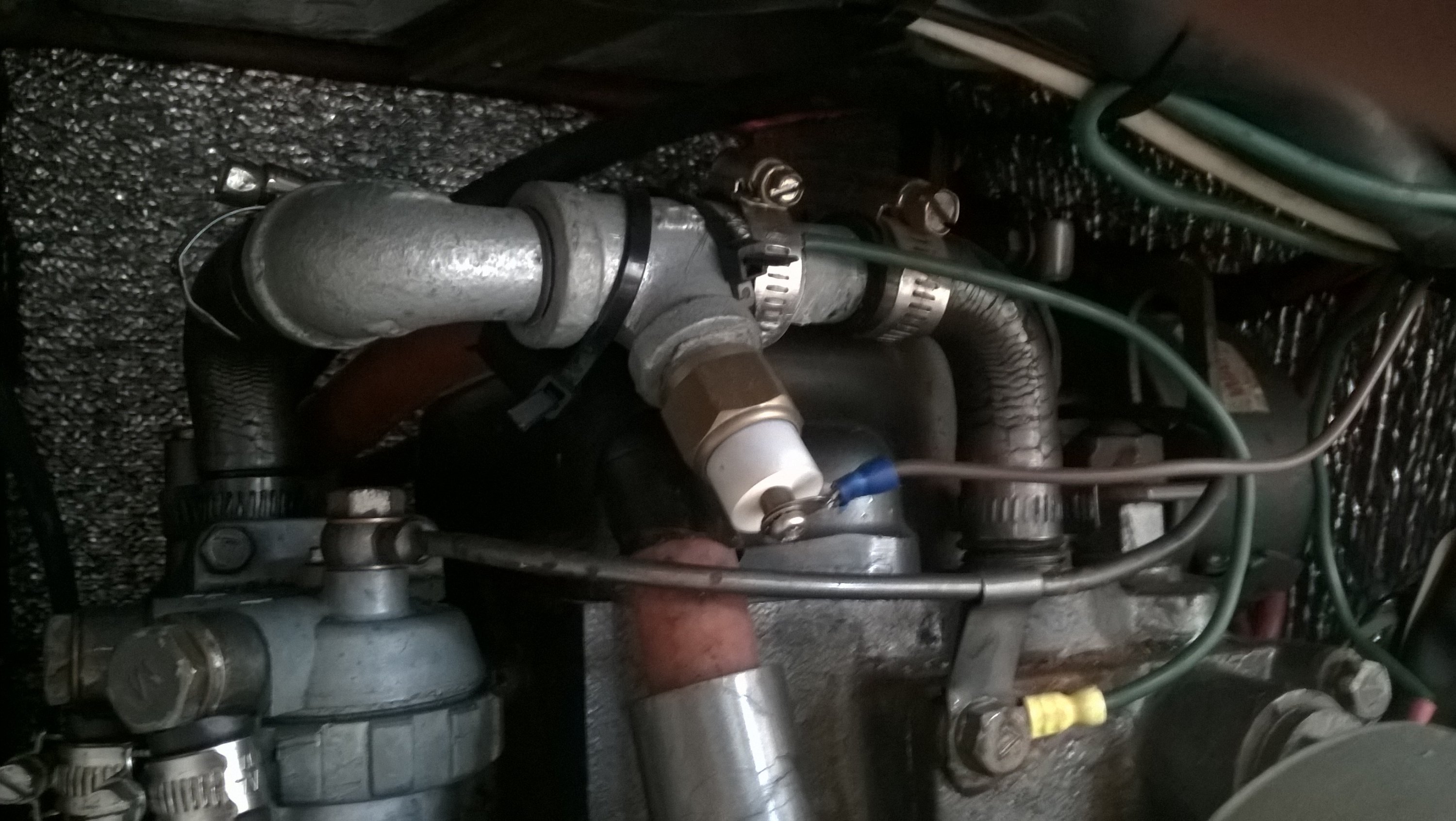

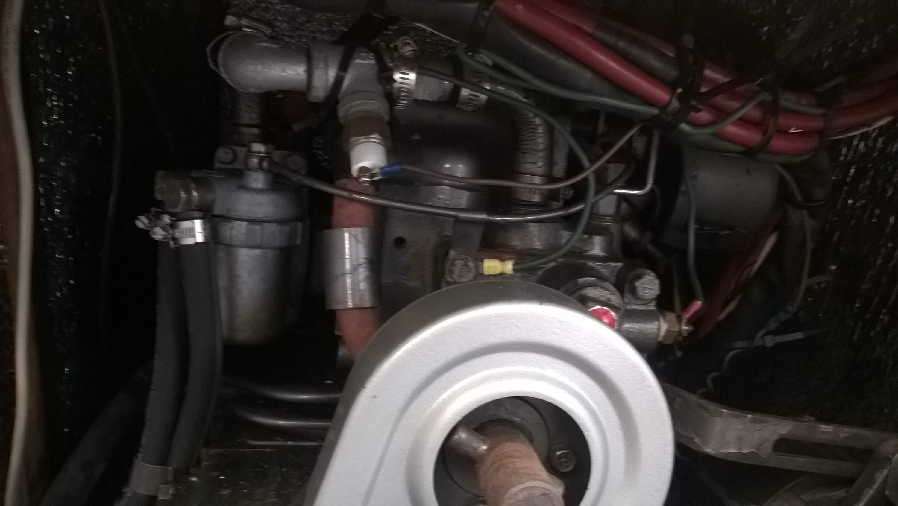

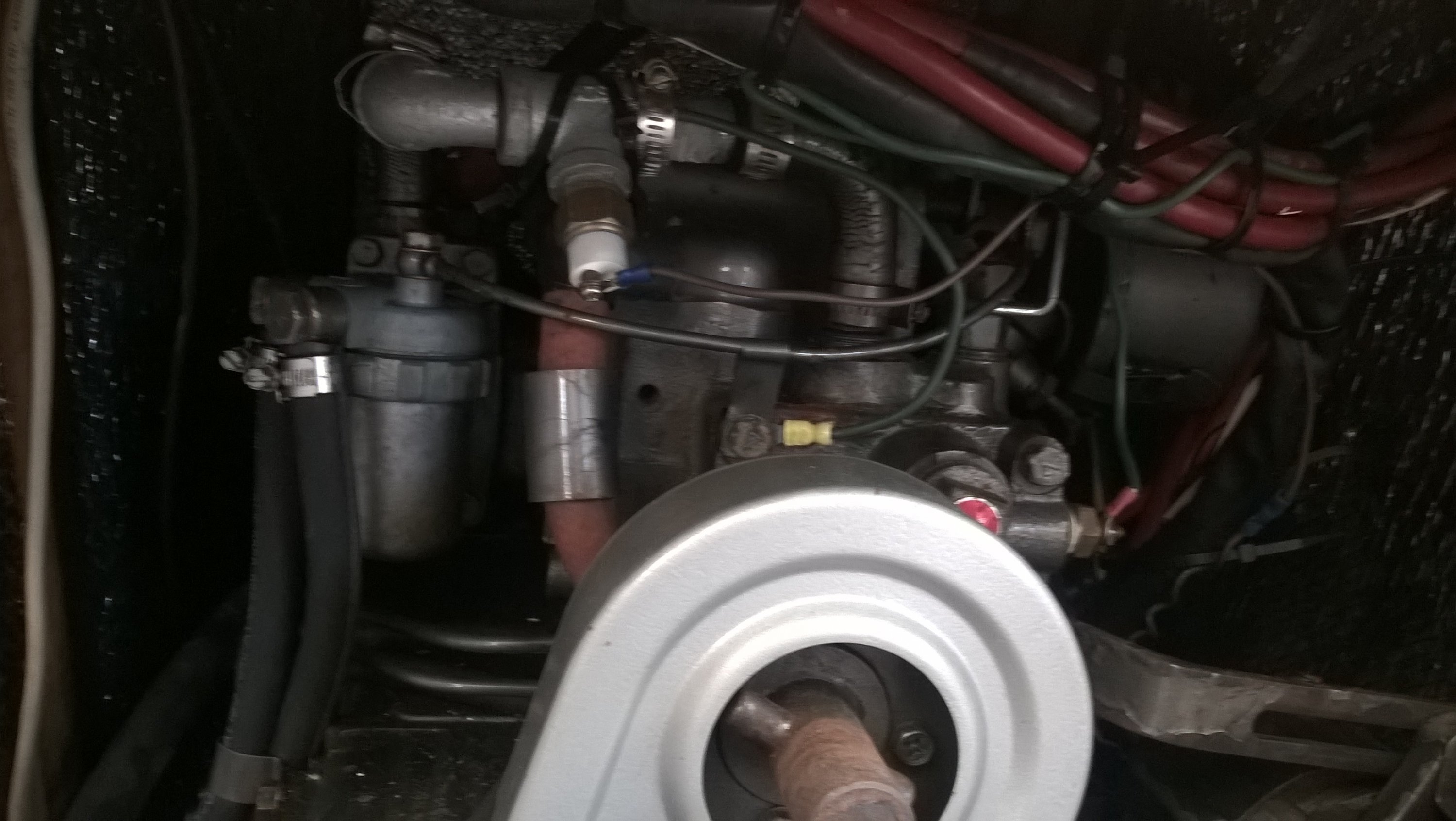

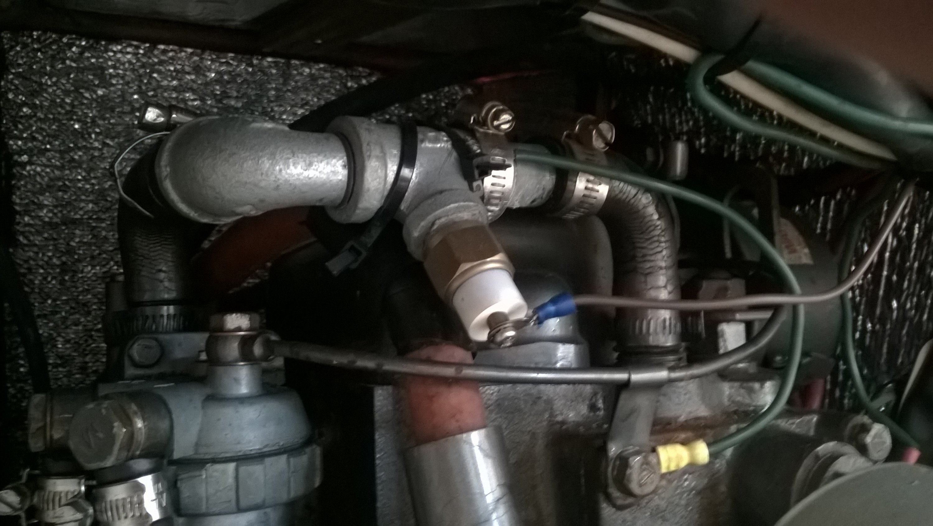

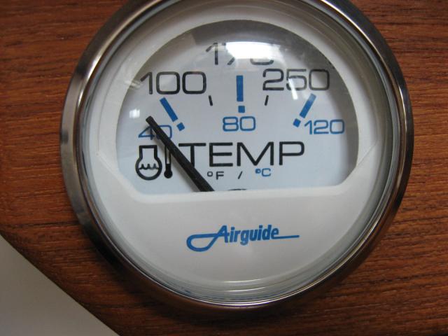

For anyone with a water temperature gauge, how have you installed it/what have you used? Please see the attached pictures which I took yesterday. I mounted generic temp sender in the rubber coolant hose leading from the engine block to the thermostat housing. It is fitted into the threads of a common galvanized T-fitting available in the plumbing sections of most hardware stores. When I bought my boat, the PO had mounted a nice gauge set in the nav station area. But had not installed/connected from the engine. Nor did the PO buy a sender for it. I bought a generic temp sender off of eBay to get it working.

Regarding where to install an additional sending unit: Your original salt water cooled engine has a zinc on a plug near the alarm sending unit. If your engine is now fresh water (coolant) cooled you no longer need the zinc. I drilled and tapped that plug to accept a gauge sending unit. That puts the gauge sender and the alarm sender in the same location. Not that this would apply to most people, but my hearing is not what it used to be and I sometimes cannot hear that alarm sound. As a precaution, I added a boat horn to the alarm sender to ensure that if it ever went off I would hear it. That alarm will wake the dead.
