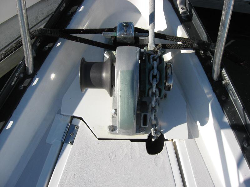

Below are pictures of the anchor windlass installation on my particular 80-82 Hunter 36. The mounting design was by someone else prior to my ownership, so I really can't comment if it is strong enough or not.
The installation needed work when I bought the boat. The windlass was mounted on a piece of standard grade 3/4" plywood which had largely lost any integrity. The white replacement piece under the windlass is Corian plastic.
The two forward bolts go completely through the deck with a backing plate underneath.

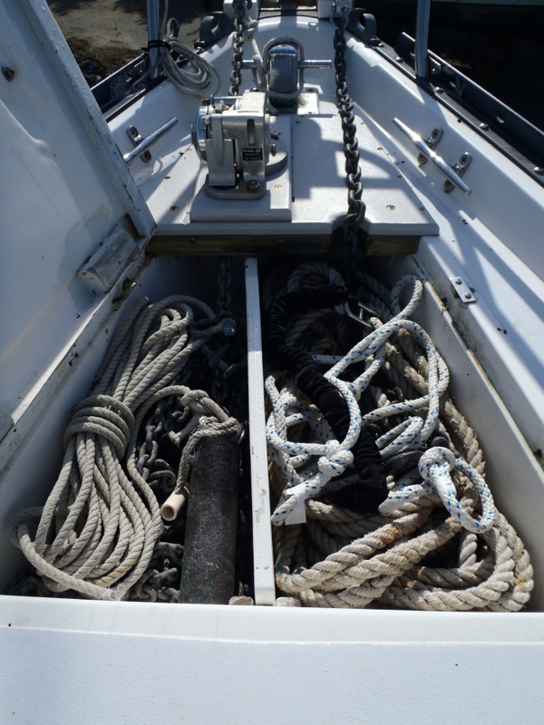

The two aft bolts go through what used to be the most forward end of the opening anchor locker hatch. The PO separated that section from the rest of the hatch. Then it was epoxied solid to the sill to provide a rigid platform for mounting. See the picture which was taken from the anchor locker aimed back underneath the windlass.
The setup does work ... although I must confess that I don't anchor much. The main problem I have had is that the notch that was cut-out just aft of the windless for the chain to drop into the locker is a few inches too far aft. When the anchor is lifted, the chain feeding off the aft side of the windlass needs a more vertical drop to seat better in the chain groves of the windlass. I do have room to move the cut-out forward. Just haven't got around to it.
Just one way of doing it. Hope that this gives a springboard for variation on the theme.

Rardi - the H36 anchor locker looks very similar to the H37C locker. Do you think it is deep enough at the aft end to mount a windlass in there? I am sure windlasses last longer (esp. electric ones) if they are out of the weather. Of course, the down side is that then you have to convert some area down below into a rope/chain locker...
Jun 2, 2004
5,802
From the picture of the v-berth in the other thread I think a locker install might be hard. It looked like the aft end of the anchor locker was actually in the v-berth. So the chain, if dropped near the back of the locker, would be on your toes. Maybe that is not the case, just the look from the photo.
Jun 21, 2007
2,118
Ed: Not sure if the aft end of the locker is deep enough to accommodate a windlass. I think so though. If a pipe was extended down, the chain/rode would drop either into the space just forward of the decorative bulkhead just forward of the v-berth cushions. Or the pipe could continue into a locker below the v-berth. Neither of these locations have natural drainage into the bilge. So drain holes and water routing would need to be added so that any wet from rode/chain or anchor locker spilll-over would flow into the bilge.
Anyway, its all moot for me and my my particular boat. The windlass is already mounted. The chain locker hatch has been cut into two pieces and the forward piece hard-epoxied in place. I don't anchor too frequently and when I do it all works. So status-quo will prevail in this instance!

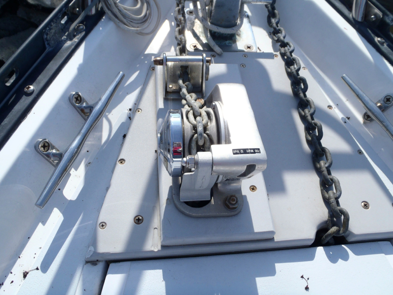

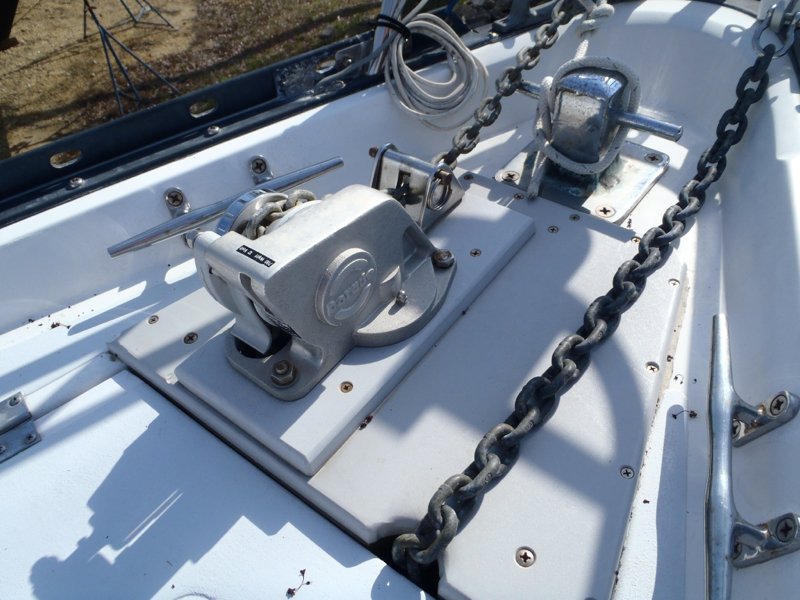

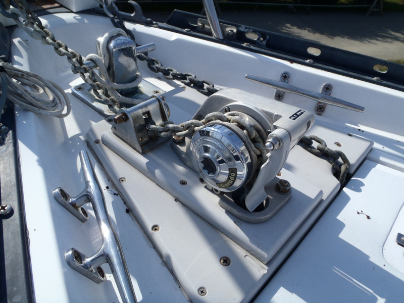

Here are some pics of the installation my father did a few years ago...1982 H36.
We have a 35lb delta anchor on the windlass on the port side and a 12 lb. Fortress on the stbd. side. Seems I use the Fortress more often in the Chesapeake.
