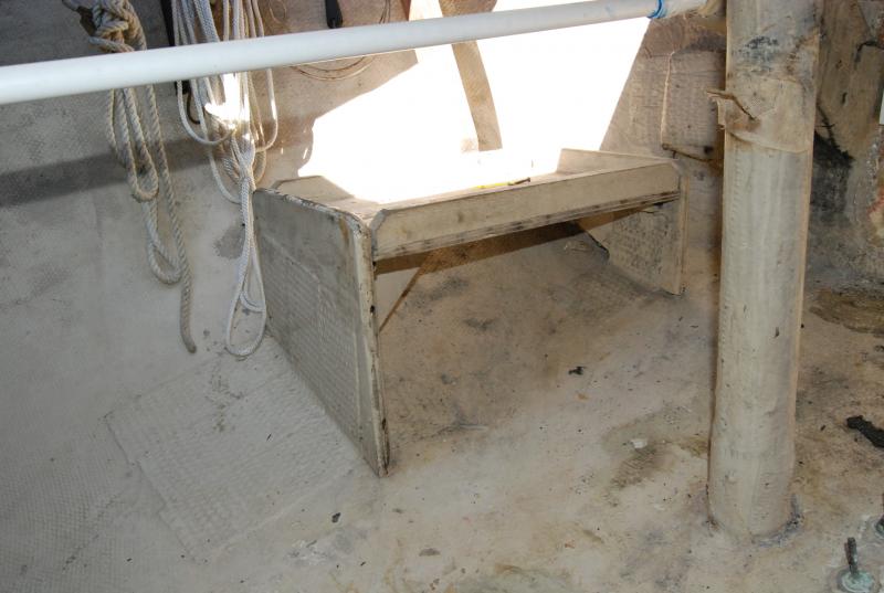

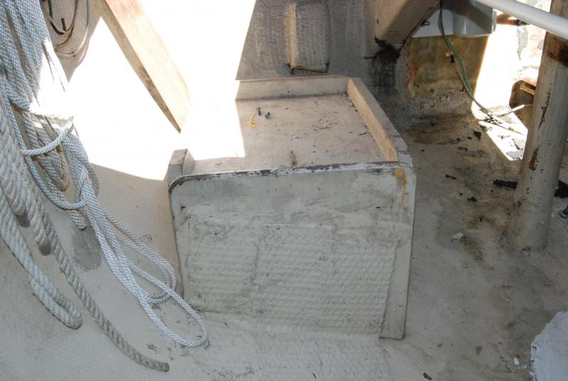

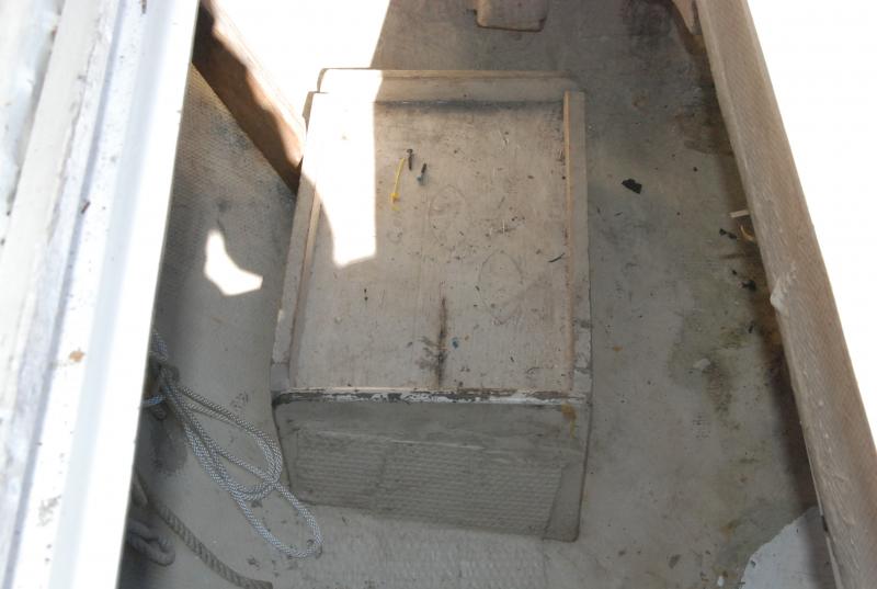

I've been curious about this structure located in the starboard aft corner under the settee since day one. It looks to be for a holding tank or maybe a tool box. It was built by S2 when the boat was made and its built very sturdy.
I was thinking about using for my toilet holding tank but its a little bit high for that. I think the holding tank should be even or slightly below the toilet itself so I don't get back flow.
If anyone knows what the purpose of this structure was intended for, please share.
Thanks!
~John

Another clue is that piece of hardwood glassed to the inside of the transom just behind this structure. You can see it in the pictures. What ever its purpose was it seems to be for whatever sat on this structure. Though the block glassed to the transom has no screw holes in it and looks like it was never used.

that is for an outboard fuel tank !
Tom
That sounds like a matter of fact. That would make sense though. I believe one of those old metal OMC 6 gal tanks would fit right in there with that said however, i'm going with the beer cooler idea above;)
Thanks Tom!

Assuming that the boat has an outboard engine and "starboard aft corner under the settee" means in a locker under the cockpit seat; the structure is to hold a the outboard engine's portable gas tank. Should that be the case: 1) the portable tank needs to be secured in place (not by bungee cords). 2) the compartment needs adequate passive ventilation as portable tanks vent at the tank. 3) the compartment should not; contain any electrical equipment - switches-batteries etc.; open into any interior space or any space containing electrical switches / equipment. 4) feed line (tank to engine) should be protected from chafe-strain-wear.
The following is a section of ABYC standard H-25 PORTABLE MARINE GASOLINE FUEL SYSTEMS
Frank (marine surveyor NY)
