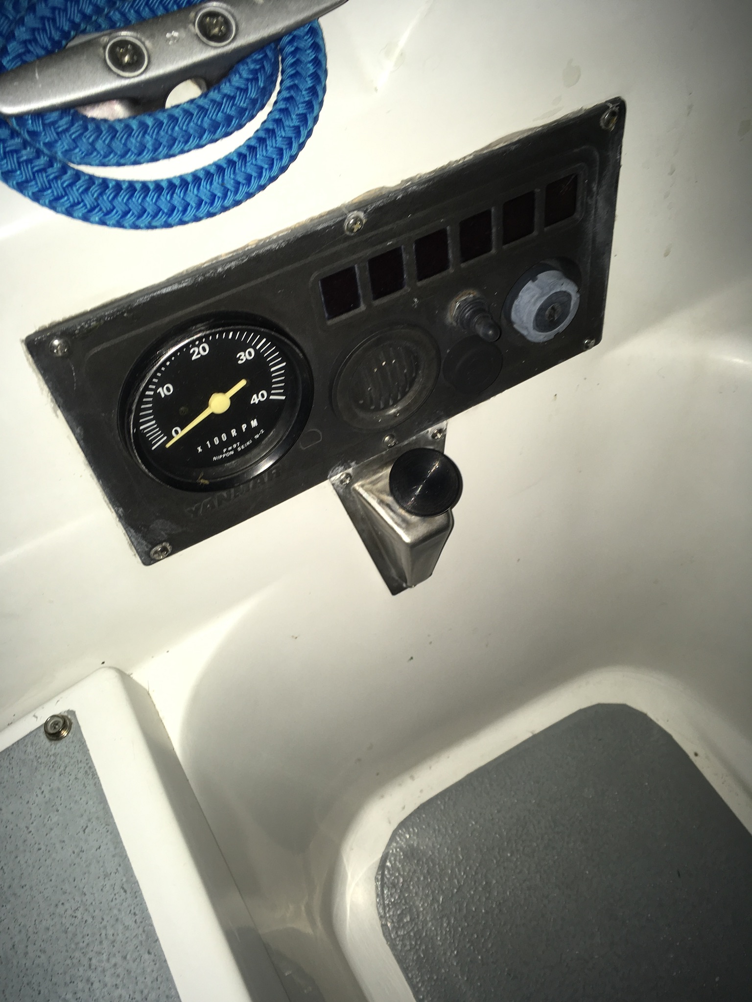

Sorry I don't have a more specific image, but the stop engine cable on my '81 H27 is mounted below the control panel. The metal holder is riveted into the fiberglass.

The later Hunters seem to have a much better panel installation. The Panel is recessed and covered. Still, I see no logical reason why the shutoff is installed beside the companionway steps.
Do you ever see corrosion or crud behind the exposed flush panels?
Jan 24, 2009
450
1981 Cherubini Hunter 27 Shipwright Harbor Marina, MD
@Justin_NSA: "...why the shutoff is installed beside the companionway steps."
If that's my photo you're referring to, it's actually in my cockpit, I should have mentioned that in the post. You have a good point about the later installations, it is pretty exposed like this.
8,469
Sorry Dan. I was referring to my setup. While the panel design is great, the shutoff location is illogical. I like where yours is located. Maybe Hunter moved it to keep it out of the weather.
Jan 24, 2009
450
Yes, inside would be protected, but inconvenient. I know some parts of these boats are added by the dealer at commisioning, I wonder if it's the same with the shutoffs.

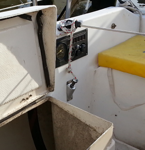

Oct 6, 2007
1,109
Hunter H30 1982 Chicago IL
Dan, The panel and shutoff on my '82 H30 are in pretty much the same location as yours; starboard side of the cockpit. Seems like a logical location, though I have wondered why the shut-off couldn't have been integrated into the engine panel.
Jan 24, 2009
450
Yes, that and an hourmeter. It’s either a cost-saving thing or because the engines are used in other ways.

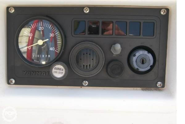

I ran across this on the Internet and thought post it as an alternative spot to mount a stop engine cable. (It's just below & right of the tach, if it's not obvious)

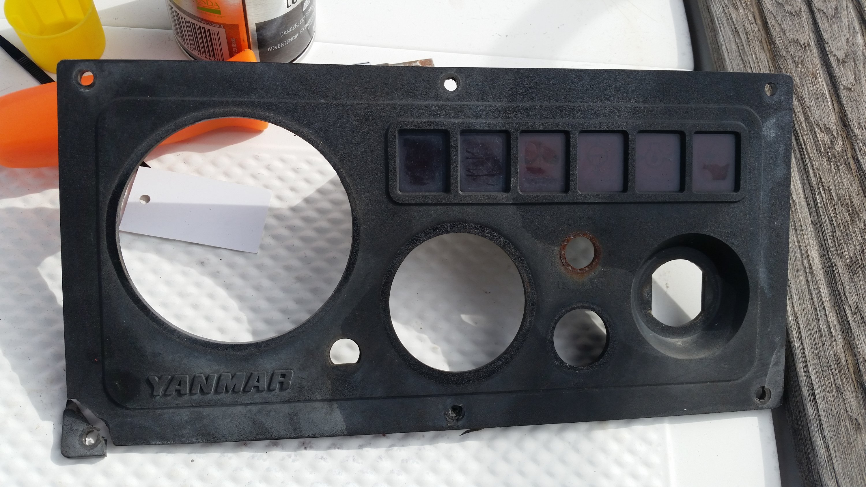

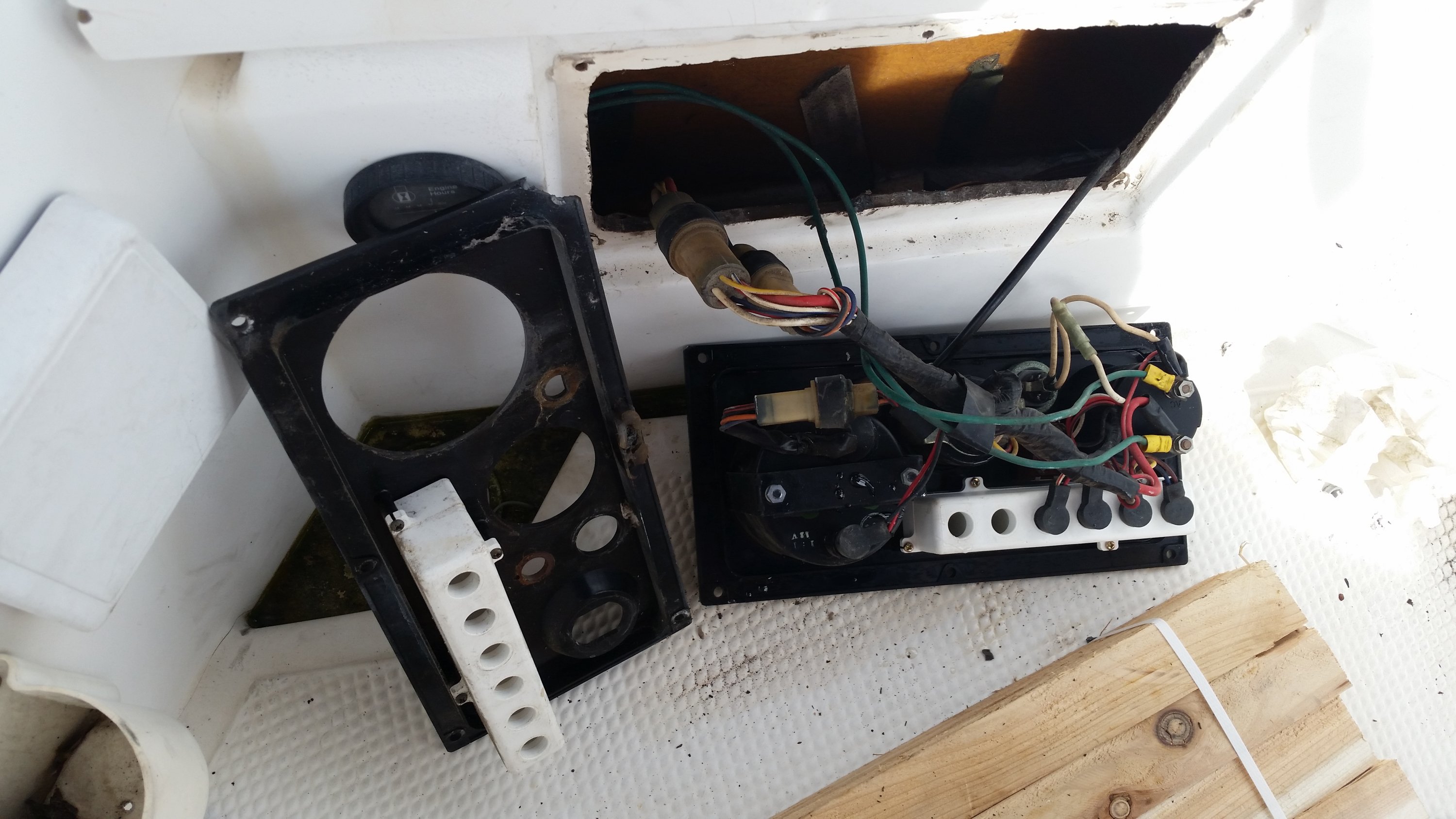

I swapped the panel on my 2gm.
Swapping the panel.
Old cracked panel
New panel Installed
I believe I bought the replacement from Toads Marine. ≈ $29. Engine shutoff is in the panel, but brace the panel with one hand before pulling the shutoff with the other. That stress is what broke the corner off of my original panel.
