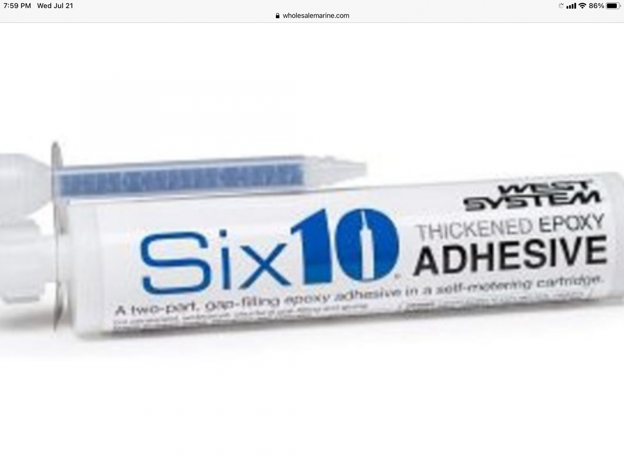

I had a void under a PO-added midship cleat…not sure why it was “hollow” under the top skin, but when I tried to chamfer the holes a little to rebed with butyl tape, I punched right through the skin.
I removed the cleat, drilled out the holes a bit, and filled as much of the void as I get with West Marine Six10 thickened epoxy in the dispenser tube…just kept squeezing it in until I couldn’t get any more into the void.
Once it hardened, I redrilled the holes, chamfered them, and reinstalled the cleats…
Luckily for me, the cleats cover the holes, so nothing is visible.
