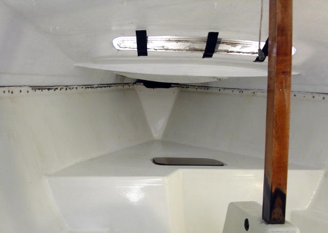

(To recap: she sat at mooring in seawater for a long time; and has been on a trailer since 2008. The hull was severely blistered below the waterline; and the interior showed the usual: water, dirt, leaves, etc. It was pretty awful inside when we got her.)
Since basically everything's there, our first two concerns have been restoring the outer hull and inner cabin. We want her seaworthy, but also clean inside. When I can, I'm working on the hull during the day; and on the inerior during the evening when the temperatures go down a bit.
Today, the work on the hull is progressing. I'm still repairing blisters; undoing unacceptable automotive Bondo repairs done by the PO; our Tuff Stuff Epoxy Primer arrived yesterday; and today we ordered our ablative top coat from the Bottom Paint Store. There's still considerable work left to do, but it's working out nicely. Thanks to all here for their help and advice.

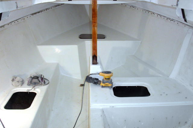

In the cabin, we'd removed all the stashed components and bulkheads; vacuumed out the debris; washed her down inside; removed stubborn "substances" and stains using everything from bathroom cleaners to acetone; and after all that, we're happy to say the original gel coat is in pretty nice condition. Still shiny in most places.

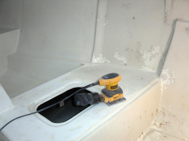

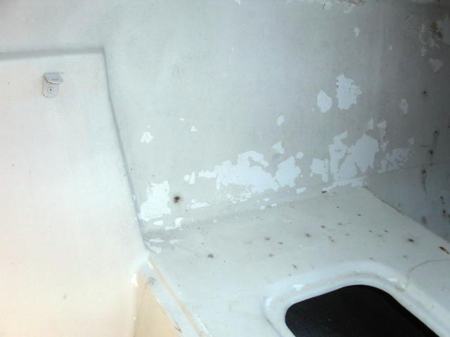

The worst part of the cabin now is the starboard seat / table area: someone painted that a flat tan, and it's peeling off in many places. Have also found a few small wet blisters that need attention.
So, I'm in the process of removing the old paint and fine sanding the gel coat where necessary. In most areas, and especially on the textured "tread surfaces", I'm finding that paint remover and soft plastic squeegies or brushes are taking off the paint while leaving the gel coat intact pretty much intact. Will probably top with good primer and paint.
Here's some pictures I took today, to show how it's coming along. Aloha!
