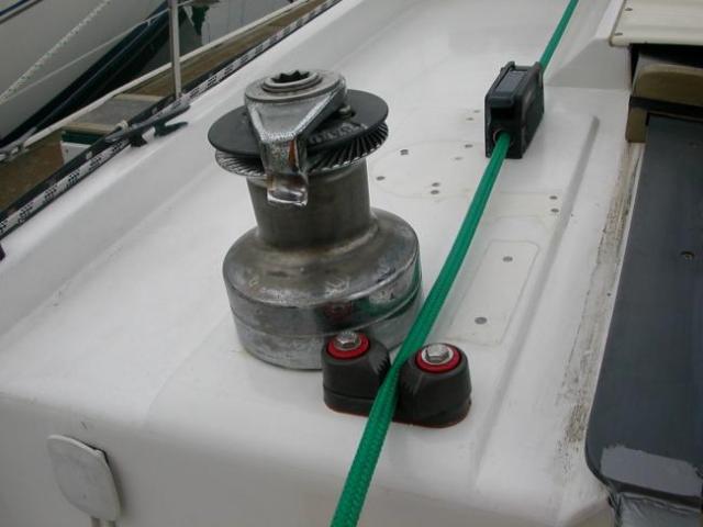

Here's A Pic From a 1980 Cherubini H36
The attached pic may give you an idea what the raised area looks like (this from a 1980 Cherubini Hunter 36).
Even without a raised area, it doesn't do any harm to drill as others have suggested a (say 1/8") pilot hole in the same area where my raised section is (its the same on both port and starboard on my boat). Its still possible that Hunter put in an aluminum plate without raising the area. There is an appx 1/4"-3/8" void space between the deck fiberglass and the inner liner for an aluminum plate to fit. If you don't find the aluminum, simply fill the exploration hole with epoxy being careful to be neat. Then a little white paint and no one will ever notice.
