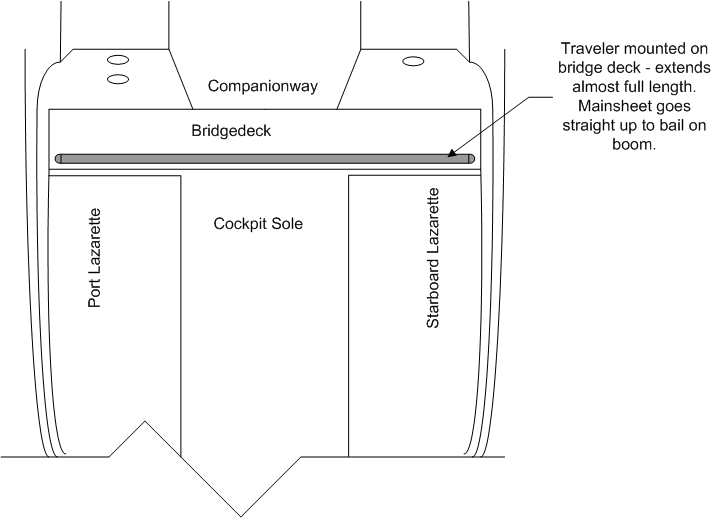

Quick drawing
I don't have any detailed photos of the traveler to send today, but I'll try to take a couple for you this weekend. In the meantime, here's a quick sketch I made of how the traveler is installed on my '79. The traveler is a standard, off-the-shelf unit, probably cut to length. Mine has the spring-loaded plunger type stops on either side of the traveler car. The track itself is mounted almost flush with the aft end of the raised bridge deck between the cockpit and the companionway. It extends athwartships to within about 1 inch away from the vertical sides of the coaming. This is to get maximum travel side-to-side. When the mainsheet block is shackled to the traveler car, the mainsheet is straight vertical up to the boom bail. See attached drawing...
