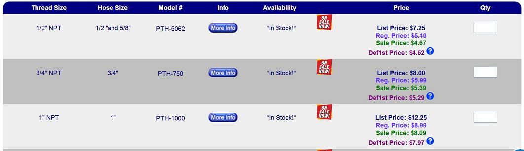

I don't think you'll have a whole lot of luck as 7/8" doesn't exist. Barbed fitting sizes (from 1/2" to 1") are 1/2", 5/8", 3/4", 1". Here's a list of NPT X hose adapters from Groco Marine:

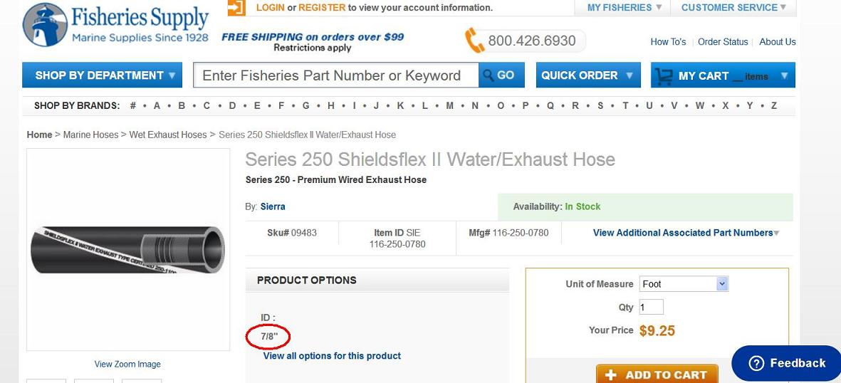

Folks, I appreciate all the replies, but I have spent quite a bit of time using search engines and checking online marine chandleries as well as McMasterCarr, Grainger and many others. The Universal diesels use a heat exchanger with 7/8" hose connections. The hoses are Shields 250-0780 which is a wired heater hose with an ID of 7/8". It is hard to find but is available. I actually just went to the Toad Marine Supply website to look at the schematic of the heat exchanger to verify that it is 7/8" and stumbled across a Westerbeke nipple that goes from 7/8" hose to 3/4" NPT which I can easily adapt to the 1/2" I need. At $45 each they are a little spendy, but looks like this will solve the problem!

But aside from that insanity, @Sefuller , is quite right. Shields does make a 7/8" ID hose:
