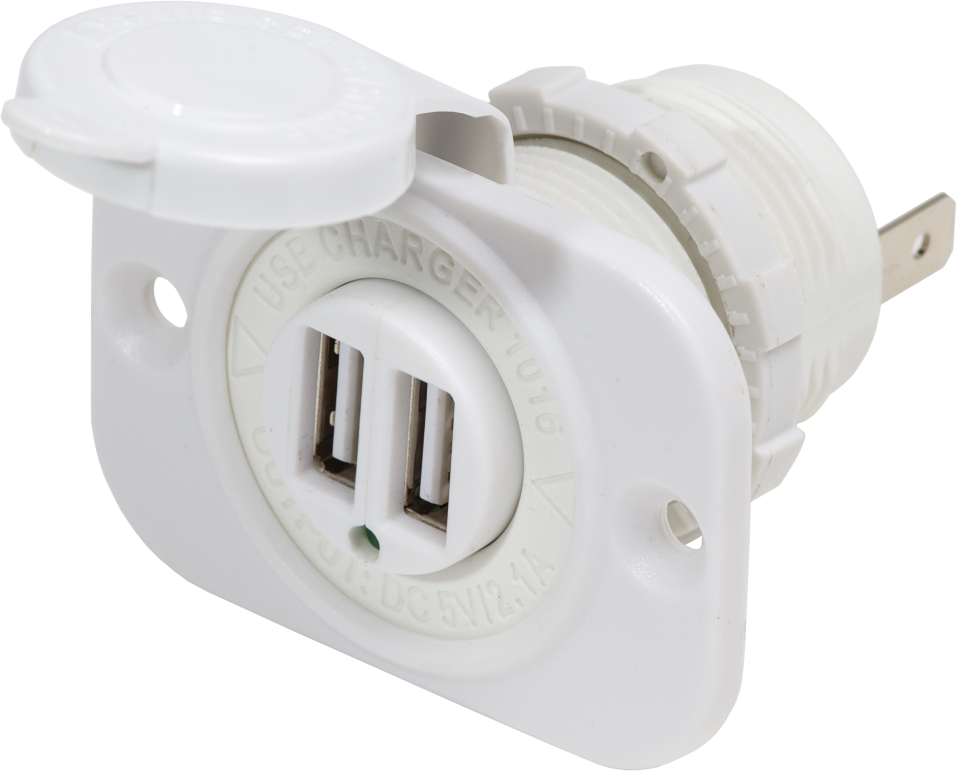

I have a usb charger socket for waterproof bulkhead mounting from BlueSea Systems. I will mount this inside the port side cockpit cubby. Any phones or other devices that need charging will sit inside the cubby when doing so, the cords are usually short anyway. This is also a great place for my music system which is a JBL Charge 3 USB speaker.
I also have another one of these to mount in the cabin on my new DC panel, right next to a standard 12V charge socket. There will pic of all this in my resto thread when I finally get around to installing it all.
