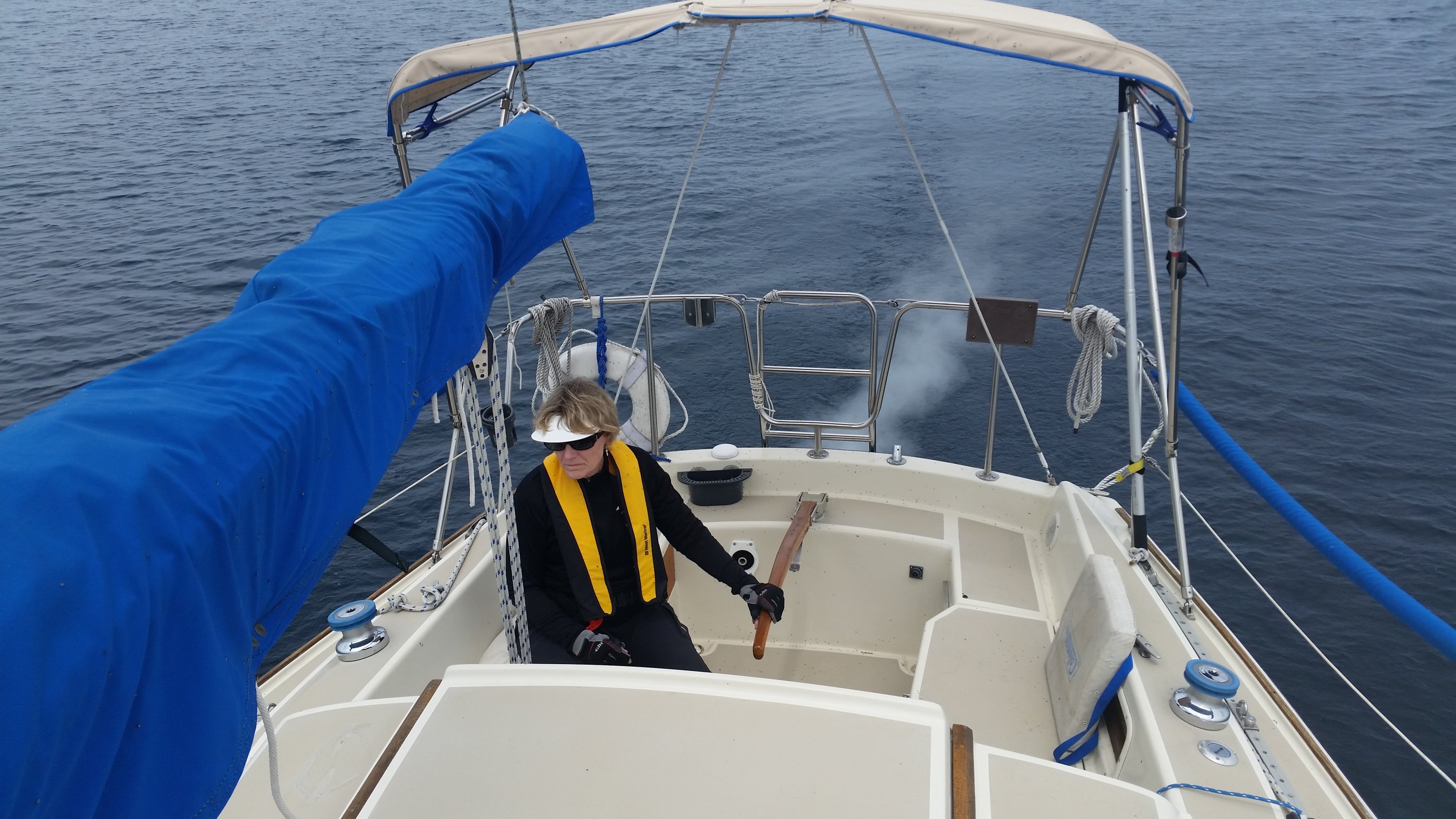

I have read the numerous forums and I can not decipher if the behaviors of my 5411 is normal,or not. 1983, 28' O'Day
What it is doing: wet water is coming out of the muffler but not in volumes as I see with other boat brands. A white smoke appears,heavier as I throttle up.
History: Hours on engine are just over 1k, I am the 3rd owner and it passed inspection with flying colors,use the boat in the Great Lakes (fresh water), fresh water cooled engine-not a closed system, diesel, fuel always bought at reputable marinas who treat their fuels, fuel always topped off to keep full and lessen the condensation, I change the o rings yearly on my fuel cap, I treat the fuel with Cetone Boost and Star Tron fuel treatment, change the fuel filter yearly in the fall when winterizing,change the fuel separator, change the impeller e/o yr but have it ck'd yrly, engine operates near 135, I routinely run the engine at 1/2 throttle (I do not have a tachometer) after it is warm as many articles have suggested, 2 blade prop.
Is the white smoke indicative of moisture being in the fuel? Does anyone suggest using Soltron to rid of possible moisture? I have read all possibilities for this white smoke & lack of large water volume secretion...poor fuel injectors, clogged muffler, need to get my fuel polished,etc. Seriously, the engine seems to run fine and temps fine but....are these signs of a more serious problem, when I will REALLY need the engine in a Lake Michigan small craft situation. Suggestions?

Relax. It's stream. The 5411 does not pump water in the volume you typically see from other boats. Normal op produces is indicated if it spits water coupled with some steam condensate.
Jun 6, 2006
6,990
Well first and for most you need to get rid of that wet water and start using dry water. :)
Seriously, there are three kinds of white smoke, Steam like you get from a car on a cold morning during warm up (what your pic shows), antifreeze which is VERY white and dense and smells sweet, (no mistaking the smell), and unburned fuel (smell also unmistakable). The latter two do not dissipate into thin air but hang around for quite some time leaving a trail.

The cloud of steam is caused by a cool exhaust pipe. That would seem to be a better thing than a hot one IMHO. It will go away as the exhaust pipe warms up. Cold raw water and smallish engine compared to raw water flow = cool exhaust. Try running at max cruise speed and see if it goes away after a while.

Used to get the same concerned comments with an E27 we used to own which had the raw water cooled 5411. After a few years of it, I just smiled and said thanks but it's a steam engine. The expressions I saw were priceless.

That's all normal for the 5411. The only water coming out is what passes through the little bypass holes in the thermostat, then more when the stat opens. That small amount of water is not enough to fully cool the exhaust so some of it changes to steam. On other engines you might still get steam but it recondenses back to water before it gets to the outlet. I've been tempted to drill more bypass holes holes in my thermostat, but that thing is real expensive so I'm hesitant to do it.

As to the soot on the transom, pretty much all older diesels do that, maybe when they were brand new too. A modern electronically controlled diesel won't do it, but that's a whole different animal. Sounds to me like you're in good shape, that little motor is doing exactly what is supposed to.

I don't have experience with your model but I must say I understand why people are calling you and really think that that is a lot of white smoke,a little is OK but your photo is telling me that is way too much white smoke.
I belong to a big sailing club and cruise with a lot of different types of sailboats and power boats and have never seen that much white smoke out any of them while cruising.
One time one of our sailboats called me to tell me he was slowing down becuse he was getting too much white smoke out his exhaust and I must tell you it the white smoke was not any wheres what I see in your photo.
I would first check the temperature and maybe the mixing elbo.
