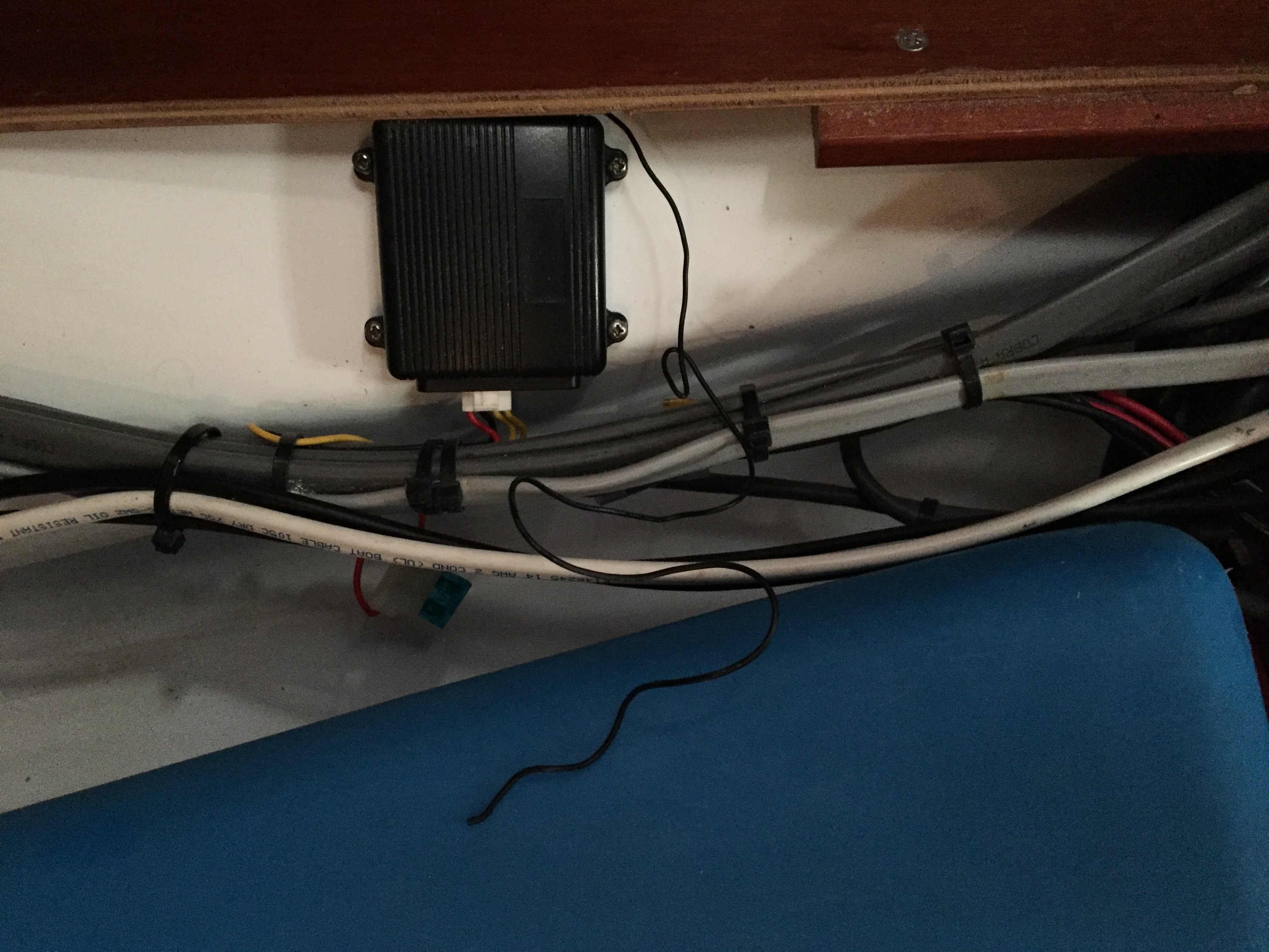

At floor level next to galley and chart table, I have small yellow lights. Cant figure where the switch is.... P/O said they are remote activated, however he said he never used them and that there may also be a transom light as well. He said there is a small remote, however the devise does not appear to work. I have not tried to trace wires yet but just wondered if this was a Beneteau install or the original owners..... Thanks!

A feature across the Beneteau line. The courtesy lights are only operated with a key fob. Do an internet search for Aqua Signal Remote Transmitter. The topic has also been discussed in this forum too. Also check the battery in your fob. Do another search for where the receiver is located on your boat. On my boats, the receivers have been located in the compartment behind the main battery switches.

And there it is...... behind battery switches. Had asked about this before and was told some type of remote. Thanks
