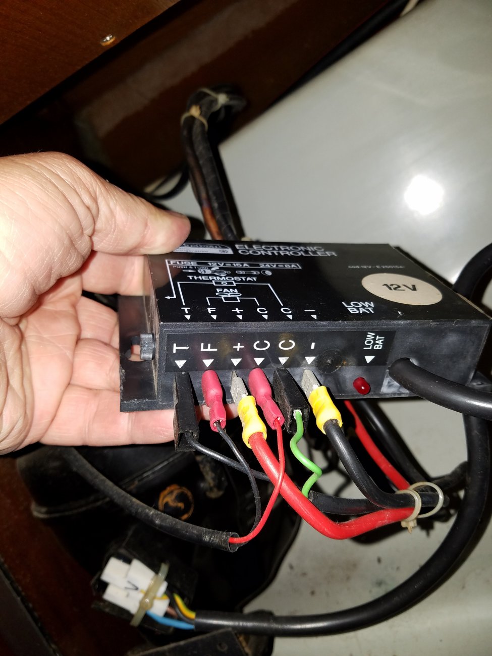

Greetings, me fridge pump has stopped working. Manual says there is a fuse but not where it is. I cannot find. Any suggestions?

What year boat, I've had two fridges on two different boats stop working ('87 Ericson and '93 Beneteau). Both times it was the control module. The module does have a fuse but it's probably the module. I forget if it's a 3 pin or 4 pin I think it's a 3 pin ont he late 80's early 90's units. Remove the plug that connects the module and count the pins. A new module can be bought for about 200 bucks, you may find one used on ebay for less but I'd buy new. Below is a pic of the bad one I removed.

Thnx for the reply. Our Oceanis 423 is a 2004. I’ll need to do some more digging...haven’t found a fuse or module yet. The boat is new to me so I’m in my learning curve.

Judging by the replies, your problem with the refrigerator compressor; not the refrigerator drain pump...correct? Also, this differs if you have the 2 cabin or 3 cabin model. On the 2 cabin model, if the problem really is the drain pump, it is wired into the same circuit as the shower sump pumps and activated by a small pushbutton between the stove and the sink. Make sure the shower sump pump circuit (see the 12 volt panel) is on.
A great source of information on the 423 can be found at https://groups.yahoo.com/neo/groups/beneteau423/info

Bob is the master. 100% correct. Thnx Bob! I’ll give myself points for asking a good question. Hope I can add to the forum going forward.
