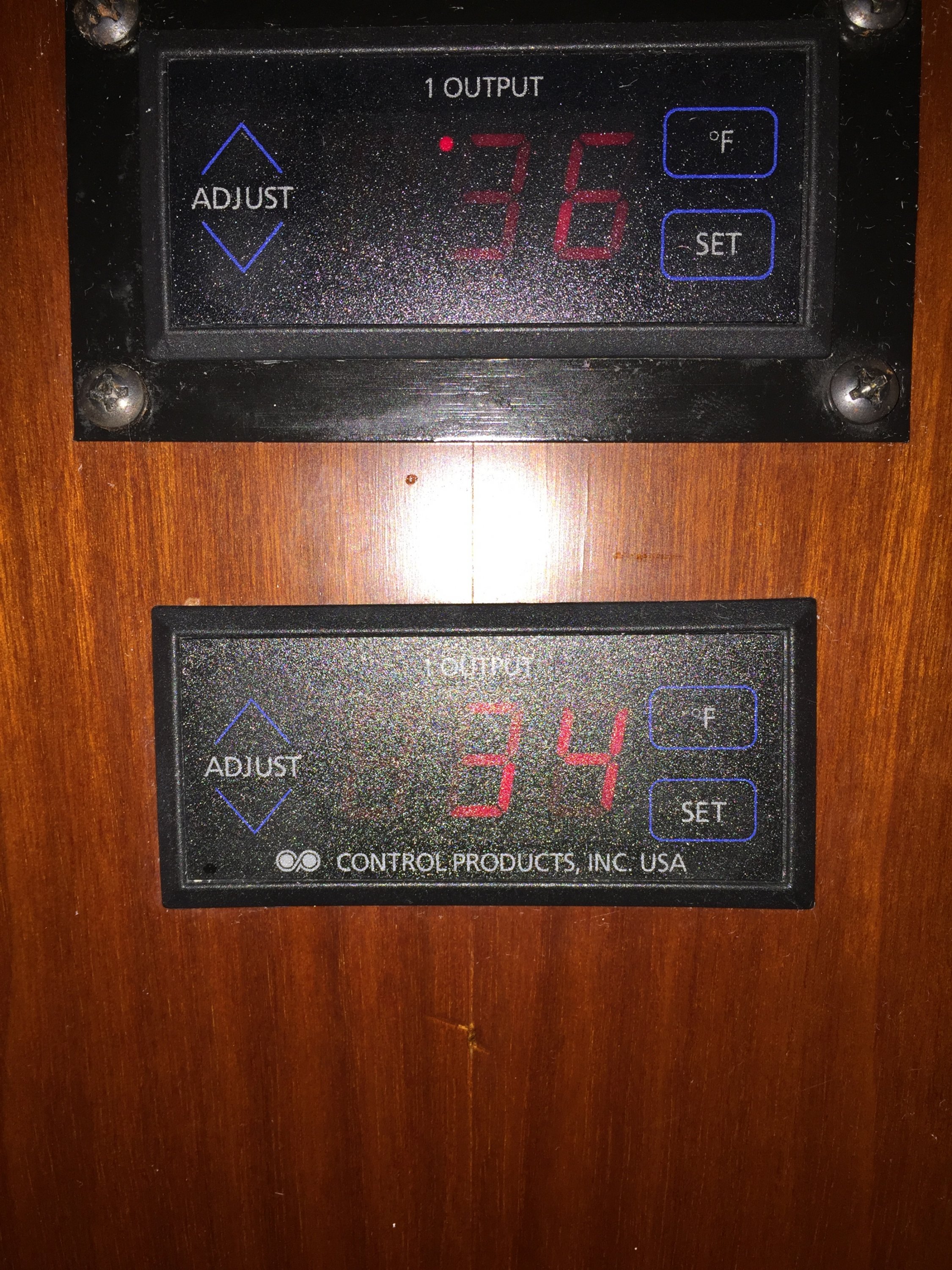

NYSail
Jan 6, 2006
3,148
Beneteau 423 Mt. Sinai, NY
I have been watching my monitor and those numbers seem right on..::: damn you guys are smart. My refrig also has a temp control unit added.... not sure if I like it or not as I have to reprogram if I want to change temps rather than just spin a dial. Would like to temp display only.....
