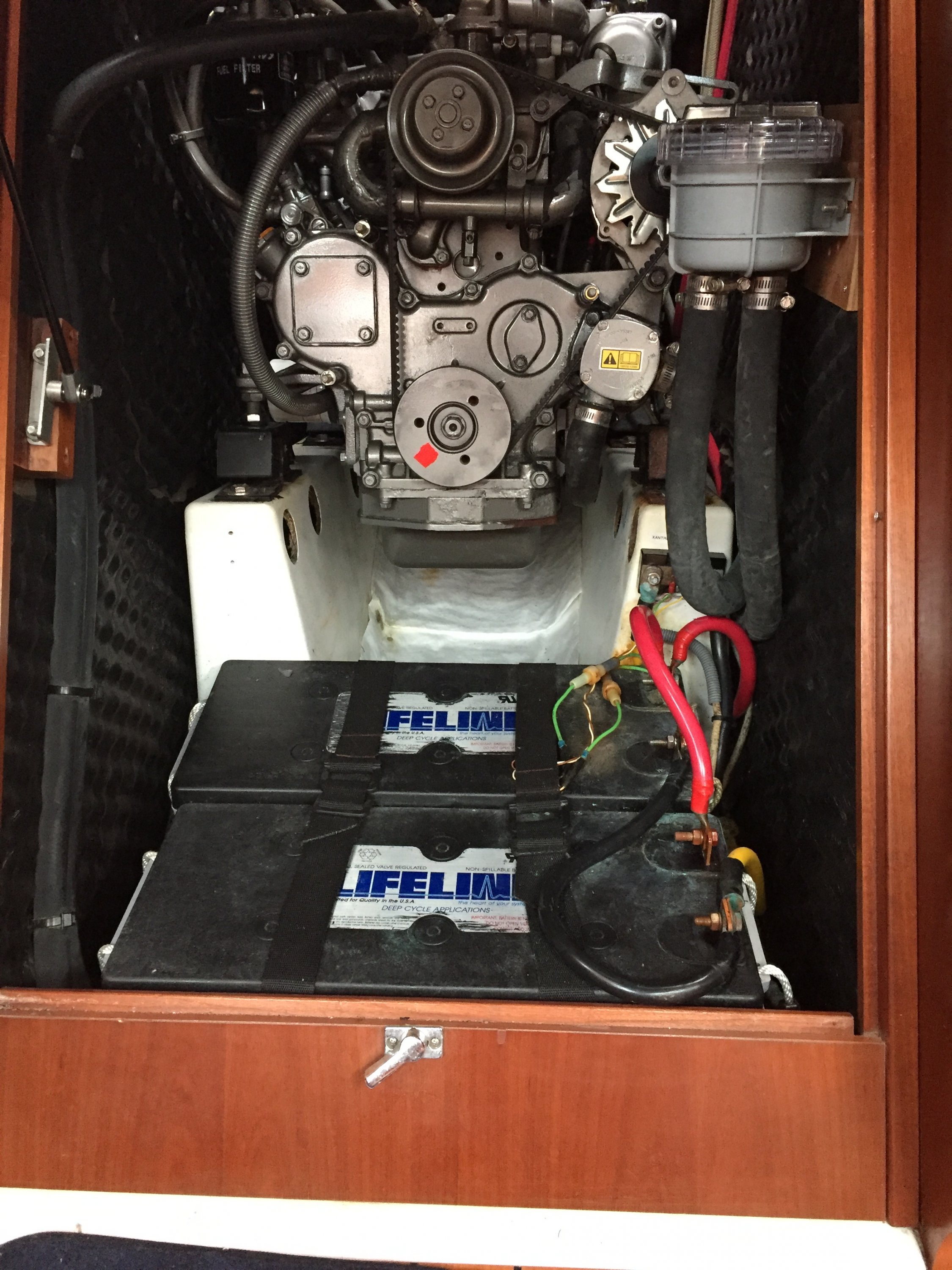

-House batteries are located in the front of engine compartment. 20" wide, 15"+/- hieght rear, 9" height front.

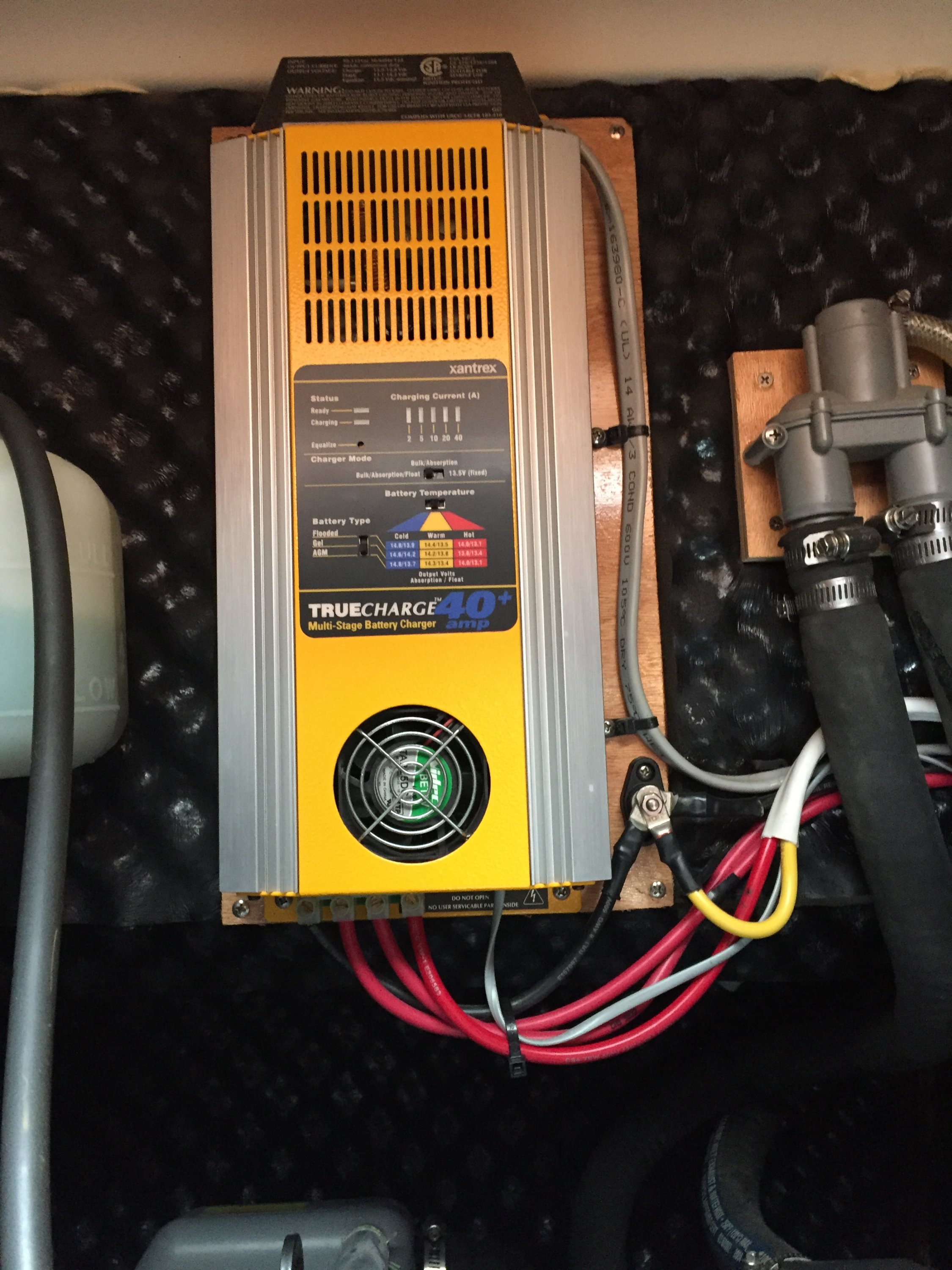

-charger is truecharge 40+

MaineSail will get you tuned in. If you keep your batteries in the engine-bay I would stay with AGM, FLA batteries vent corrosive gas and that area is filled with wiring, electrical devices and all those connections on the bulkhead above your engine.

I agree with your thought on the agm verses flooded in there. There is a blower and exhaust fan in there to keep things cool while running....

Must say I do hate the location of the house bank..... I am looking for an alternative, or to modify this area to protect from excessive heat; enclose/circulate fresh air which is possible based on existing ventilation and room.

MasterVolt 100/12-3 smart charger with temp compensation.

Your charging system & battery location does not really warrant or justify spending money on AGM batteries.
Get them out of the engine bay, charge them at bare minimum of 85A, using a temp compensated charger and we can then discuss AGM's.
Your TC40 should be able to equalize your Lifelines. They need about 4+ hours temp compensated at 15.5V after being charged to 100% SOC first. See if this helps. What settings are you using on the TC40+??

Thanks! Yes I think I have found a home for the batteries away from the heat in an aft lazarette. Going to do some measuring this weekend to see. The charger is set for agms / warm / bulk absorb float. I read in the manual after you Last mentioned equalizing them that the charger won't equalize agm's.... should a setting be changed to allow it to equalize? I do plan on getting a new alt.... I miss my 70 amp balmar and external regulator that I had on my old boat.... really would charge tha batteries and want to get a set-up to take care of what I now have.....
