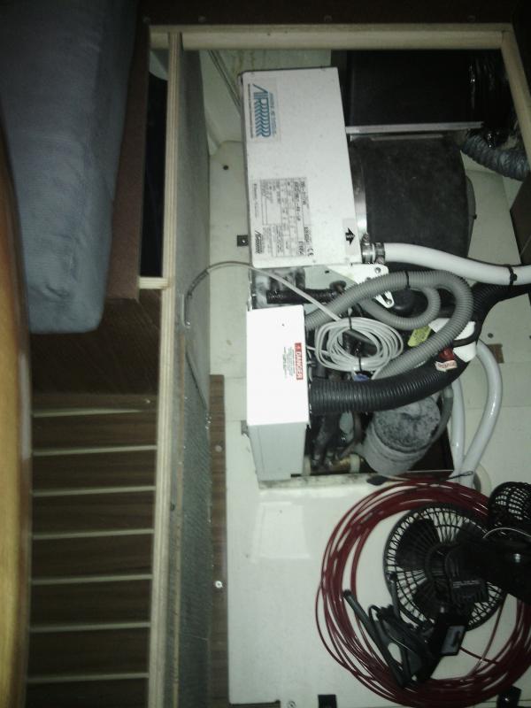

Has anyone experienced a similar problem in their 41DS? Yesterday was around 95 degrees at my dock. I was working inside so cranked down the a/c to 73 degrees. After a few hours I noticed no airflow coming out of the vents. I thought the circulating fan was not working. I opened up the settee to look at the a/c unit and the coil was completely frosted over, stopping any airflow. I turned off the unit and an hour later it defrosted and worked correctly.
I think the problem is due to the placement of the a/c unit and the vent cut into the side of the settee. The vent is not in line with the a/c unit. I was planning to cut a new vent in the port settee. Has anyone solved this problem?
