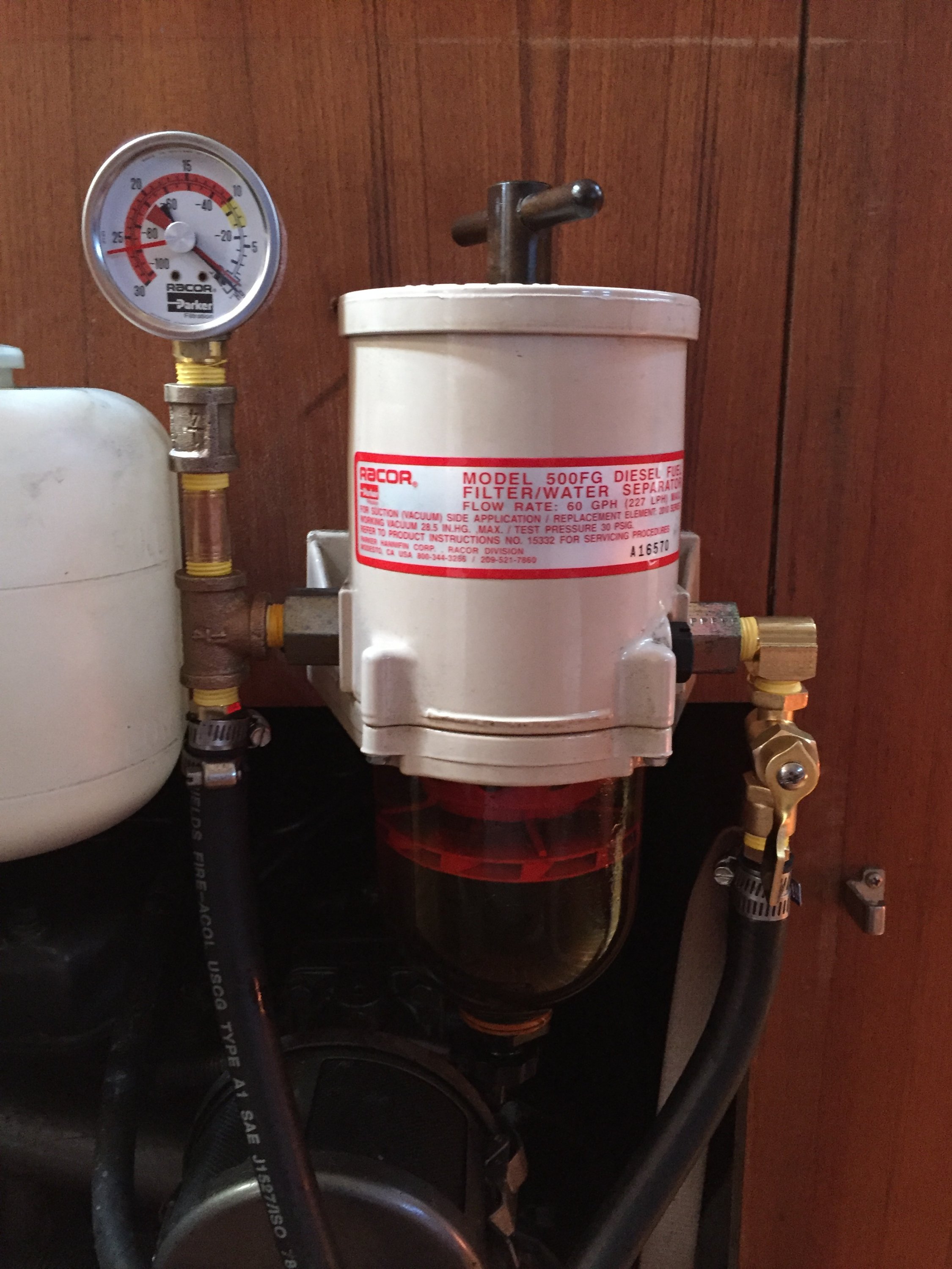

23,404
Scott. If you are going at it why not make the Racor tell you when the filter needs to be changed rather than make you guess. Install a Vacuum Gauge on the outlet side of the filter. If the vacuum level goes up your filter is clogged. (cost less than $25)
Cleaning a pickup tube is relatively easy. Remove fuel line from the tube on top of the tank. Unscrew the tube from the tank. and clean or attach a small hand pump to the tube top and blow air into the tank through the tube.
In my case I just closed the tank with the pickup tube clog and the fuel falling back into the tank cleared the tank tube. Then I opened the valve and surprise the fuel flowed.

23,404
Here is a picture of the Racor setup.

John I have been saying I was going to do that for years. You're right now is the time. Where did you get the gauge?
23,404
I used a Wholesale Industrial & Hydraulic Hoses retailer. They sell fittings to diesel repair service shops. They sold me the tee fitting, the gauge, and the fitting to my fuel line.
After I fitted the system for my boat, I found the same function but at a lower cost for my friends boat. West Marine had the male 3/4 adapter for the Racor filter with a female 1/4 in npt side. The we bought the tee with 1/4 male to the WM adapter, a female 1/4 for the gauge, and a female 1/4 npt end for the 1/4 male npt fitting to connect the fuel line.
I used a soft sealing pipe thread sealant on the threaded ends to help seal the connections. For my friend the costs were less than $30.00. Gauge and tee fitting. Get the gauge that has fluid in the gauge. It will dampen the needle movement so you can read the gauge.
Hope this helps.

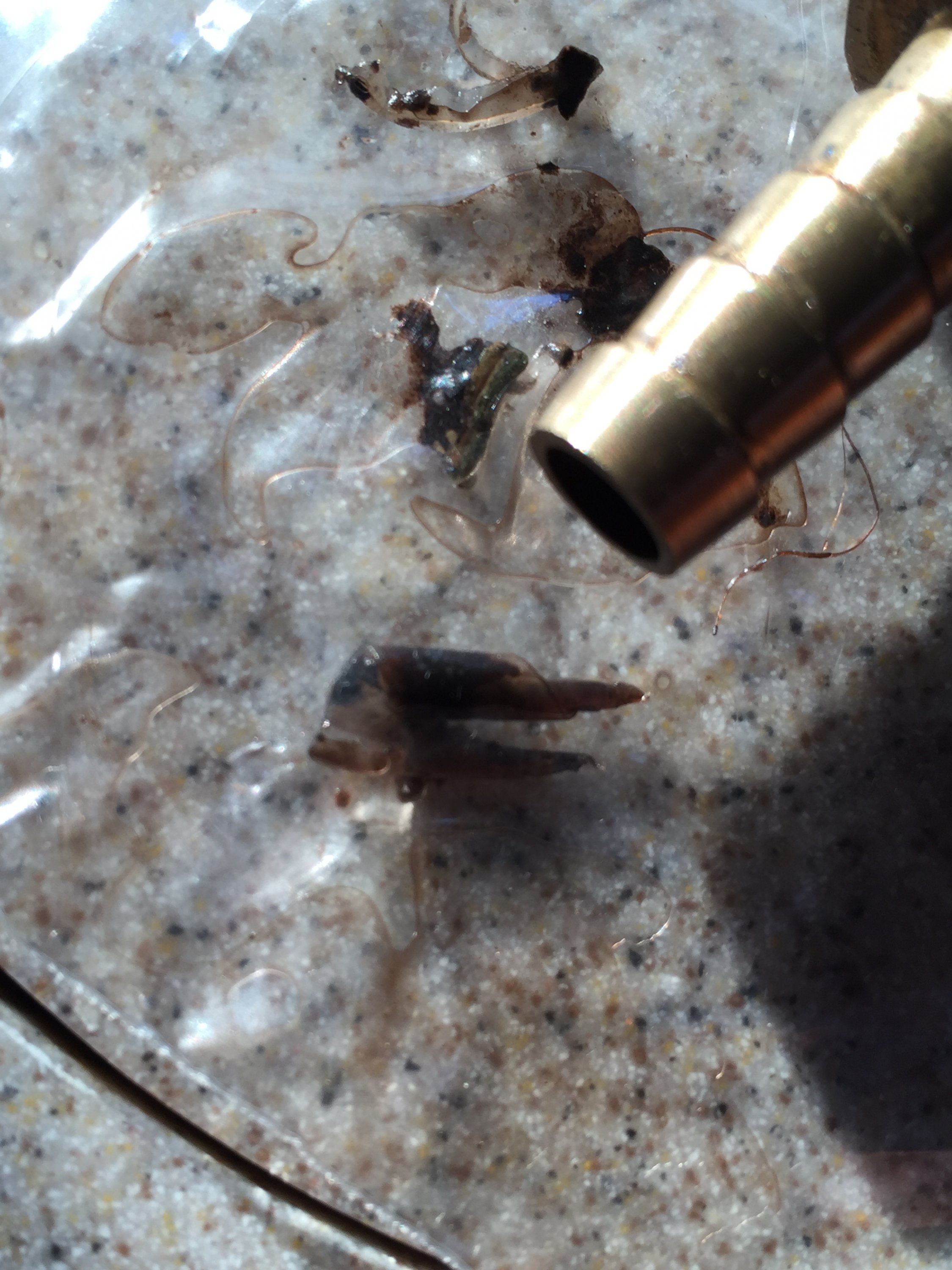

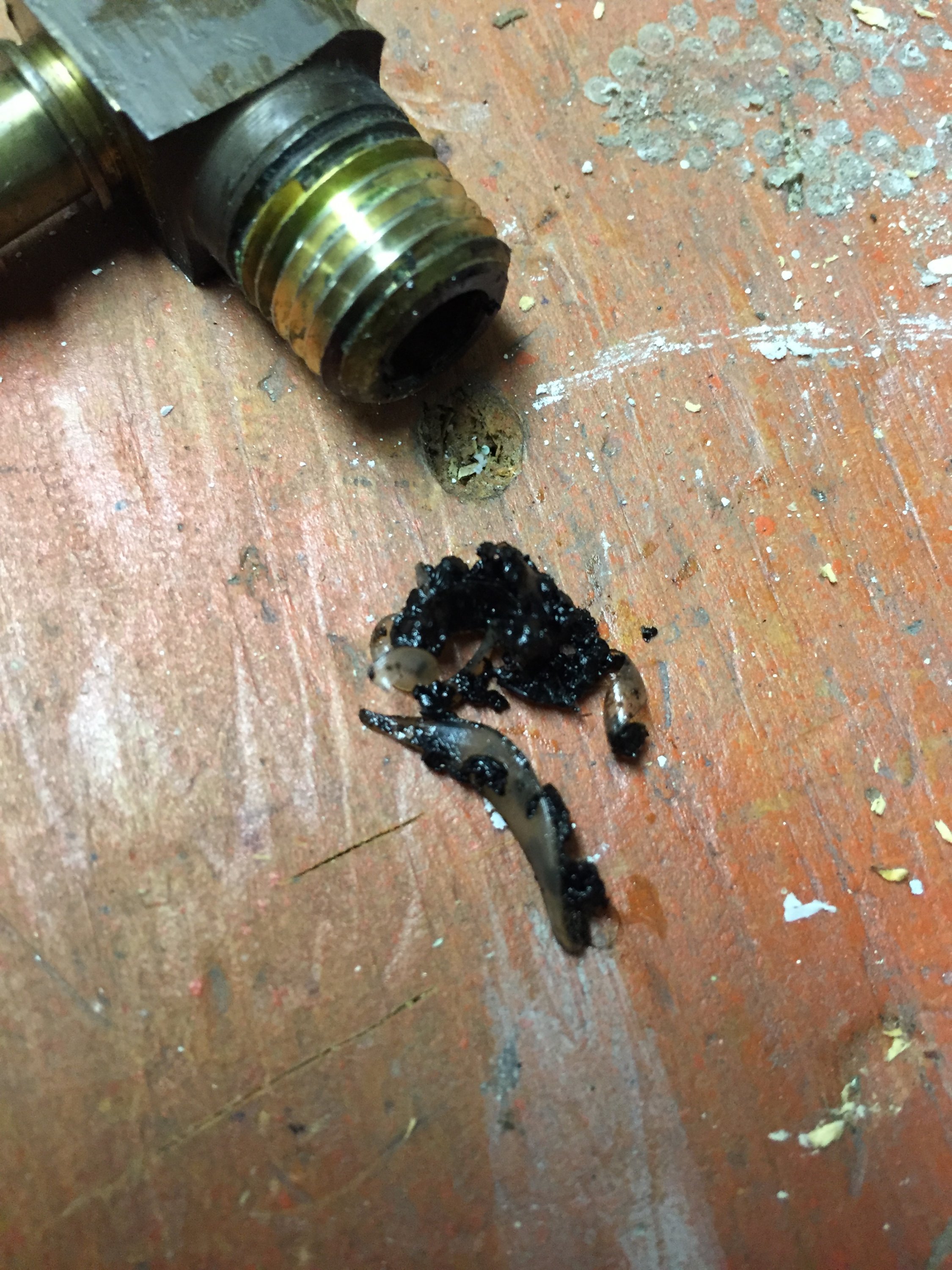

UPDATE: Took the pick up tube out of the tank tonight. Found plastic like debris between the aluminum tank withdrawal fitting and the fuel shut off valve. That along with other small pieces of debris were unable to move forward in te line nor drop back into the tank. Crunched the fitting getting it out so I need a new fitting but I think that will solve my issue... Fingers crossed.

When I took the fuel line off of the tank side of the racor no fuel came out. I had drained a little fuel out so I was puzzled but not overly so. When I got the fitting off it looked like it was plugged. I tried to blow through it, I could barely get air to pass through it. I dug out the blockage and found more plastic from what I believe is original assembly along with the normal diesel crap. This explains why in the 14 years I've owned the boat the racor has never been dirty. It has been filtering in the fuel line. I reassembled with all of the new fittings and it so far runs fine. I believe the problem is solved. I now will be able to tell if there is a similar issue thanks to the gauge. Now I need to go move the coolant overflow tank over 1/2 an inch...

Plastic shavings from the install of the tank fittings is my thought. Then it's got the normal diesel slime on it.

I really think they are from the original fit up. They've just accumulated over the last 18 years. I've owned the boat for 15 and there have never been repairs related to the tank that I recall. Thanks to you though I finally took the time to install the gauge and valve. It will be a better diag experience if it happens again! Thanks!
