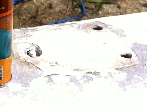

Just started to work on my mast last weekend.
Being a 78 the spreaders were wood and rotten. Mast looked great until I removed the spreader bases as I will be installing new with aluminum spreader.
I appears there is a significant amount of corrosion there where the 3 spreader bracket bolts when through the mast.
Is it enough to make me worry a bit, yes. Being on the flats I tend to think the mast is ok, but that could be wishful thinking on my part.
Attached is the best picture I have.
