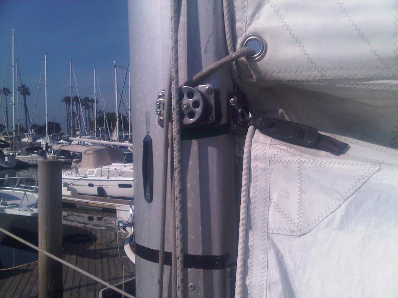

We use two line reefing and get perfect sail shape. To not add any extra lines, we don't use the first reefing point and go directly to the 2nd one if it's windy enough to reef.
We found that you need to have the forward reefing line, go thru a block mounnted on the mast at about a 45 degree angle, so it's pulling forward and down. Otherwise, it puts too much tension on the sail slugs, which can break.
Our 2 line system takes us all of 5 minutes or less to reef, all without leaving the cockpit.

Here is a link to a modification that I made to my single-line reefing system. I kept the single line for both reef points, but I added a block to each leach reef point. It greatly reduced the friction in the system and I was able to tension the leach correctly.
http://hunter.sailboatowners.com/in...d=7571&page=article&mn=General Boat Ownership
For some reason the last picture of the first reef when set is missing, so I have added it below.
