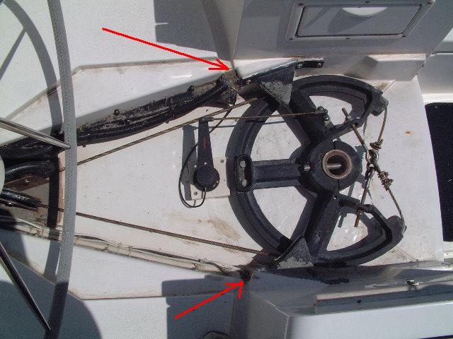

I simply drilled a couple holes and.....
after running my new wires I sealed around the wires with a caulk. I probably used either LifeCaulk or a silicone caulk. I've never had a leak issue.
I didn't try to use the existing wire loom because I thought it was too full already.
See the picture below for location of the holes I drilled (red arrows). They were about 1/2" or 3/4" in size. The wires come out in the area under the cockpit floor and above the rudder area that is accessible behind the cover at the back of the aft cabin. From there you can run the wires to either stern lazarette, helm console, or to the electrical panel.

Re: I simply drilled a couple holes and.....
Thanks Rich, that will give me another option!
