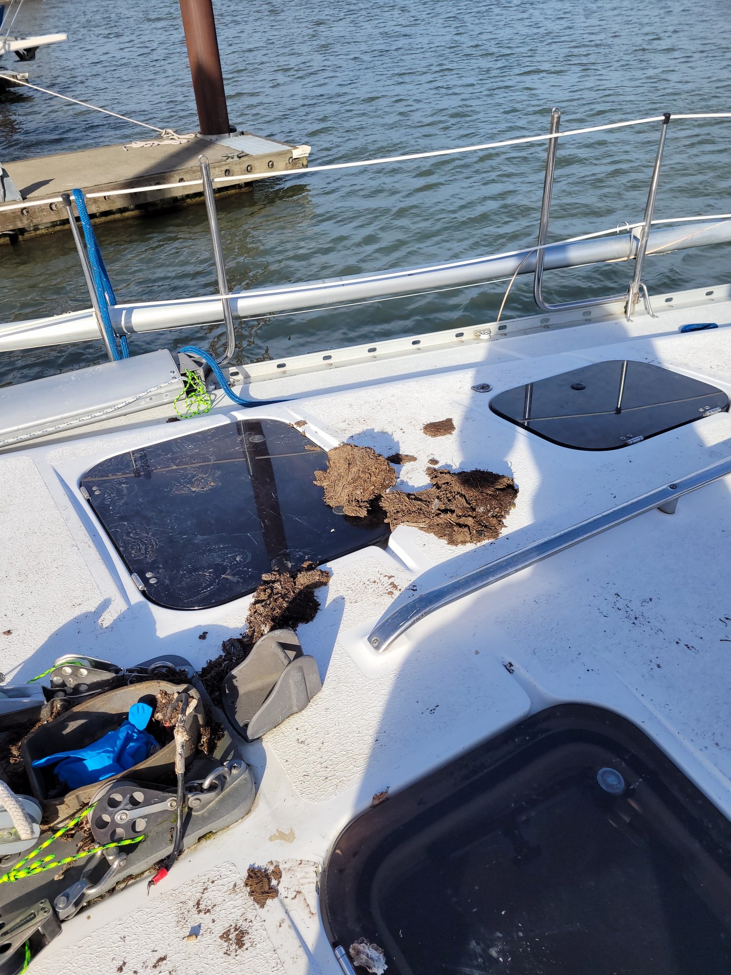

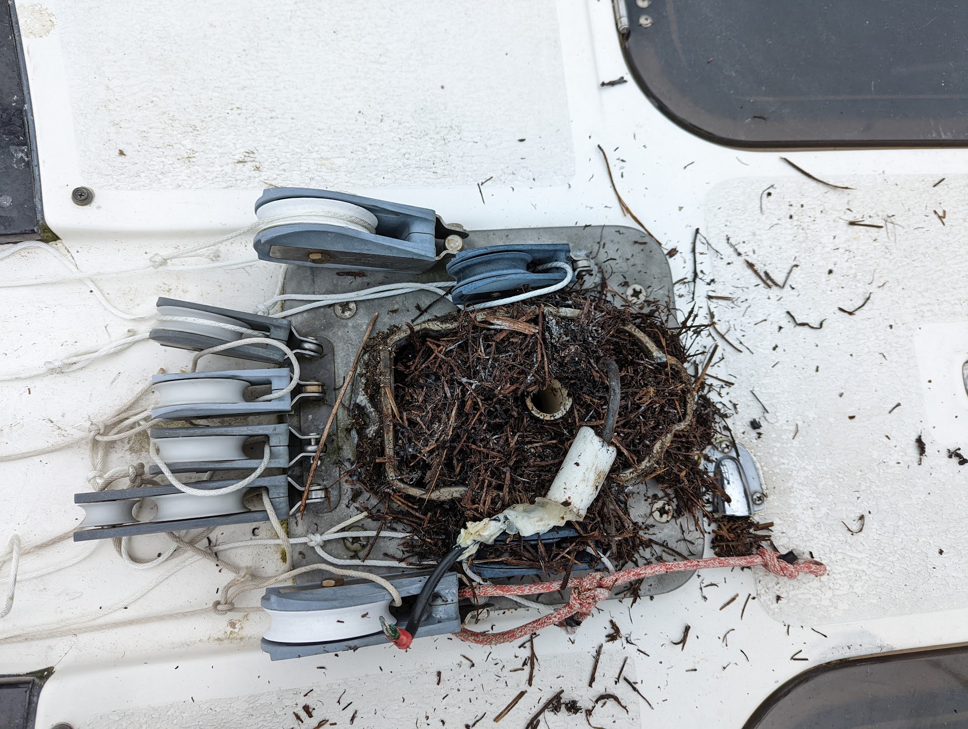

We've been having a leak at the deck step with water coming in occasionally. When we unstepped the mast this is what we found. That'll clog things up for sure!
The guys at the yard said they'd never found mulch in a mast before. Anyone else seen that?

Never have seen mulch... Perhaps it was something else and dissolved into mulch. Like a birds nest...

Looks like grass and needles... Guess you had an industrious bird trying to make a home.

I like the birds nest theory too. Just not sure where they were trying to build that led to the remnants falling to the bottom of the mast. I’ve had birds build nests in the boom, but a purely vertical mast is a little different.

The Z-Spar mast that was original equipment on the 40.5 has a rectangular hole with rounded edges on the front side of the mast somewhere near the second spreaders. It is used for the attachment point for a baby stay. And it is the perfect size for a bird to stuff in nesting debrix. Placing some silver tape over that hole should stop the nesting activity.
When I pulled my mast after 15 years, I found a dead bird at the base. Apparently it entered the hole and could not fly out.
